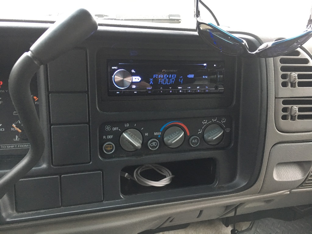

Was a pretty simple install except for busting every tab and mounting piece off the gdmf ac/heat control panel cause I thought it needed to come out!?!?!?! I ended up using stainless screws and brackets to get it to sit right. This Pioneer has bluetooth and iPhone control. Used a Sosche dash kit and a harness connector along with a storage cubby as well. Sonic Electronix was great and everything arrived within a couple days.
Old setup
New setup with the storage box replacing the cd player
I also installed the Fosgate 6.5" speakers on the from doors. The second set of speakers I bought for the rear doors were actually 6.75"... DOH... So I will eventually swap the 6.5" for the rear doors to fit the panels and speaker covers and install the 6.75s in the front doors... That was the most frustrating part after the ac/heat control fiasco...
At least now I have good (better) sound and bluetooth which is huge for me as I drive a lot for work.
