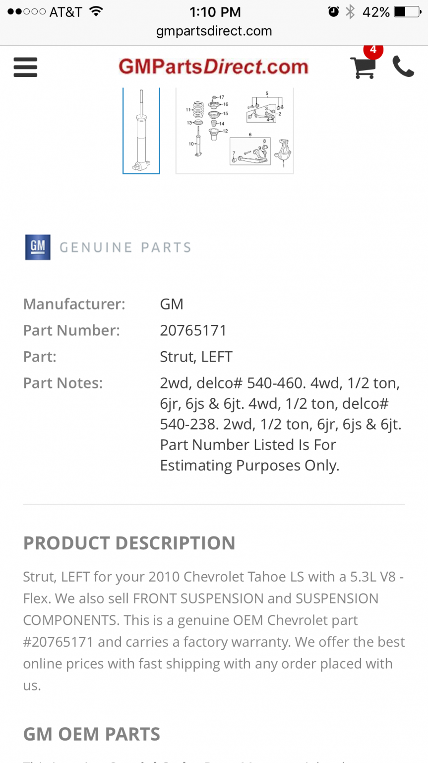

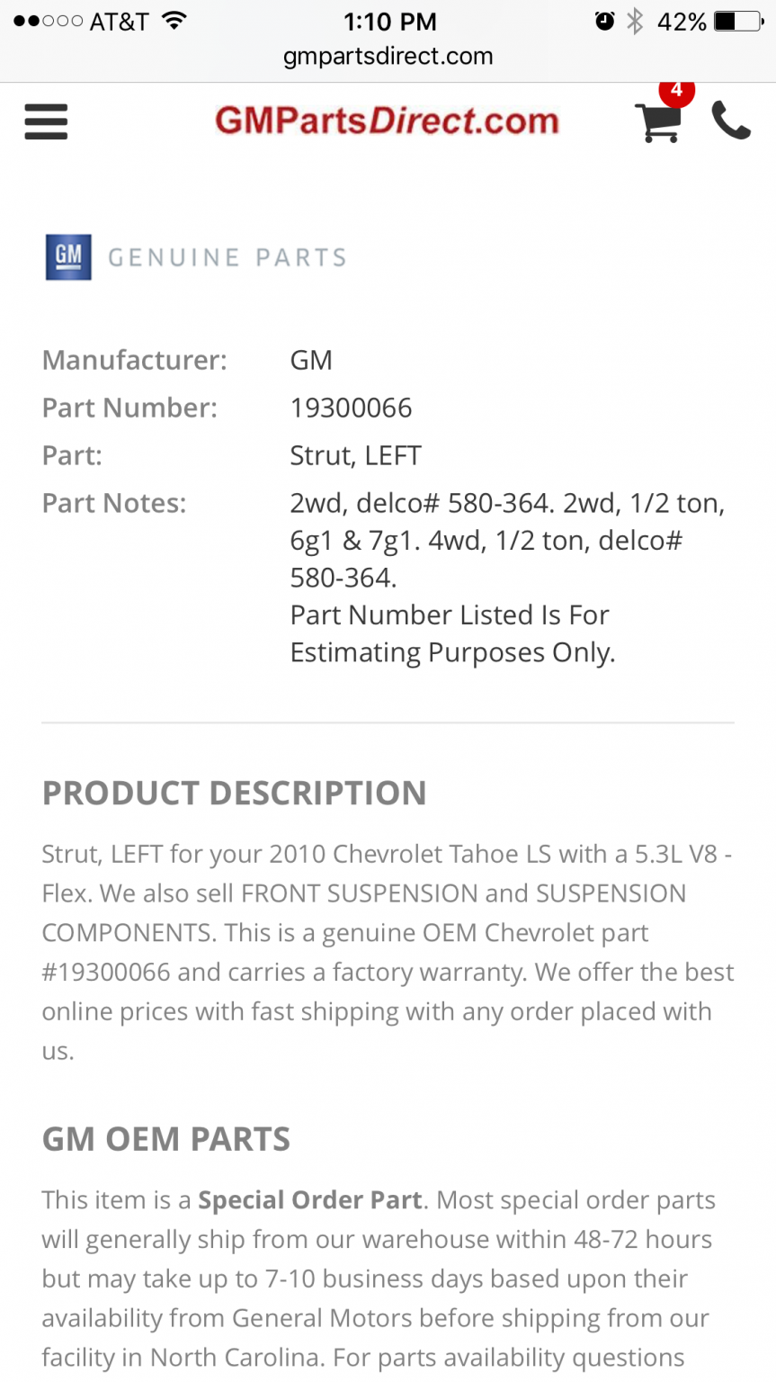

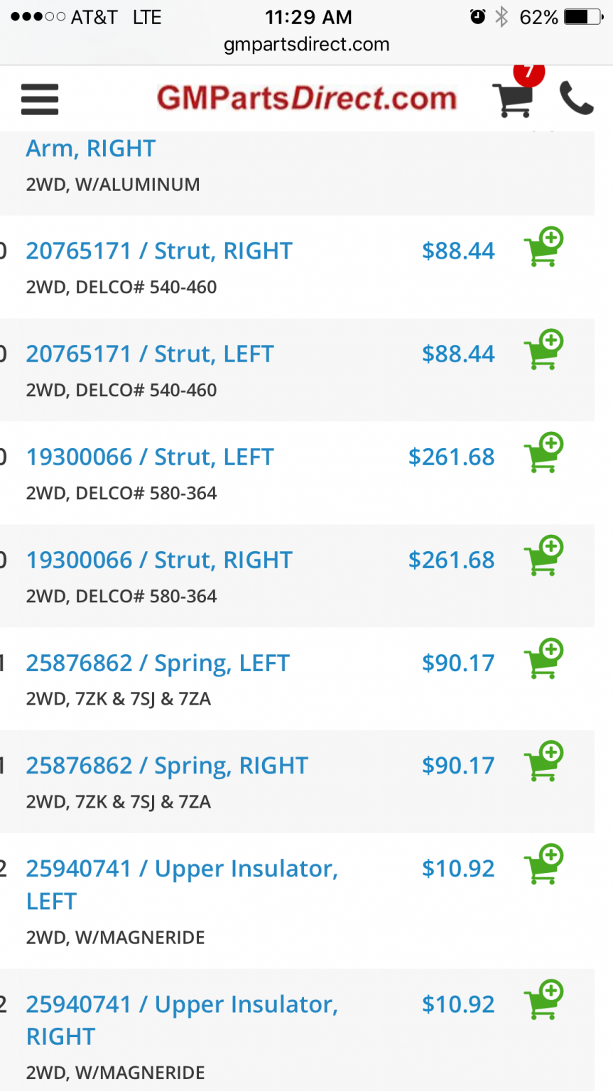

Confused..
20765171 / Strut, RIGHT
2WD, DELCO# 540-460
$88.44 20765171 / Strut, LEFT
2WD, DELCO# 540-460
$88.44 19300066 / Strut, LEFT
2WD, DELCO# 580-364
$261.68 19300066 / Strut, RIGHT
2WD, DELCO# 580-364

I believe the DELCO# 540-460 is for non-autoride tahoes (which ppv's are I believe). Autoride was only found in LTZ's. Dont quote me, but it makes sense as to why the other struts are so expensive.
