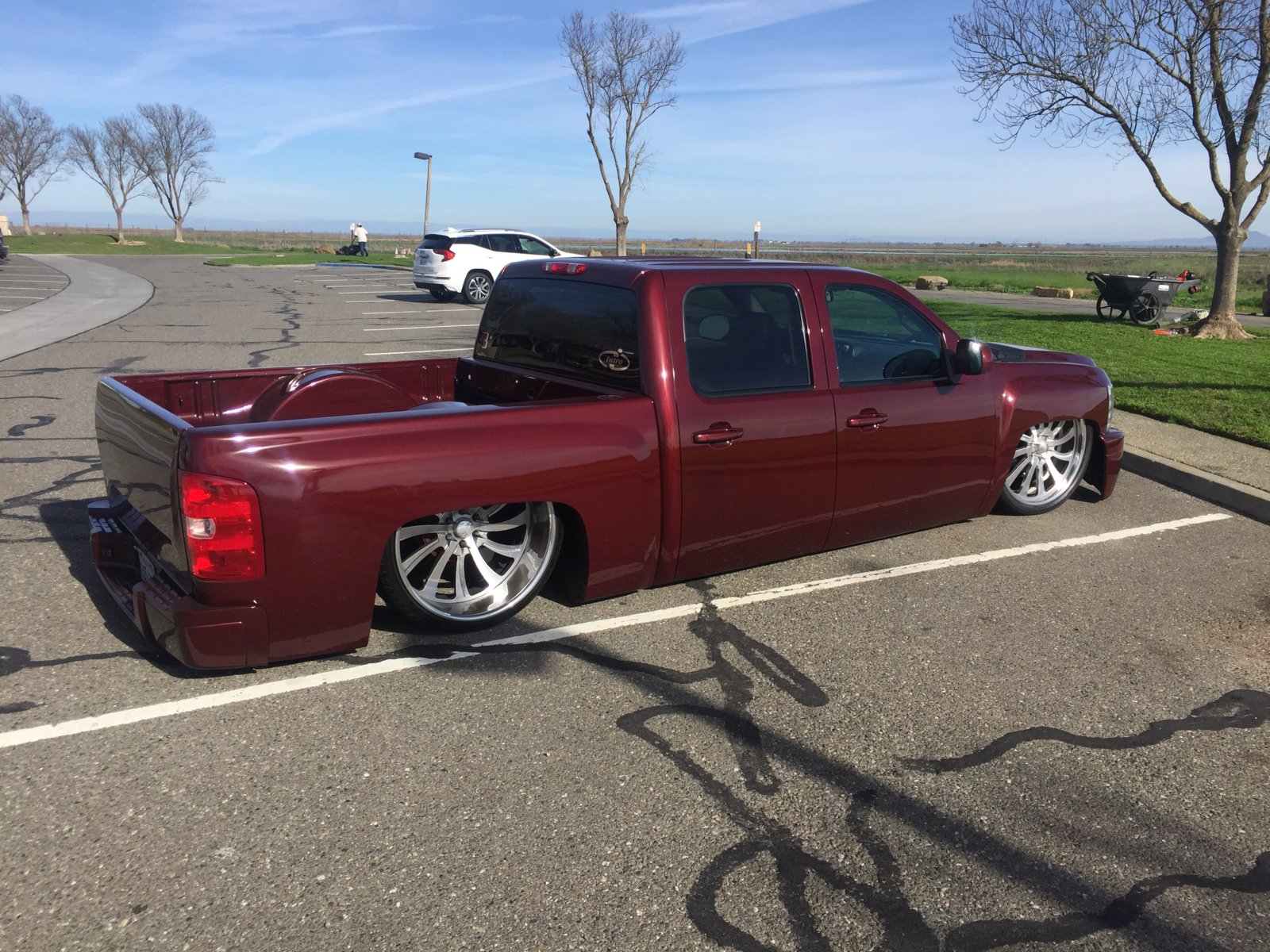

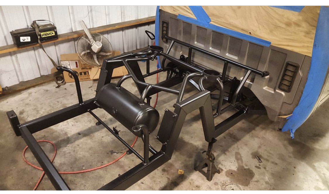

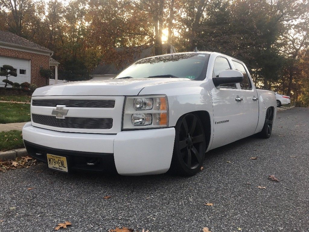

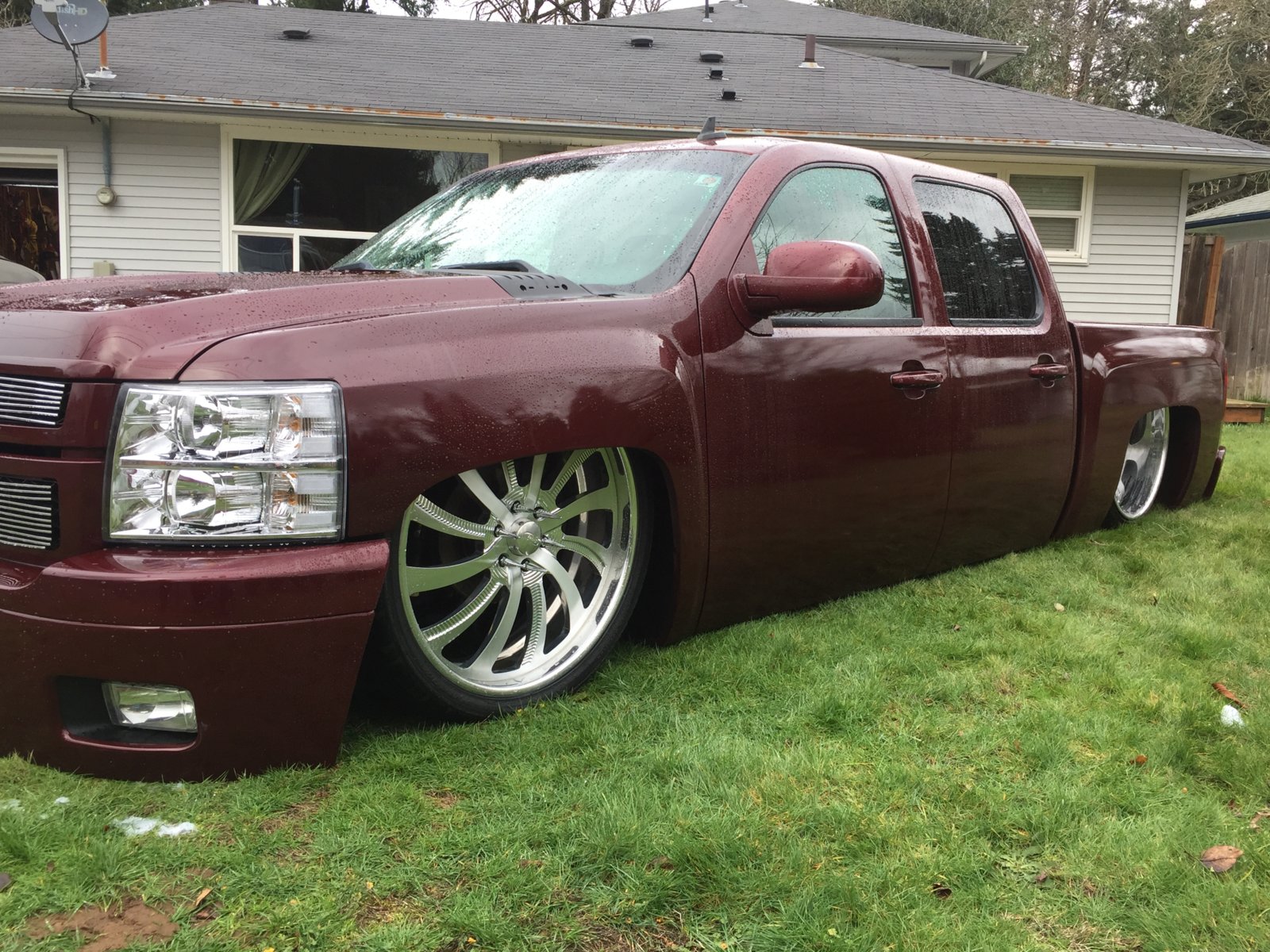

Well folks I quit talking about getting a bagged NNBS CC Silverado and bought one. I searched for a few months and almost bought one in NJ sight unseen through Ebay but that fell through after I couldn't get anyone to haul it. I had it listed on U-Ship for over 3 weeks and finally someone said they'd haul it but never picked it up. I think it was a good thing- it wasn't all that great of a truck IMO but it was cheap and had potential. I included a pic of it. Then 2 weeks ago was using www.searchtempest.com which scours all the Craigslist ads and found one that was more what I was looking for and close enough that I could go look at it in person and possibly drive it home. It was way more money but was tubbed for 28's, bodied as well (the body has been dropped on the frame so it lays out on it's rockers instead of just laying frame) and the work was done by a well-known shop, All Star Customs out of Texas. The guy said he waited a year on the waiting list and then shipped it to them and they took almost a year to finish the truck. The frame and suspension work is top-notch. All Star is known for their bagged builds. Here's the white one I almost bought, and then a picture of the one I bought at a Cali rest stop on my way home yesterday. I drove for 6 hours and then spent a night in a motel and drove another 5 this morning. There's a few more shots after I got it home and washed.2.jpg IMG_7469.JPG IMG_7474.JPG IMG_7476.JPG IMG_7478.JPG

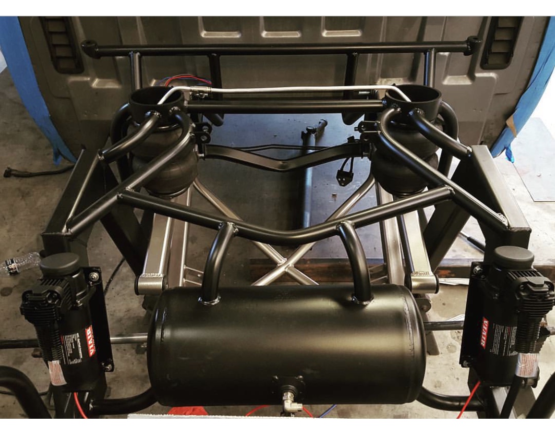

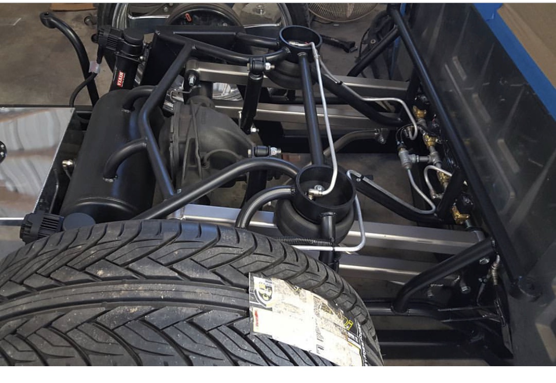

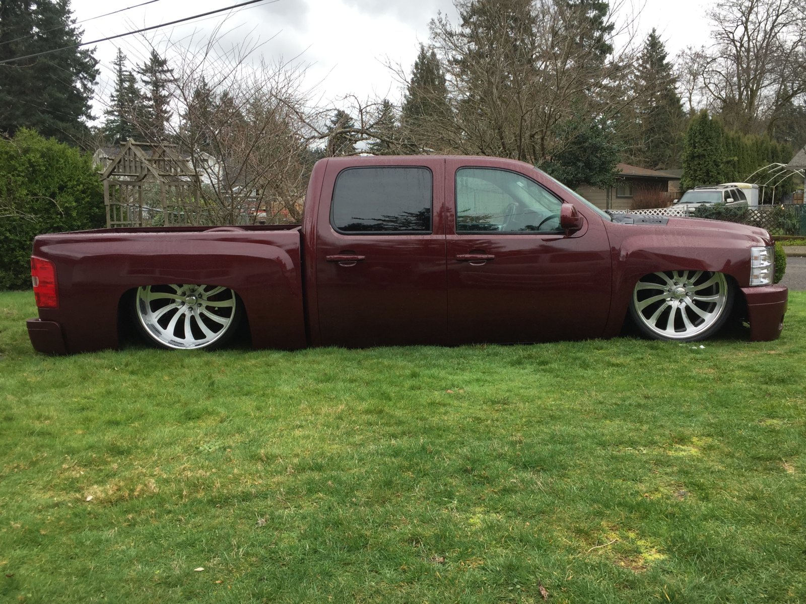

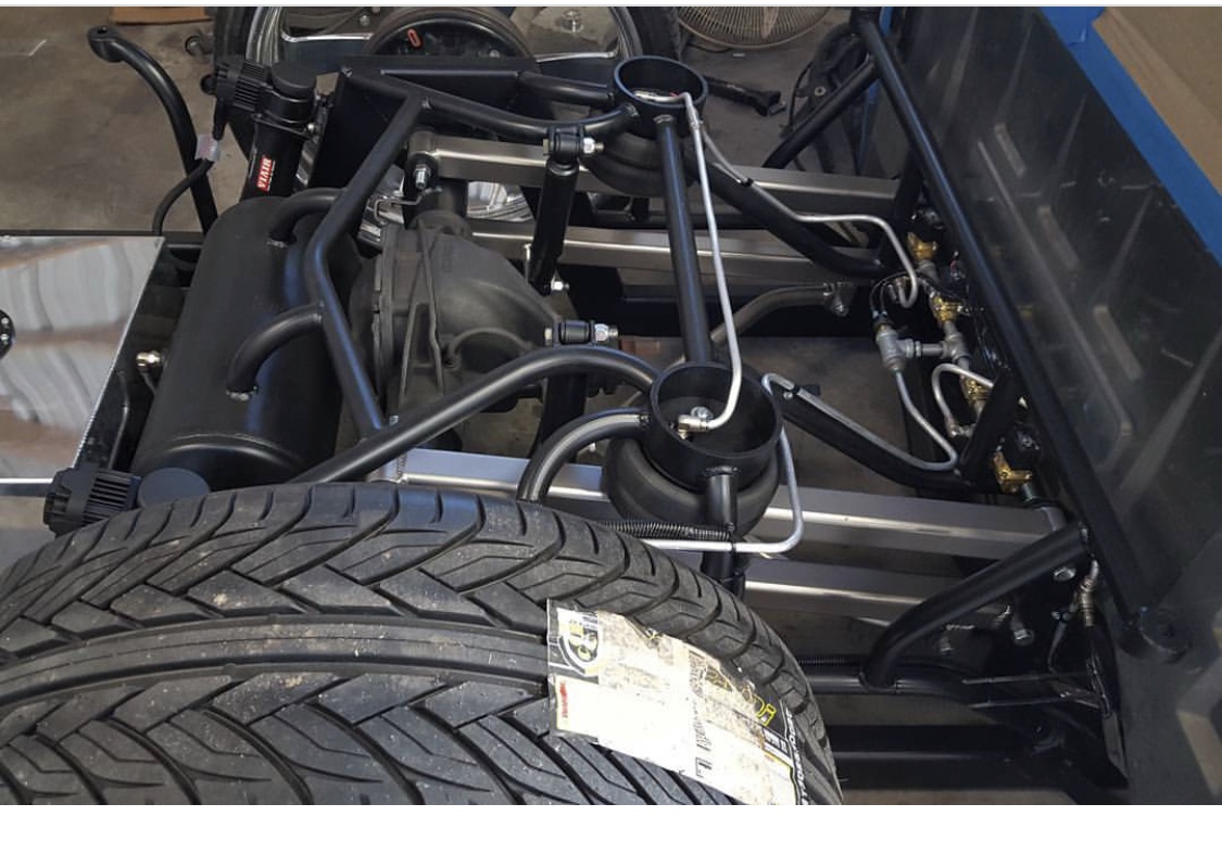

It does have it's issues which I'll get into later but I will say the guy that had it built spent a ton of money on it and I think he ran out before he could finish up the last few details. There's a few electrical issues which I believe are due to the fact it had a butt load of stuff done to it like narrowing the rear end, eliminating the e-brakes, replacing the fuel tank with a cell, etc. in order to make the drop work and some of those things need to be eliminated via a tune. Some things need to just be fixed, like the airbag light which I believe is related to the 2500HD front conversion which he had done elsewhere. Who knows. It will give me something to do. It has a 7-gallon air tank and dual Viair 480 compressors so it's instant-up from being completely aired out. It almost jumps up. It will cruise down the freeway or any straight road at an inch or 2 off the ground. I'm still getting used to it; it's kind of cool adjusting until you're where you want to be but I kept getting worried I might hit a dip and bang the frame on the road. The PO did that in Frisco while he was showing me how low it would drive. I have a video that was shot of it on the freeway about 2" off the ground that I'll post up on YouTube. Here's some of the build pics from All-Star.image3.jpeg image2.jpeg image1.jpeg

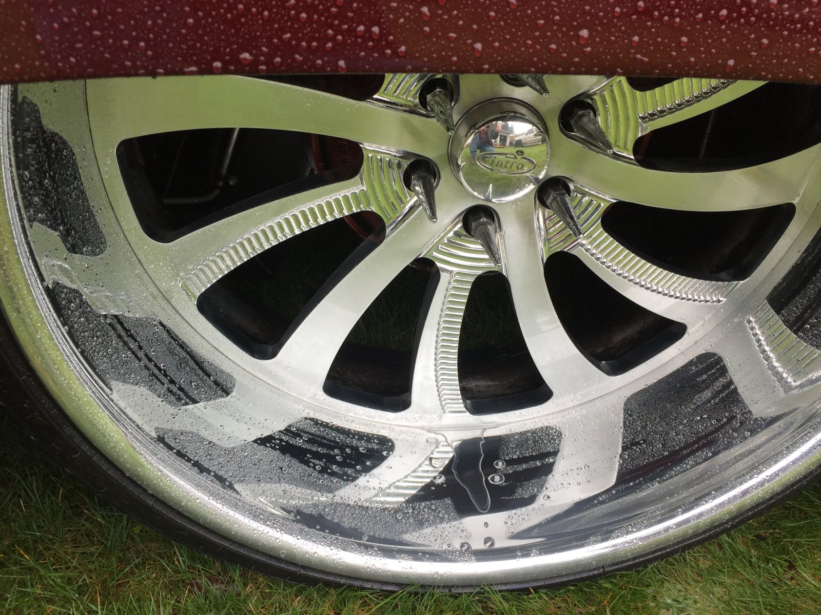

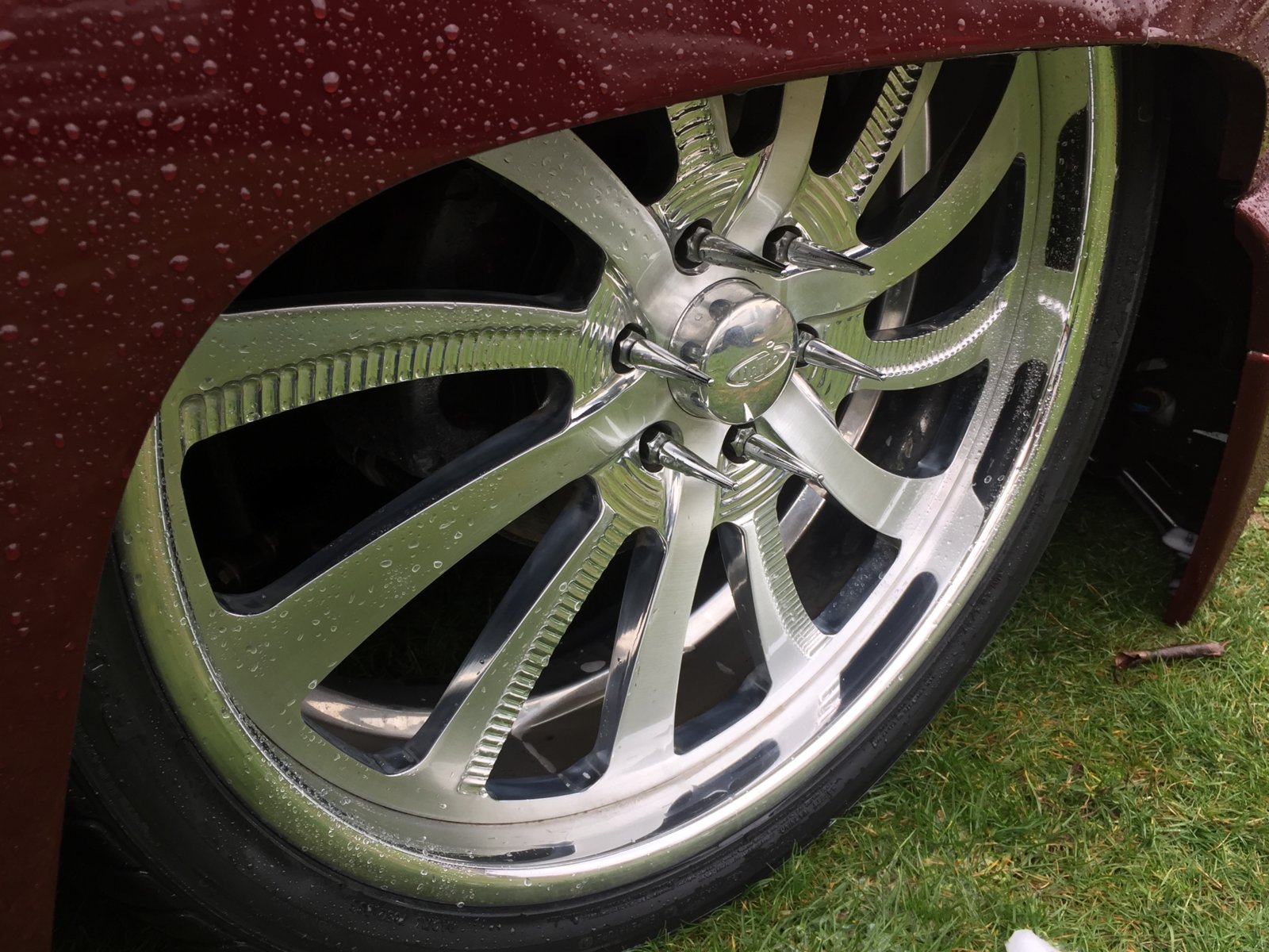

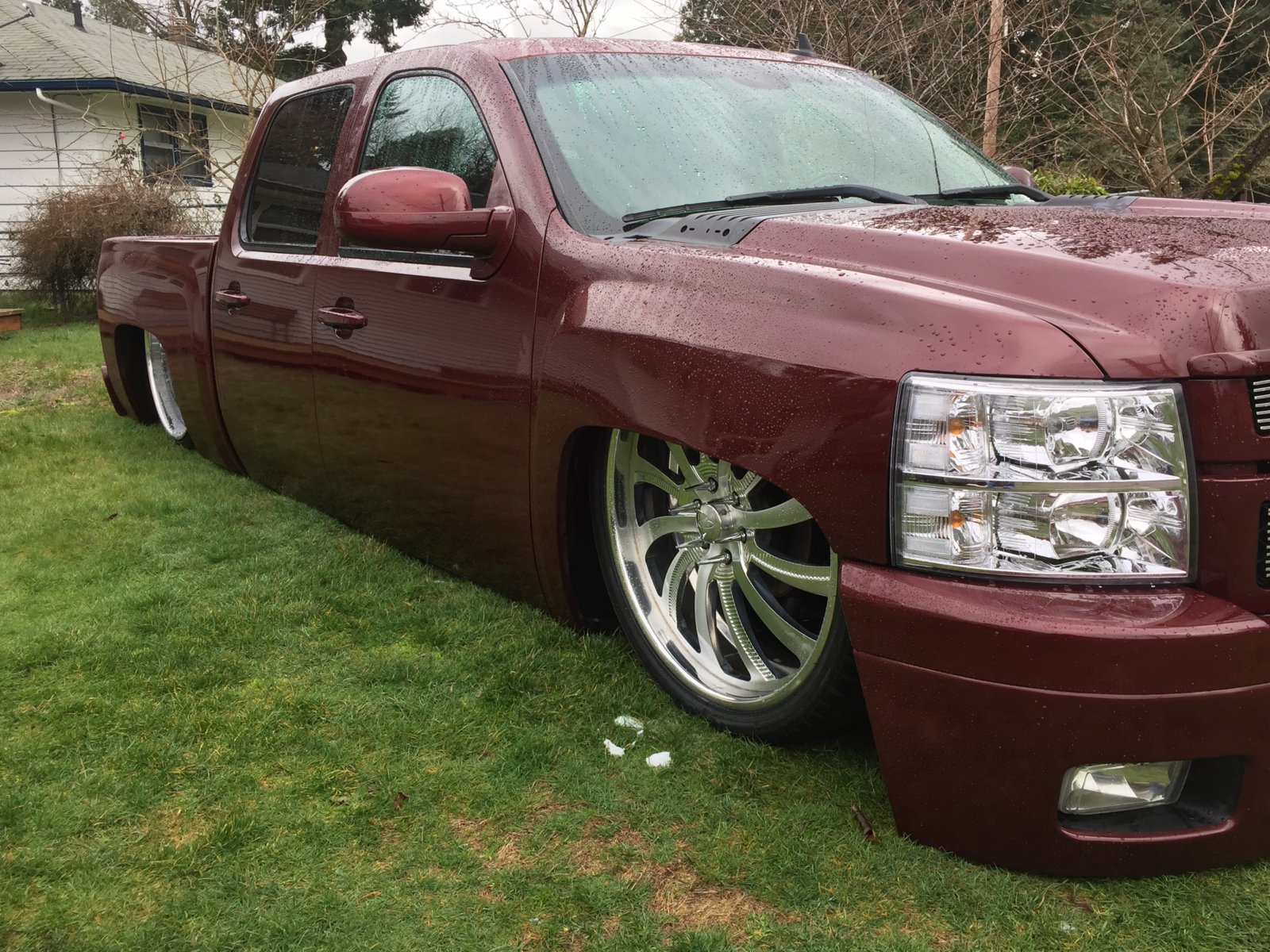

The wheels are 2-piece billets from intro. Fronts are 26 x 9, rears are 26 x 12, machined from a block of pure billet aluminum. I don't like chrome as you all know, but these are badass wheels and technically not chrome, but polished aluminum. They might be a pain in the ass to keep pretty but then again this isn't a DD. At first I wasn't in love with them but they've grown on me. I have not seen another vehicle with them. They're not in intro's catalog but I did find them on their FB page. They're called the Efron.IMG_7481.JPG IMG_7482.JPG IMG_7484.JPG

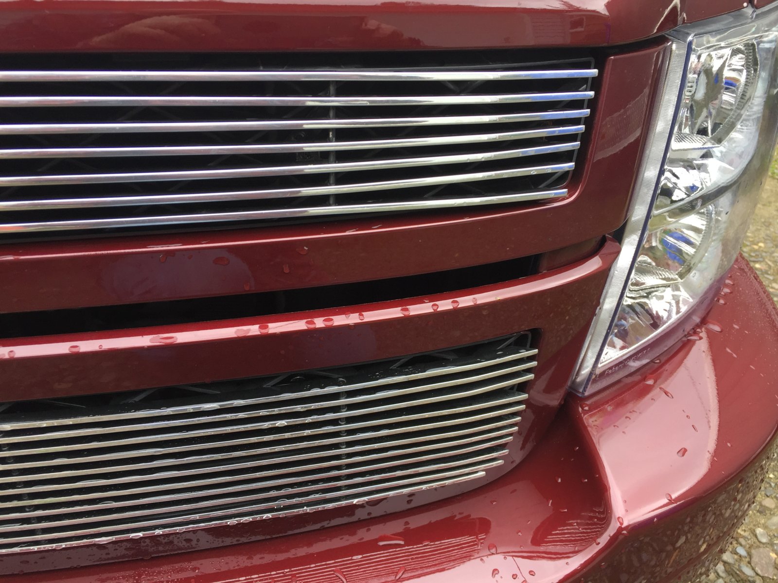

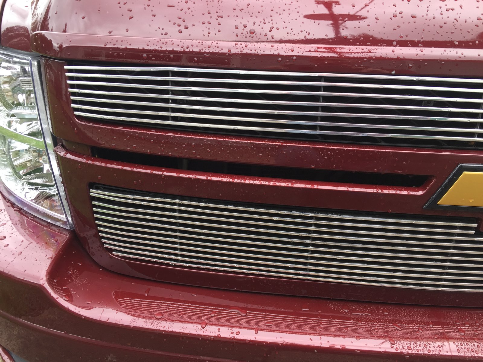

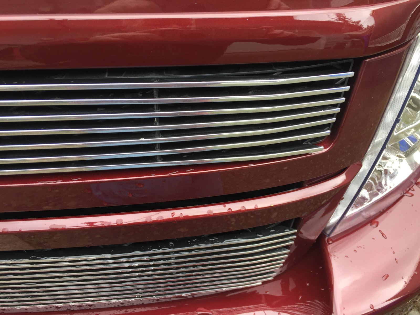

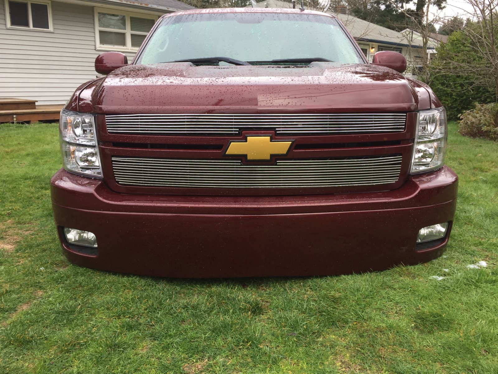

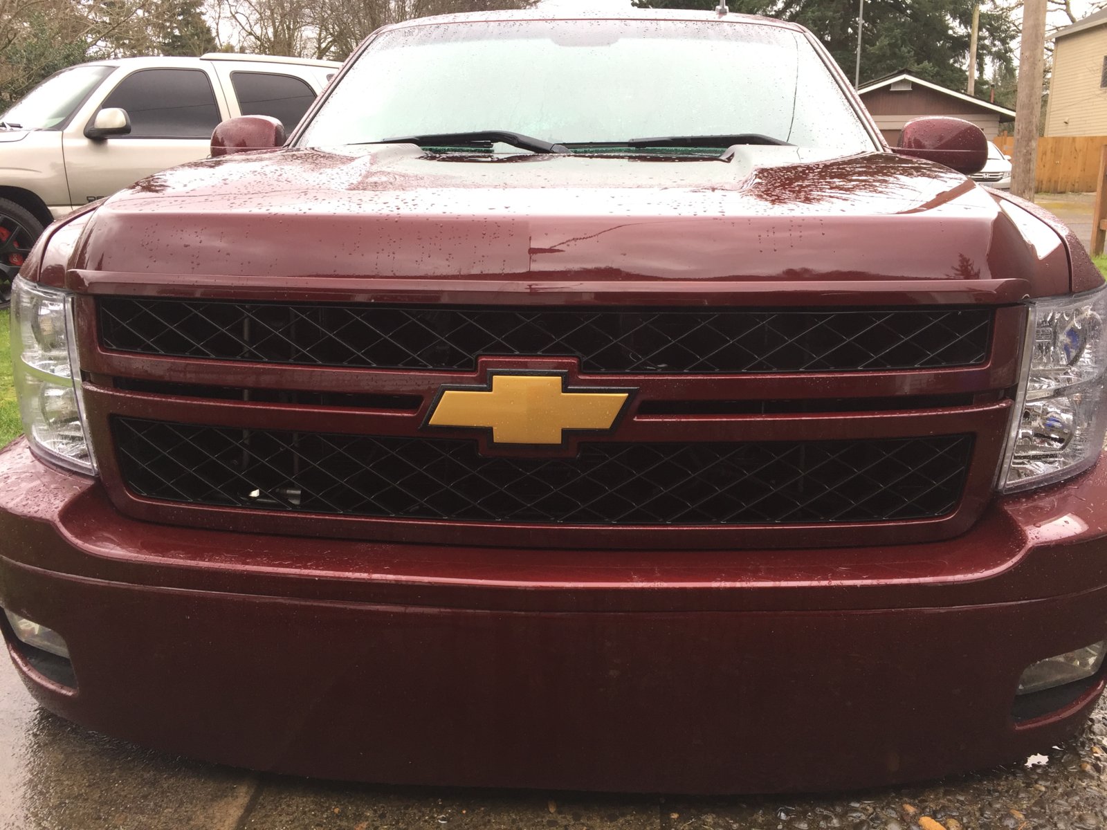

Since I LOVE deleting chrome, I already found some to get rid of. It had a ******-looking billet grill insert. It wasn't even straight. Plus it was chrome. And super easy to remove. Big improvement plus I can sell it. I straightened it after removing it.IMG_7479.JPG IMG_7485.JPG IMG_7486.JPG IMG_7488.JPG IMG_7489.JPG
