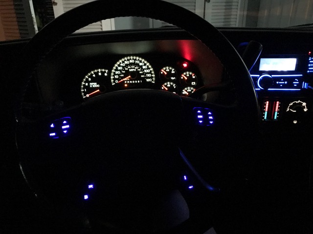

I was scared to try, but went ahead and bought new steering wheel controls and replaced them... Super easy, pop the old one out, remove the wire connector, replace it and pop it back in.
I replaced 2 of them for $35, doorman off ebay, and they work perfectly and the lights look right at night.
