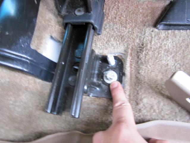

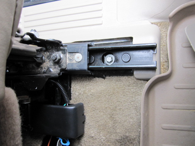

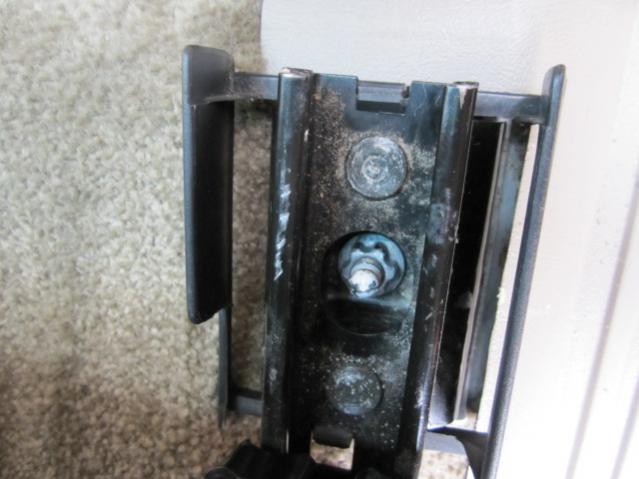

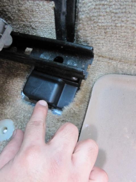

Look at the four pics below to help you out. If I remember correctly, when I did my seat mod I had to use 15mm (fronts) and 7/16 (rears) sockets. I used my 1/2" drive ratchet and it was sufficient. The other two starred sockets/bolts that hold down the inner rail are covered with trim. The first pic shows the plastic trim that has to be popped off (toward the door), and the fourth picture shows the other inner rear bolt that was hidden under the plastic trim (you can see the tan/neutral trim on the right side of the pic on the carpet).

Thanks JP and Joe and great pics. Lot of good help there
