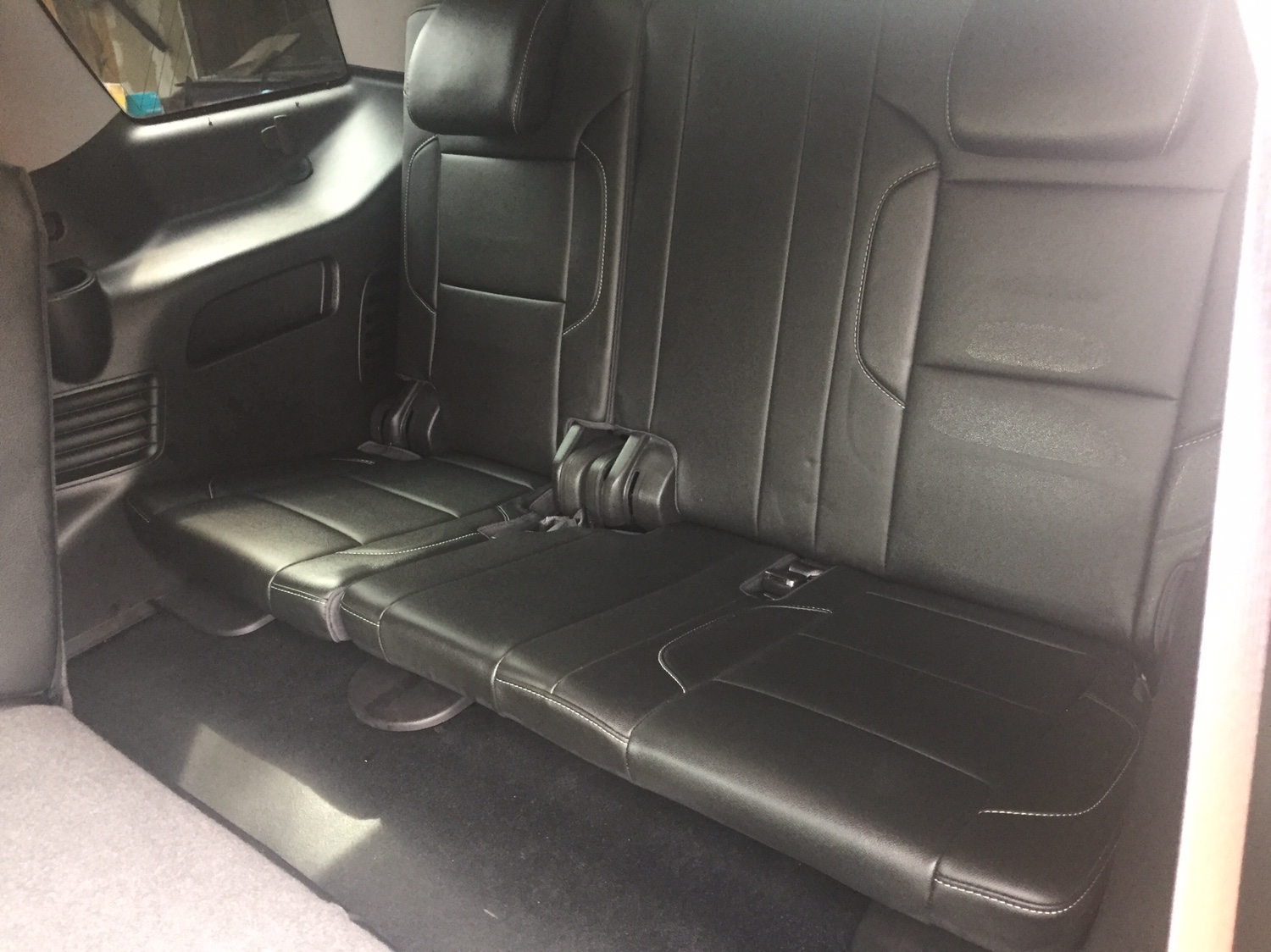

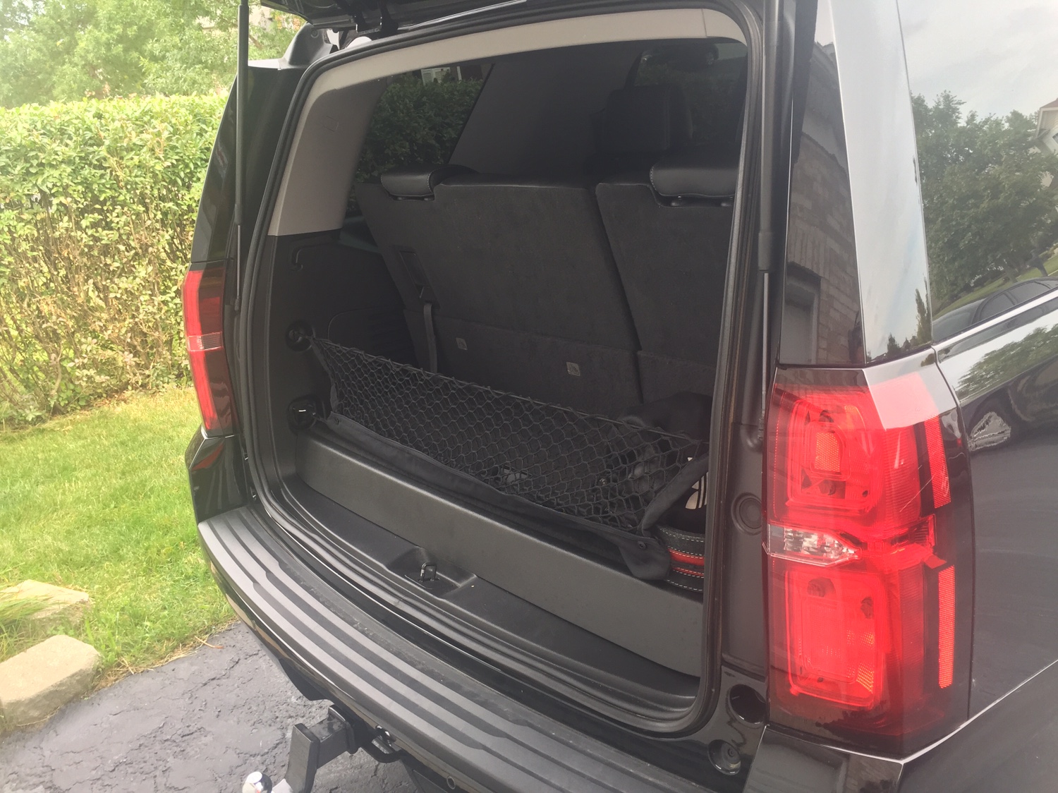

So just an update.
Drained an refilled the diff with mobil 1 75w-90
The dealer replaced all pads and rotors, but I have the dreaded ppv squeak. So I ordered RAYBESTOS front EHT1367AH
RAYBESTOS rear EHT1707H
Pads.

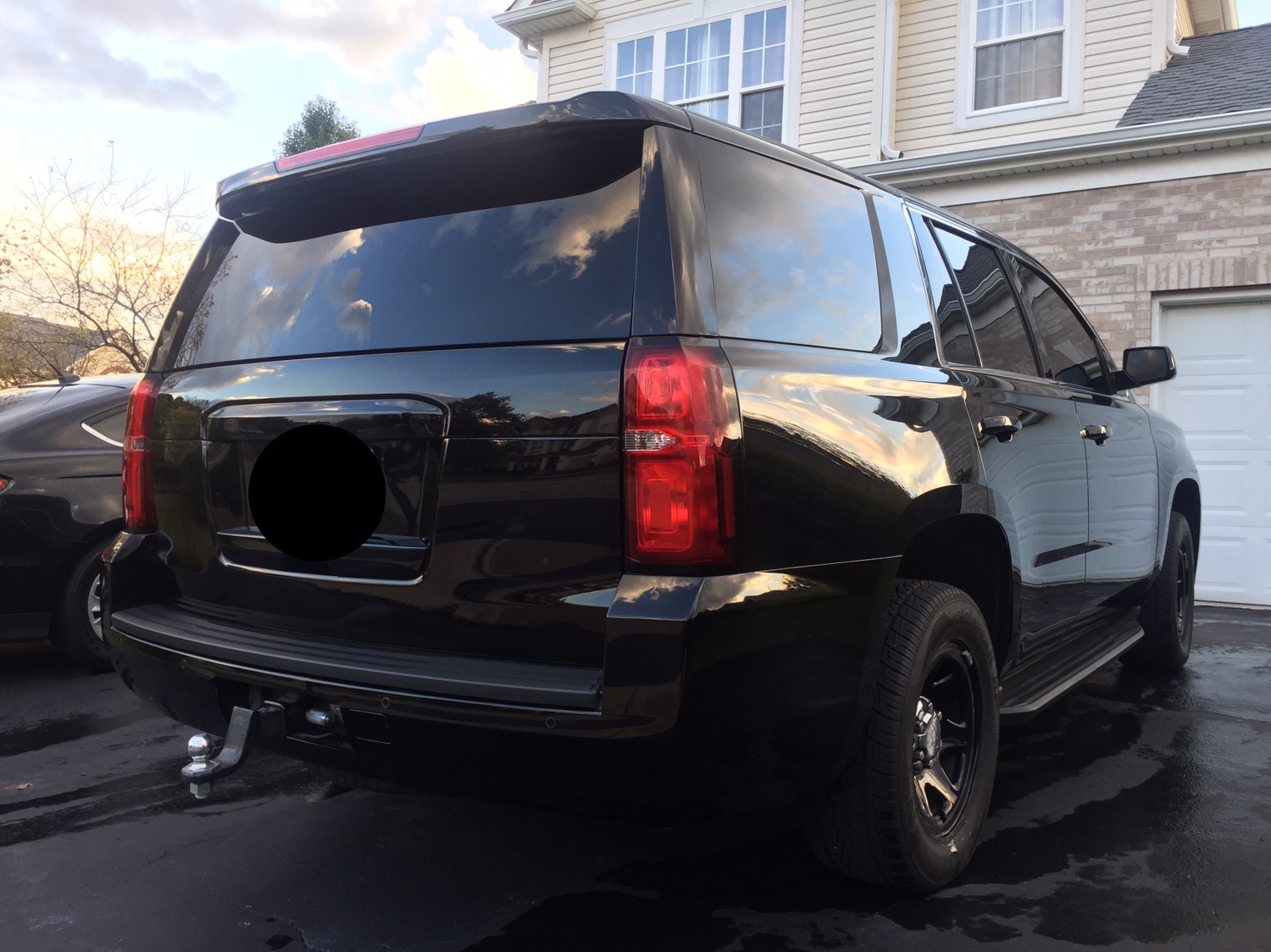

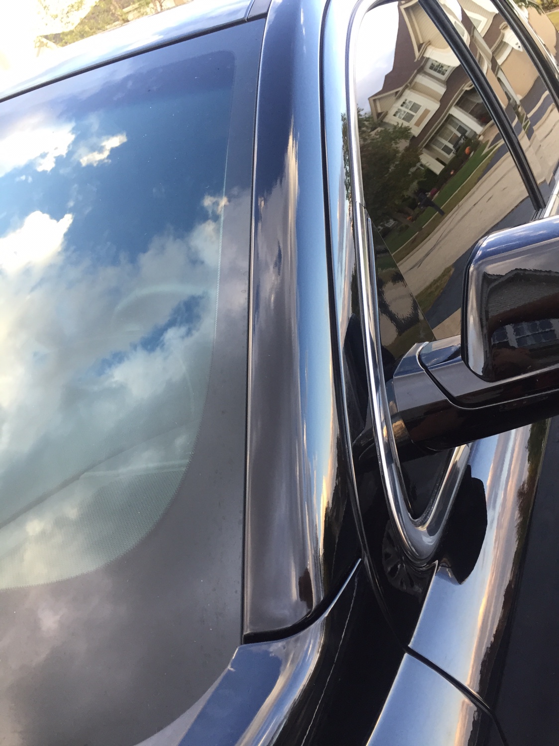

Installed katzkin leather, center console, tinted windows, installed 3rd row seat and cargo box.
Soon I will Be getting the spotlight holes filled and painted.

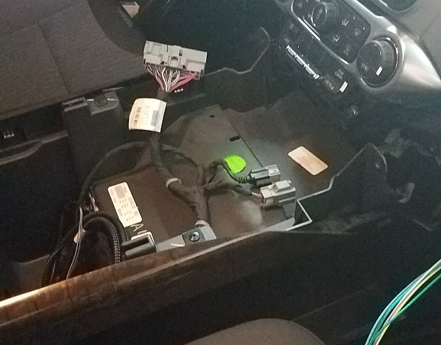

How does the center console mount in these? The old ones had those brackets that went over the studs for the front seats and under the seats themselves. The 2015+ consoles have no brackets, and have holes on the side.

There are 4 threaded holes in the floor pan where the console lines up and you can bolt in

I am trying to get the dash board trim pieces under the actual controls off and can't figure out what size bolts are way deep in there above the cigarette charger port. I've shoved all different sockets in there and nothing is catching.
Definitely not as easy as a 07-14, which just slides in and bolts

I started at 8 millimeter and went up, it's a 7mm what a bastard bolt size
