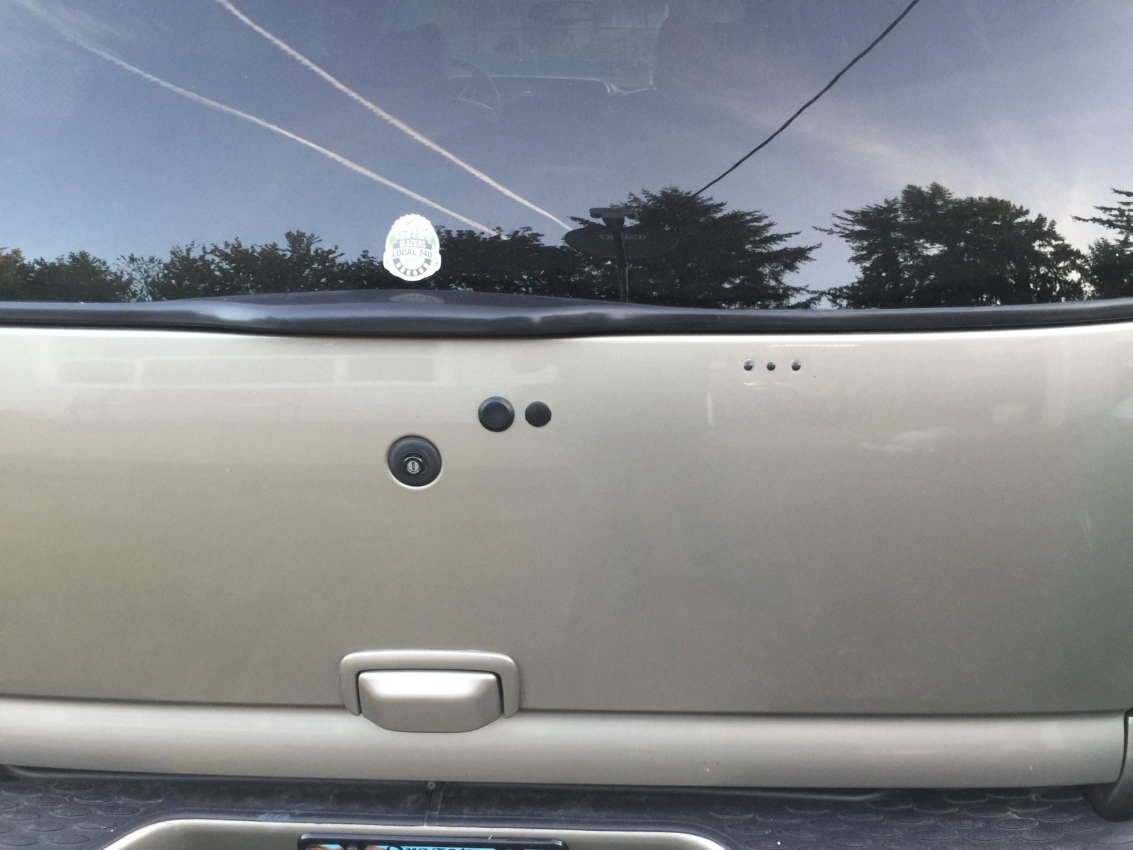

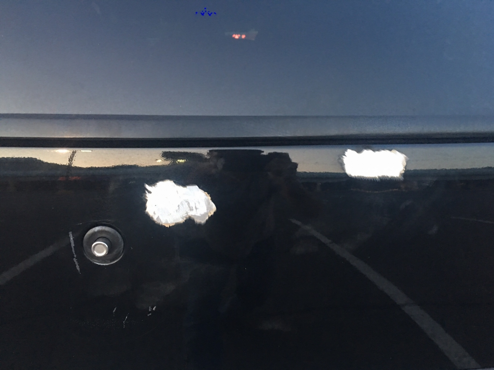

Here's how I went about the rear wiper delete on my truck.
First off you need to pull the trim panels on the hatch and remove the old wiper this is a great video for showing you how to do all that.
Picked up these plugs off EBay. https://m.ebay.com/itm/50-Piece-She...quot-2-quot-/122397885057?txnId=1852897729002
Picked up this black silicone sealant off Amazon, the reason I went with this, is its a lot easier to apply with a caulking gun imo. https://www.amazon.com/gp/aw/d/B000HBGJ8Y?psc=1&ref=yo_pop_mb_pd
Pick out the correct plugs, put a decent amount of sealant on each one, pop them in and clean up any residue and let them sit for a bit then seal up the back side and your good to go.
