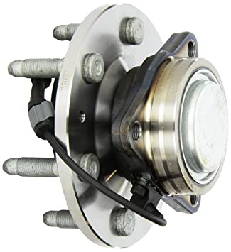

I recently noticed my passenger front wheel bearing had some play in it, so I ordered a hub/bearing assembly from Timken SP450303.
Since PPV's are 2wd there is no axle shaft that runs through the front so the hub assembly from Timken itself is sealed.

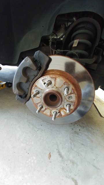

However, on the current hub on the vehicle, I can see the splines like if it was a 4wd hub.
Was there some design / revision change or are the hubs on the truck now incorrect?
Thanks!
