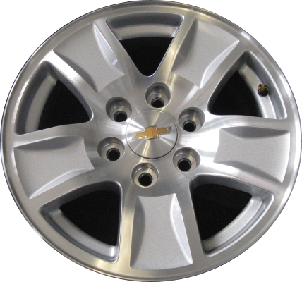

Wait, "aluminum 17" PPV option rims"? I'm not seeing anything in the wheel listings for Tahoes, what wheel is that?
Edit: Okay, it looks like it's P/N: 23173537, code Q5U. Got any pictures of that wheel? It's GOTTA be lighter than the steelies!

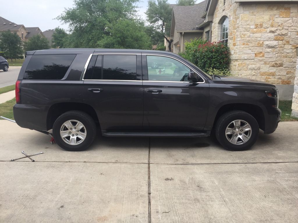

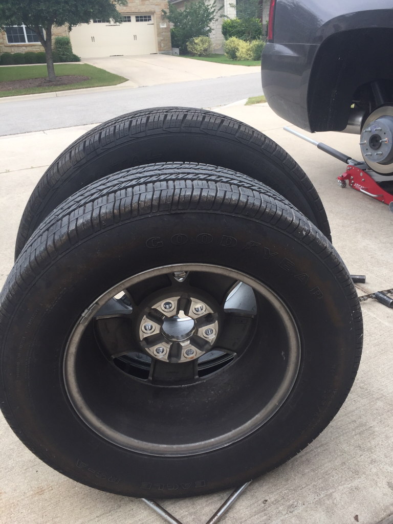

Thought I would update this thread. After a bunch of "just sold them" finds on The local Craigslist, I finally scored a set of BRAND NEW take off 20" chrome Denali 10 spokes with new factory Continental tires. Lucked out and the Chevy center caps from my police wheels popped right in place of the GMC caps.
Listened to your advice and had the truck aligned after upgrading to the 20" rim from the 17" rim. As suspected, the geometry did not change with a rim swap alone, and no adjustment needed.
Ride quality improved 10 fold--cop tires are very unforgiving. My PPV is no longer "pursuit certified" but it looks and drives much better.
I still need to have my computer reflashed for the new size tire. Anyone know what that costs from the dealership?
7b3dd2793be8f0c556406c17598a75c8.jpg BEFORE
fb011d93290435b3a761e8ad06479bf4.jpg AFTER
2c2e7f10dd3593a9a515ca71dc16fd21.jpg SIZE DIFFERENCE

Size difference is crazy! Those tires on the 17s look way too small to be on a full size suv. Lol. The swap looks great! Those denali wheels look good, especially on your color tahoe!
