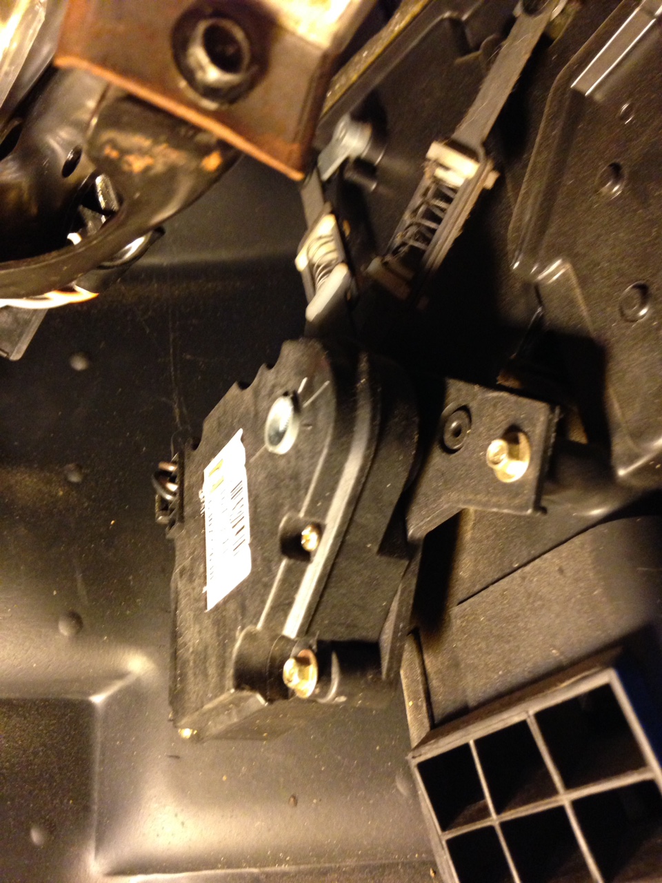

    It would probably be a bad/sticking actuator or a connected damper door that has somehow gotten dislodged in the air case.
    There are three actuators...one for the recirculation above the blower, one for temperature (I think it's behind the ashtray) and one for selecting floor-panel-defrost.
    That one is just above the gas pedal.
    [​IMG]
    [​IMG]
    You'll see a notched dial on the face of it (near the barcode label in the photo). As you select floor/defrost/panel on the controls, watch to see if that dial turns as the actuator rotates the interior damper.
    Also check to see if the spring linkages are still in place. A lot of times they will fall off.
