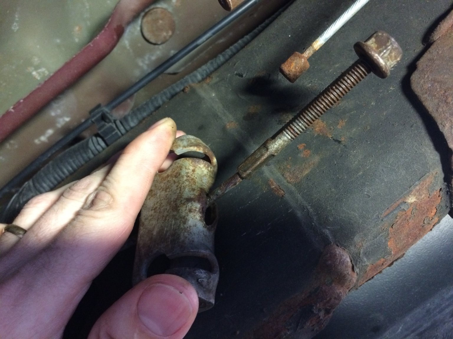

So, while doing my fuel pump, i had noticed the parking brake cable adjustment that seems odd to me. See picture. The adjustment bolt seems to have about 30 washers on it that function as spacers. This does not seem normal.
Parking brake is not as tight as I would like it and with brake lines failing on these trucks, I want to make sure my e-brake is fully operational.

The washers are someone's way of trying to tighten it up. My truck has the nut threaded all the way on the stud with no washers and it still feels like it could be tighter.
Junior_22g
Feb 15, 2016
19
Correct. The washers are to take up space for adjustment.
The poop design of the rear brakes on these trucks requires removing the rear rotors from the truck to adjust the ebrake. Total pain in the ass. I just replaced everything in the rear brakes including the backing plates on my 01 Yukon.
You are supposed to adjust the ebrake at the wheels, then use the adjustment where all those washers are as a short of fine tune adjustment.
Hope this helps you. Any other questions just ask!

I suspect you don't have much as far as parking brake shoes left at all with that rigging. Time to do the parking brake shoes and if your rear brake pads are low, just do it all like the guy above. New rotors, new shoes and hardware kit, new backing plate and new pads and hardware.

Gotcha. In your case, yes you could adjust the cable at the 1 to 2 splitter.
As for wear, they may have been adjusted too tight when they were replaced or likely not adjusted at all (which would make them tight).
