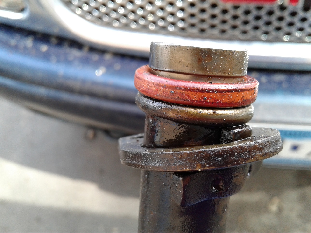

    I literally just went through this exact issue. I fixed it yesterday actually. I replaced my sensor and it did nothing. Mine ended up being the o-ring. It is a very easy job. Slightly more difficult/time consuming if you have a 4WD.
    I am not sure about the sensor filter in an 06, but maybe buy one just in case. I THINK they put those filters in on the AFM engines. Just my guess.
    If the gauge is responding to you hitting the gas, I would assume the gauge is reading fine and that the sensor is probably fine.
    After going through this entire ordeal, I would just start with replacing the o-ring. It was actually easier to me than replacing the sensor. The sensor is very difficult to get to.
    I swapped out the o-ring in 1 hour on a 2WD.

    Yeah, that reads like an O-ring to me too. A failing sensor would not drop down in steps like that, well, highly unlikely.

    Goes without saying, but while you're in there for the o ring, put a new pan gasket on too. Did mine on my 04 2wd last weekend. My oil pressure was fine but did the o ring while I was doing the gasket to fix a leak. Was surprised to see my overall pressures go up 5-8 PSI over the entire rpm range....even though I barely showed under 40 at any time before the new o ring.
