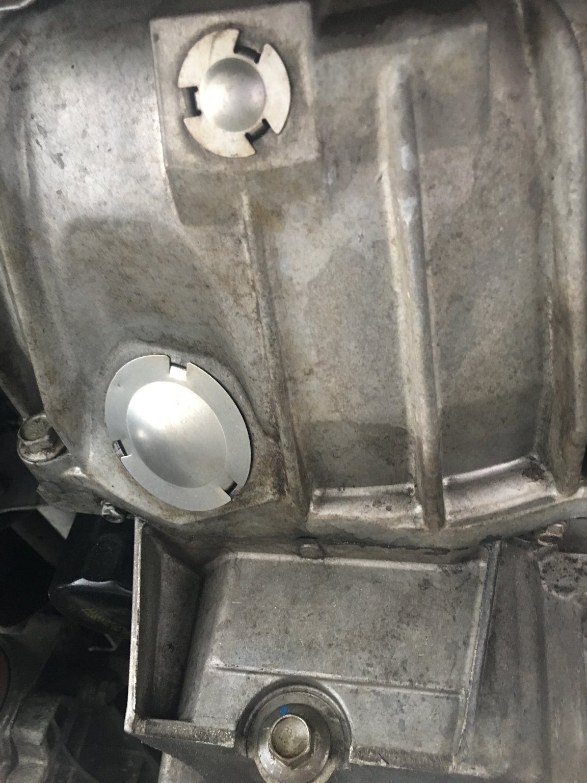

getting a drip about every 10 seconds at idle. What I have done. Changed valve covers, oil pressure sender, timing cover, and crank seal. It is dripping off the starter. Can someone show me a pic of the bell housing inspection plate. I suspect the, oil pan and rear main. I have not done the intake manifold as well. Is the intake likely with lots of miles? Help please!

If you got that much oil coming from your intake manifold then you've got bigger fish to fry my friend.
The inspection plate is the bigger of the two discs. You can pop it out a flat head. Hopefully you see no oil.
You can always spray everything down real good with some brake cleaner, start the truck then use an inspection mirror and flashlight to try and locate the origin of your leak.

Thanks so much. I seen those plates but wanted to make sure. I know that I should clean it up and look for the source. Sometimes easier said then done. I just want to see the most likely oil leak issues with these vehicles. I am given the Yukon a rest today. The ball game is on.

Pull the starter and look above it at the crankshaft sensor, it could be leaking from there also.

As far as the inspection plate; can it just as easily be put back in without being loose? I've read tons of posts saying it's not needed, but my OCD wouldn't allow that. Just curious if it pops right back in place.

Yes, it'll pop back in. There are three prongs that hold it in place. If it's a little loose after you reinstall it then pop it back off and bend the prongs out a little to take up any slack once it's back in.
The way I see it is it was put there for a reason. If it wasn't needed then GM would have saved a bunch of $$$ by not having one. It keeps debri out. I surely don't want dirt and rocks getting in there flung around especially when my starter engages.
