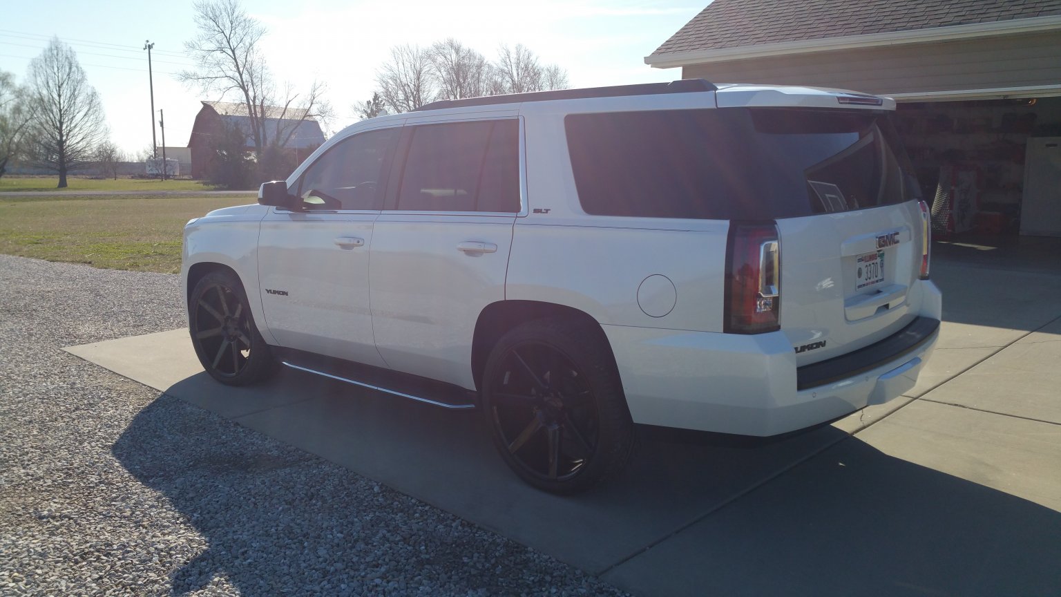

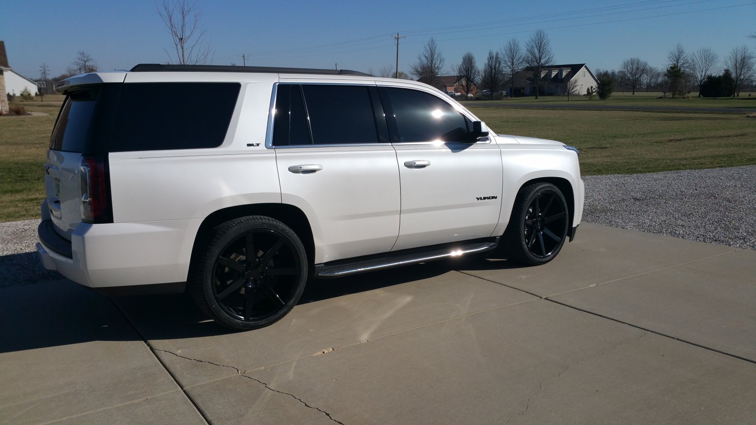

Put kit of yesterday.
Front dropped from 35 11/16" to 33 3/4" I had 21,*** miles on previous tire and put new wheels/tires on at the same time.
For the rear: 37 5/8" to 35 1/4" drop. I used the hose on top instead of spacer, but used spacer on bottom instead of hose. Tony suggests removing spacer and replacing with hose and getting a new adjustment bolt for autoride.
24" Dub Futures with Lexani tires

1) cut bracket off
2) remove spacer
3) make rear like 2.5 inches like we spoke about
will bring back the rear lower and look way better. I sent the links via usps mail should of been there for sure. if not I can send you another set
using the spacer and the autoride link thats in there now is lifting the rear up so has that rake. The kit can come down to 33 7/8 inches on that tire

You mailed the links? You shouldn't have! That spacer is so thin, I'm surprised it makes much of a difference compared to the hose.

the rear spacer is 1 inch if we are talking abotu the same thing. the upper insulator is almost 1 inch while the heater hose is like 1/8 once weight on it.
you will need my fenderwell mod. PM me ill tell you more

If he wants to being rear down to match front I highly recommend it.
