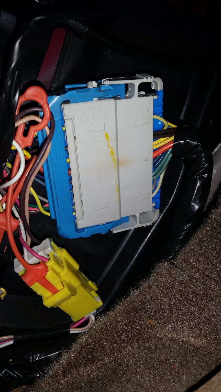

I took the floor panel apart (below the dash on the left, under the dash, to the left of the emergency brake) There is a large connector with a bunch (maybe 10? I didn't count) small wires and one LARGE ORANGE wire. The plastic around the orange wire was discolored dark brown like it had gotten hot. I opened the connector, (you squeeze one end and flip the blue handle up to separate the parts) I slightly bent the male connector down (toward the other connectors) to ensure a tight fit. I reconnected the connector and tested.
No more disconnection when wiggling it! The rear air works fine. If this turns out to be a temporary fix, I'll cut the orange wire and crimp on a more solid connector.

Thanks Garry
Had the same problem on 2006 Escalade. Blower was not working. Replaced resistor and still had same problem. Found your post and checked harness and blower started working after moving orange wire. Saved me from taking it to the a/c repair guy.
