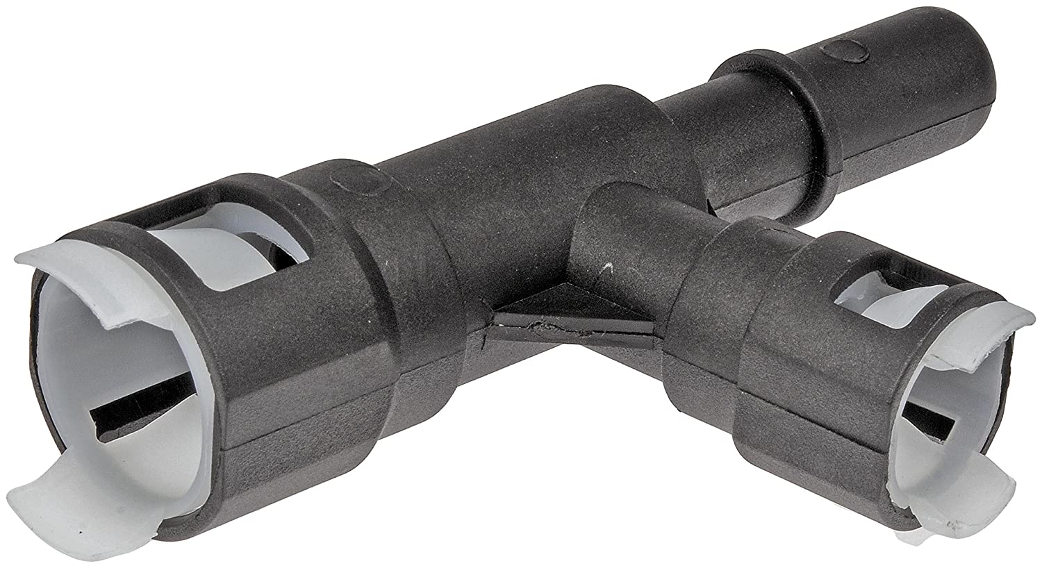

7. Look at the heater hoses that go up towards the firewall on the PASSENGER side. There are plastic 3 way connectors there. They slowly leak but don't drip till they get really bad.
