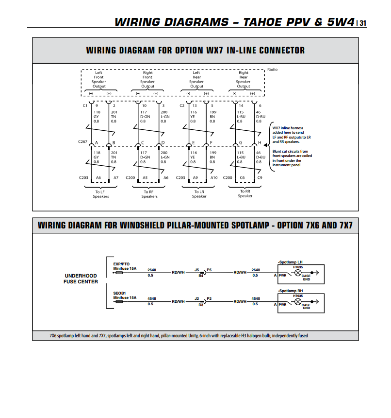

    Chances are they probably utilized the WX7 option which overrides the front speakers for the police radio to be broadcast through them.
    Here's a wiring diagram for it, oh and for the spotlight.

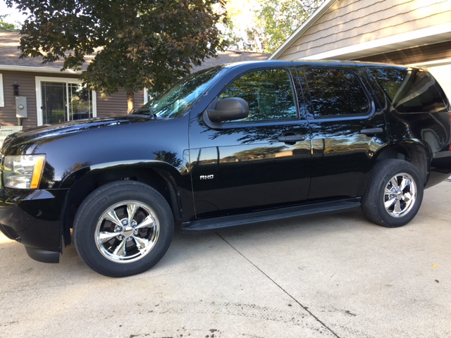

    1st attempt at a pic. Here is my ppv with 18 in American wheels with 265/60-18 tires. I bought the wheels in 2004, and have had them on 3 trucks now. They only made these in 18's for a couple years, then only 20's, and I don't they even make those anymore. Too bad nobody makes a 265/55-18 max performance tire.
