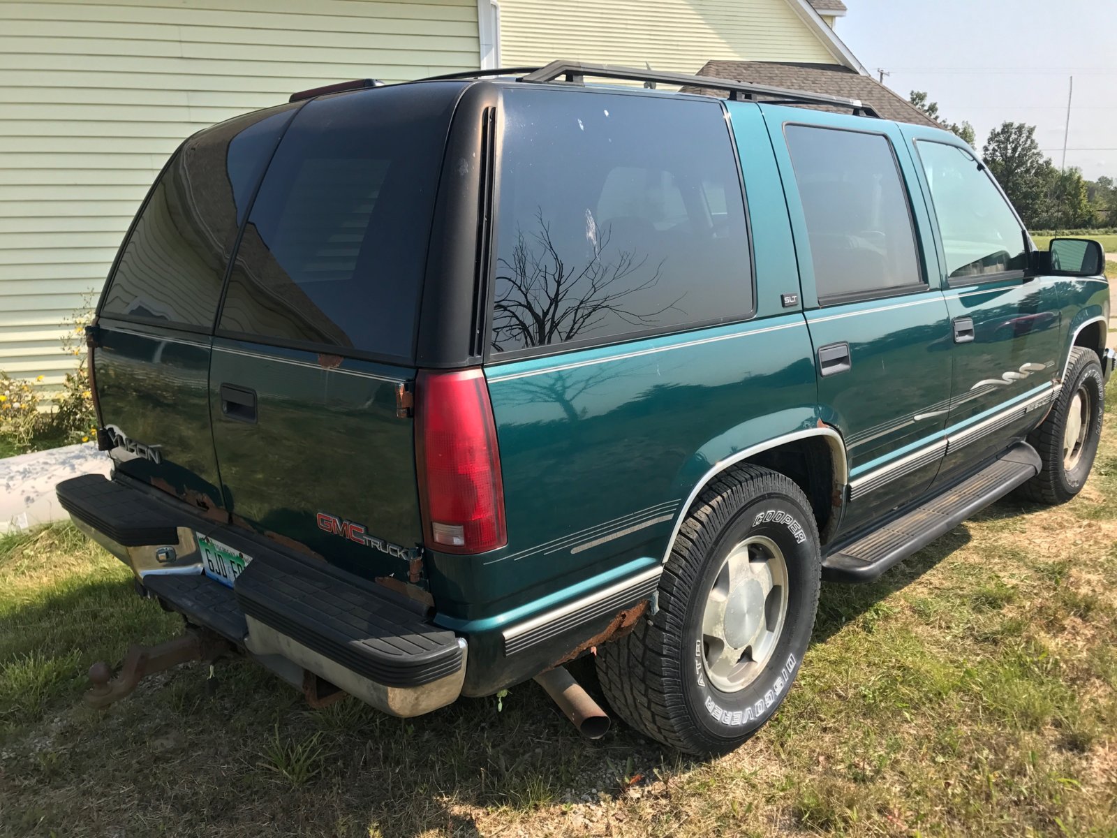

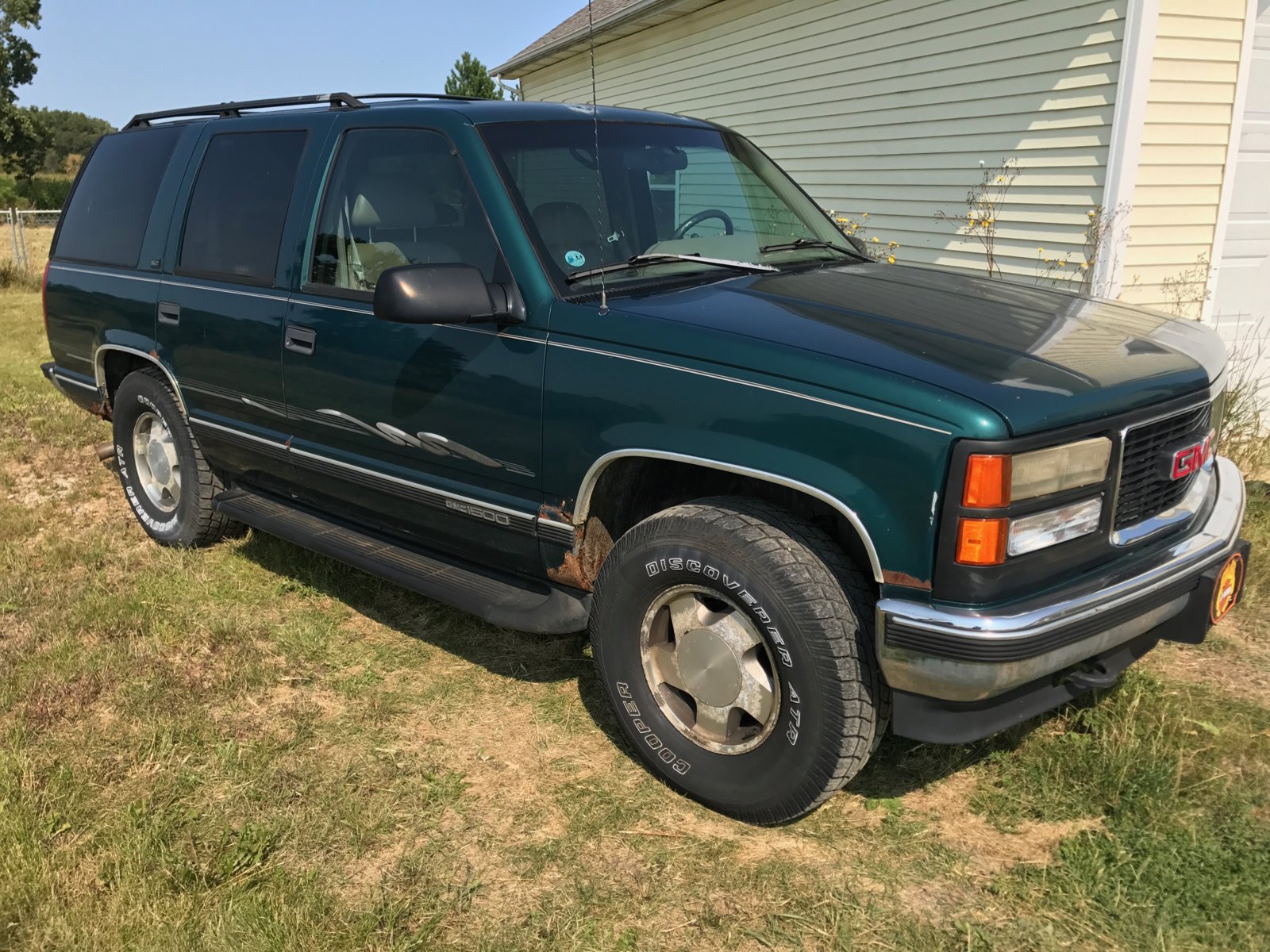

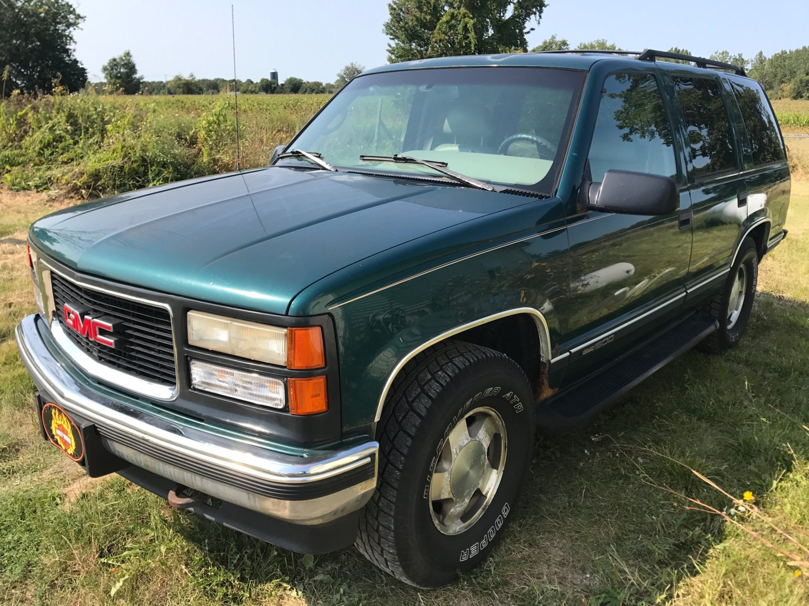

I'm Cody from Flint, Michigan (actually Durand). I've just picked up this wonderful Emerald Green / Tan GMT400 Yukon 4x4 from a friend's mom for $1200 with 170k, very good tires, and some rust here or there that is repairable.
It had sat for 6 years before my resurrection in the driveway. It needed a new alternator, as the old one was seized up, and of course a fresh battery and gas + treatments. Tank was near empty when I began, so I severely doubt I damaged the pump as I primed it a few times before cranking.

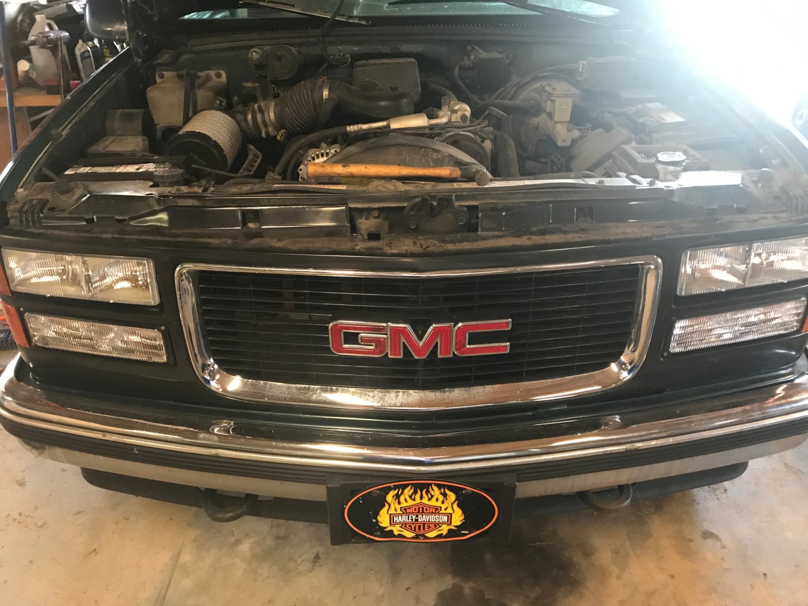

Threw fresh headlight assemblies and brackets in it last weekend, as you'll see how bad the originals were in the pictures. One had 2" of water in it.
Everything works aside from the A/C, which I've already determined is the compressor being shot. Bearing makes horrible metal noises to accompany it.
Rear diff cover started leaking the other day, seemingly as though I'd blown it out, as it coated the back of the truck with oil and residue. Gotta get a wash in there somewhere!

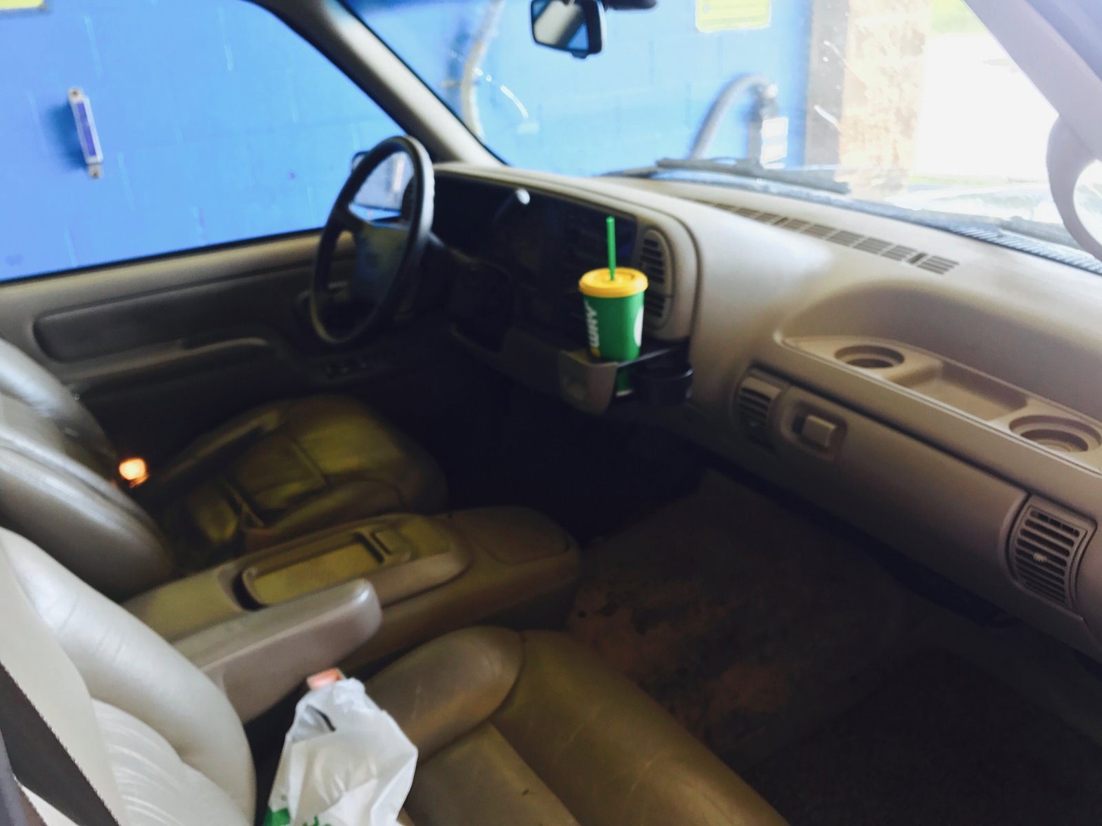

That interior is excellent. Lots of great info here for sure.
Thanks! It's not perfect, as the seems are splitting on the outer bolsters, and it all needs full detailing yet, but the leather should react nicely to some leather lotion. The headliner is flawless, as are the door panels. I had to ruin the barn door panels to get the doors open, but I think I can glue them back together and re-use them.

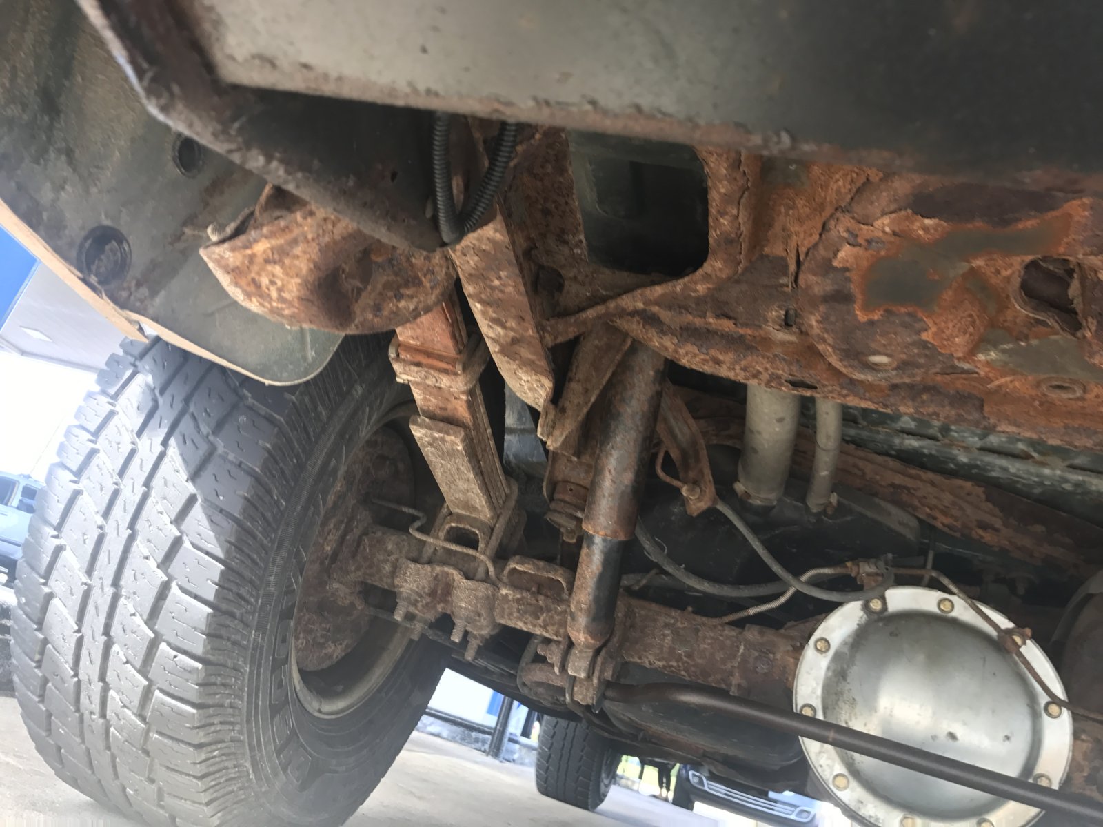

I'll have to get a picture of the frame condition up here soon, as I want your guys' opinions on whether it's worth putting much more money into this truck, or whether I should get the brake components done and drive it into the ground until something major breaks.
Body and paint condition is not bad as you've seen, but it needs patch panels and paint restoration, but the frame an suspension may need serious attention. It all moves freely and there's no through rust, but replacing any of it if it breaks looks to be a bear...

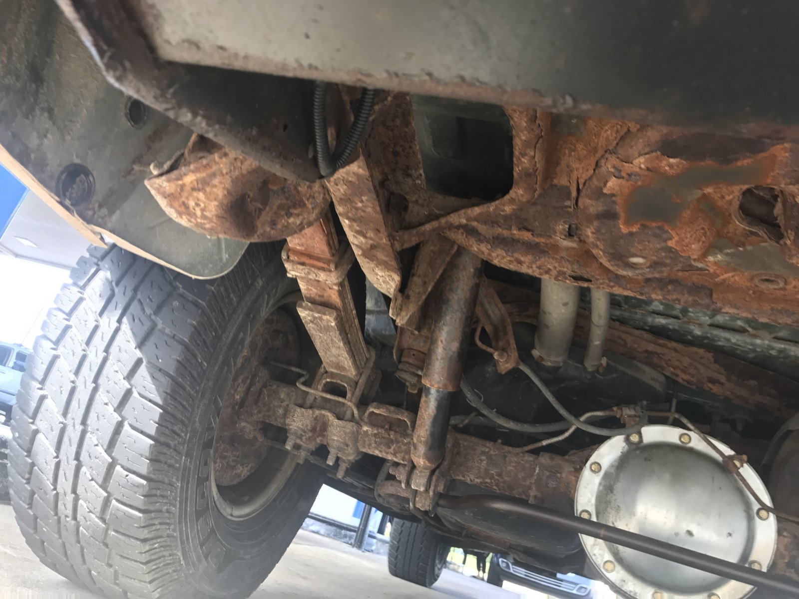

Grabbed a quick shot of the underside in the rear.
What do you think? Am I in danger if never getting anything apart?
