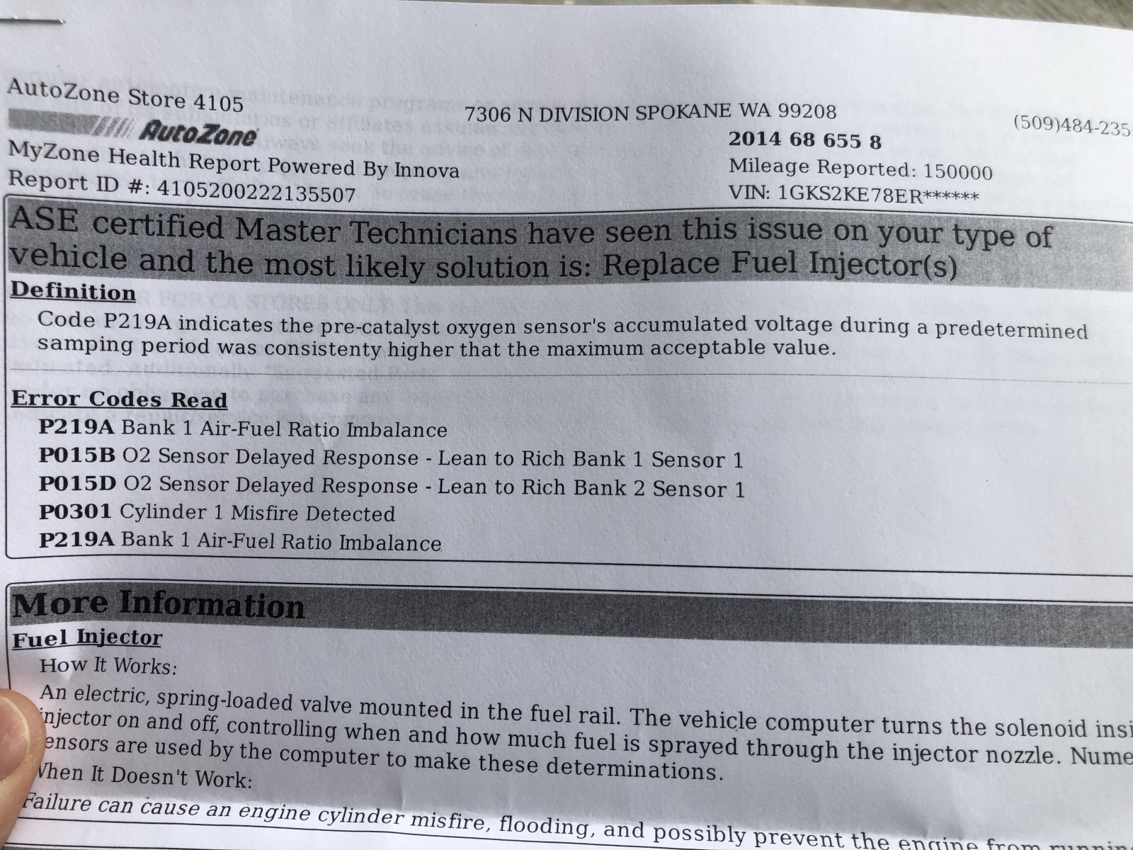

Code is saying I need To replace an injector on a 2014 GMC Yukon SLT with the 5.3 L engine. What are the best replacement fuel injectors? Thank you

You have a code that says you NEED to replace an injector? I have heard of diagnostics leading to that and heard people recommend that as a best guess but never have heard of a code like that that tells you to replace an injector. Am I missing something?

What particular code would that be?

Well, now I can’t find the printout. It did not say I needed to replace an injector. It said the problem could be the cats, an O2 sensor or symptoms of a bad injector. I replaced the particular sensor mentioned. The check engine light comes and goes. Seems it comes more commonly when it’s wet roads. I’ll try to find the sheet tomorrow or I’ll just buy an OBD-2 reader.
