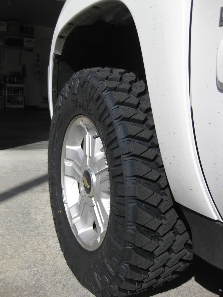

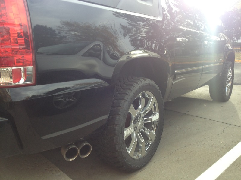

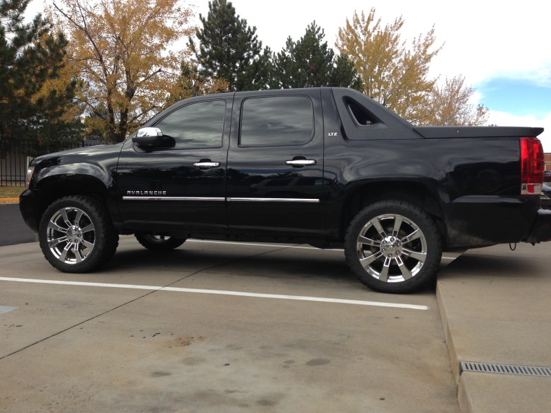

I don't have a hoe but it's virtually the same setup you're looking for. I have a 2.5" Top Gun Customz leveling kit up front and a 1.5" spacer in the rear I got from eBay. It's pretty much perfectly leveled on all sides now. I'm on some 33x12.50R22 Toyo Open Country MT's on a replica gm ck375 rim that's a 22x9 with +31 offset (factory wheel but replica made). I love the setup and it didn't affect ride quality one bit!
Hope this helps... here's a pic too:

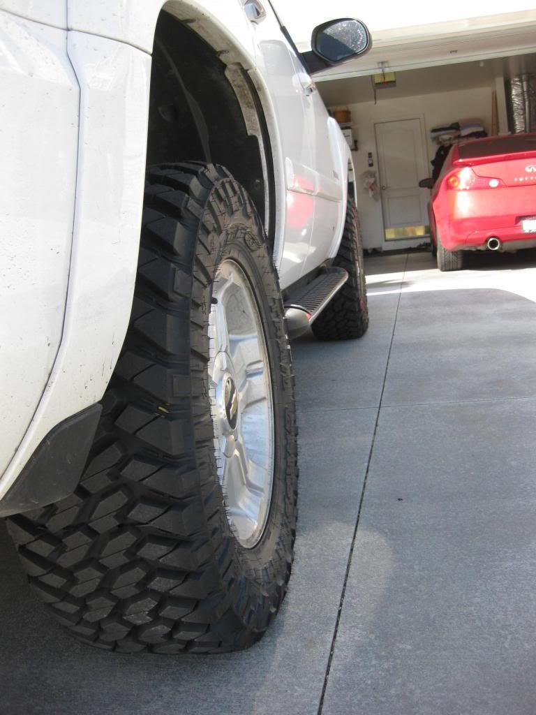

Here you go :mexsmoke:. Mods as noted in my sig.
Great setup: retains stock ride and great offroad. Louder than AT type tires but still quieter than a full MT tire. So far have 34k miles on them and they are wearing great (probably get another 10k with tread still left). You need to run them about 50 psi though and rotate them regulary (~5k).
The level kit and tires will reduce you mileage about 2 mpgs though.

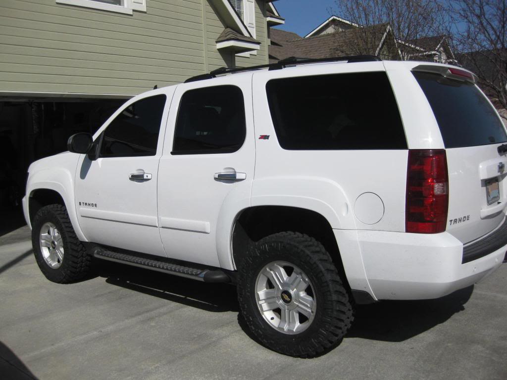

Could you put up some more pictures of how it sits with 2.5 front and 1 back?
Zed 71
Sep 30, 2009
1,229
12
Pacific NW
How's this? It was 0.25" higher in the back with out the air bags. However, I think this picture was taken when after I installed the air bags.
