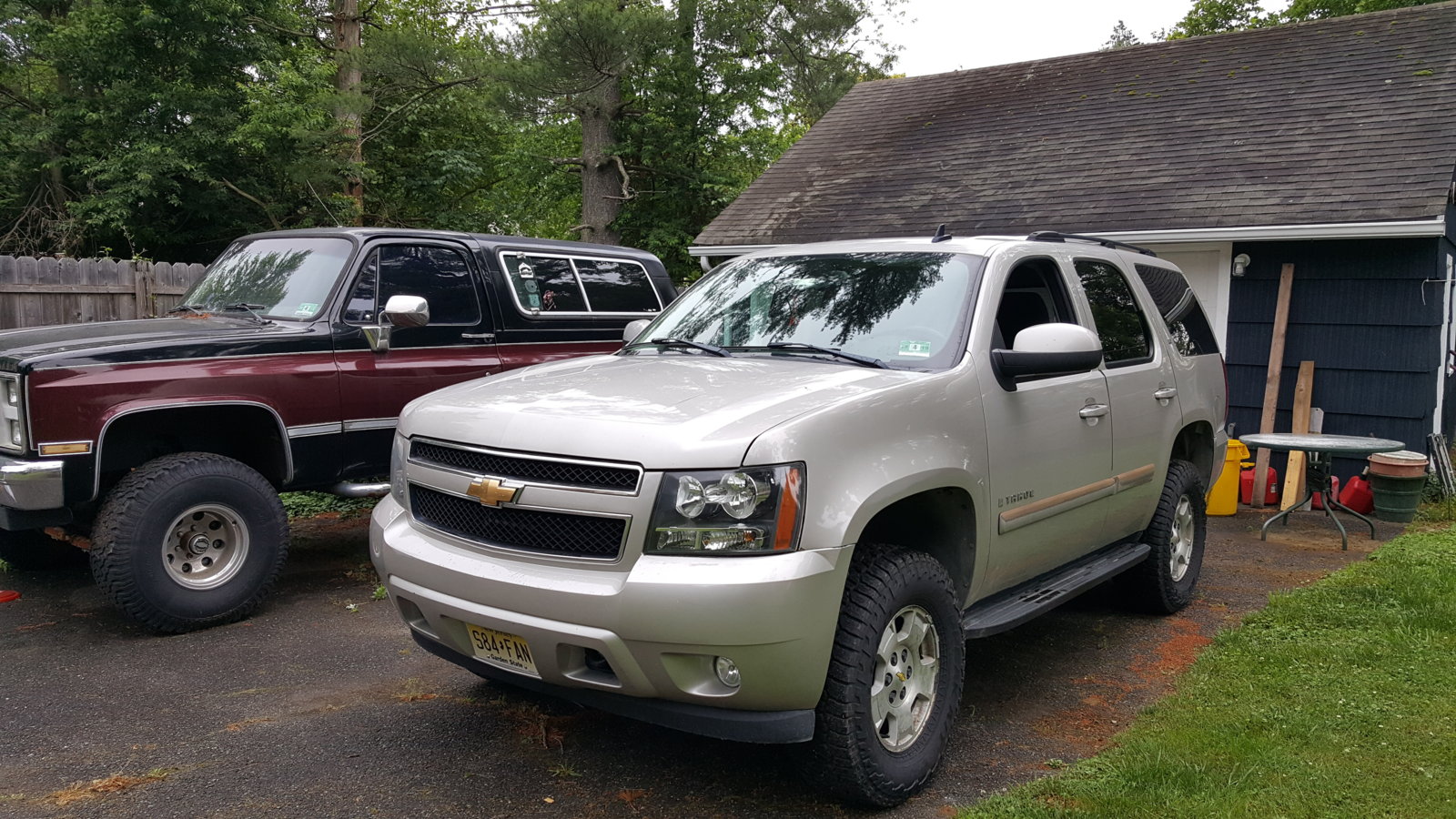

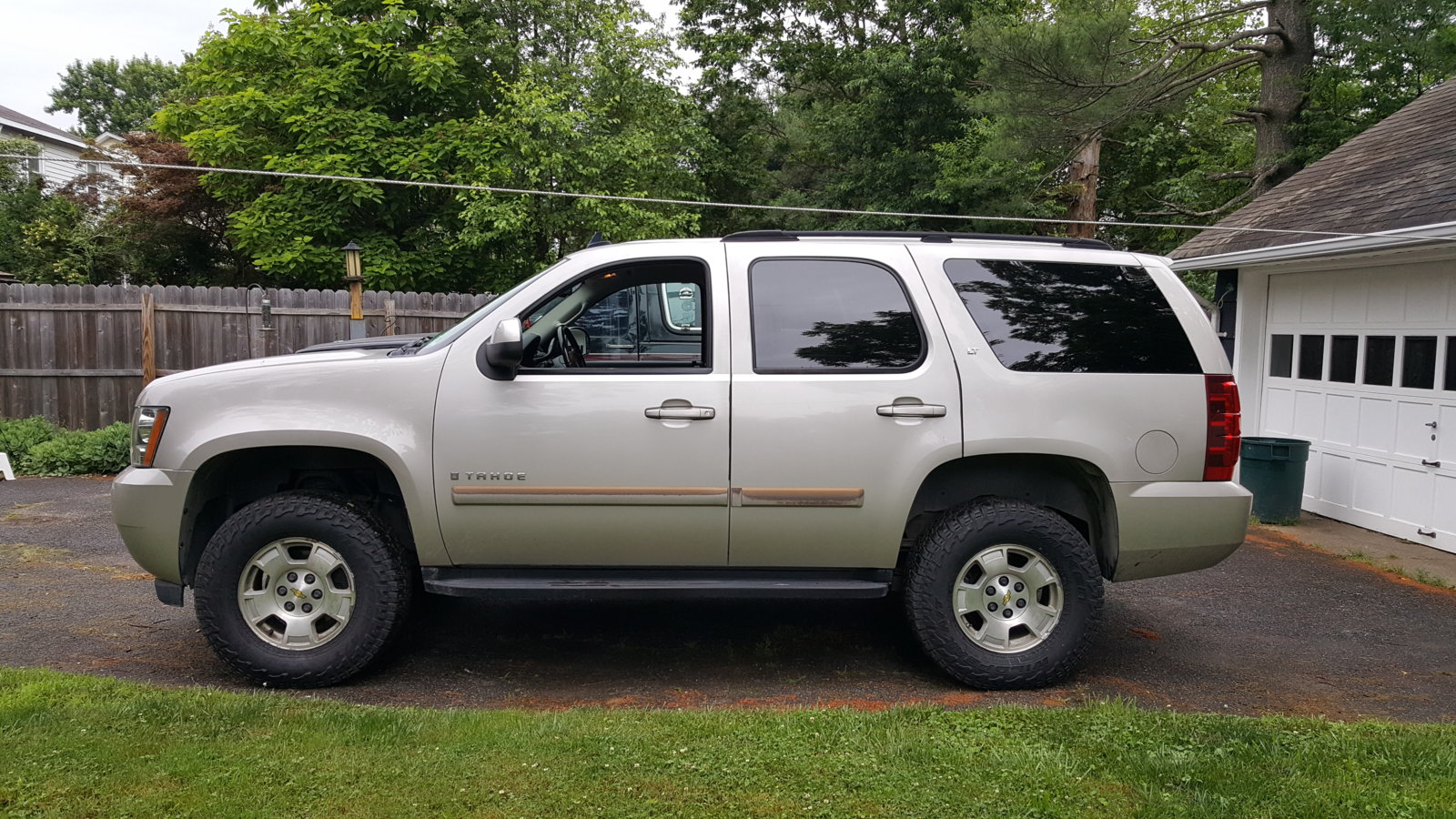

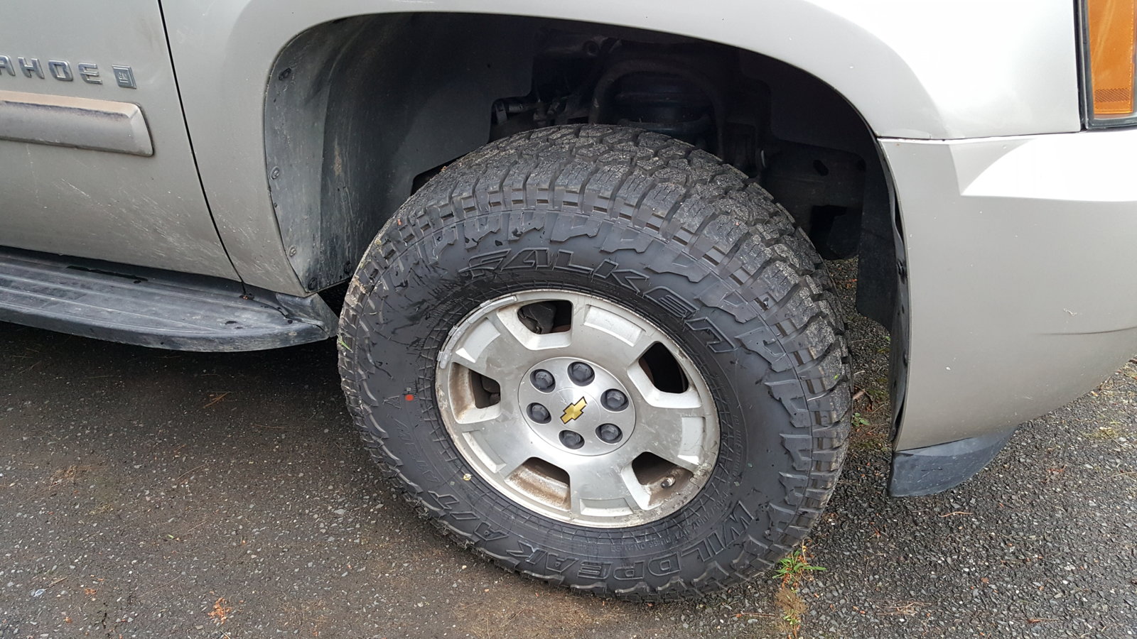

    Finally got some pictures of my leveled Tahoe. I feel like it's a little bit higher in the front. Although the measurements are close at just 39" from ground to middle of fender/wheel well. I also had the lower control arms replaced as they were bad according to my mechanic. It was the main reason I decided to level it.
    It's a CCM 2.5 inch kit front and 1 inch in the rear. Also had Bilstein 5100 shocks installed. Which ride even better than stock.
    Next up is new tires. Not sure if I can do wheels too since I had to dip into my build budget for some pressing life needs. But as for tires I'm deciding between 285/70R17 Falken Wildpeak AT3 or 33x12.50r17 Nitto Ridge Grapplers. The Falken are available in load E in the LT size or less in the P size. The P size is snow rated and has a higher warranty. Any pros or cons between LT load E rated and the P ones? I rarely if ever do any towing. Do the E load rated ride much harder? [​IMG][​IMG]
