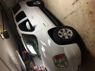

    I'm sure there's others out there trying to decide on what lift and what tires. I just got the ccm 2.5/1 leveling kit, now just gotta decide on tires and wheels. If you got any pics of any lifted or leveld

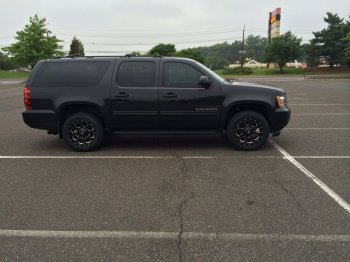

    Deets in sig.
    [​IMG]

    That's clean, what size tire and wheel is that?

    Wheels are 20x10 -12 With that width/offset i opted for 285's instead of the 295s that guys typically run with a stock or stock spec wheel, just to reduce trimming. That being said trimming is still required.

    Did you have to do a lot of trimming and does it rub at all on or off road

    I dont off road it hard so it doesnt rub anymore or less when in the dirt.. but it just grazes the front of the wheel well liner as it sits right now.. ive been meaning to take a heat gun to it and mold it a bit... i did grind out the pinch weld behind the liner as well.

    looking good, Vigh_J
