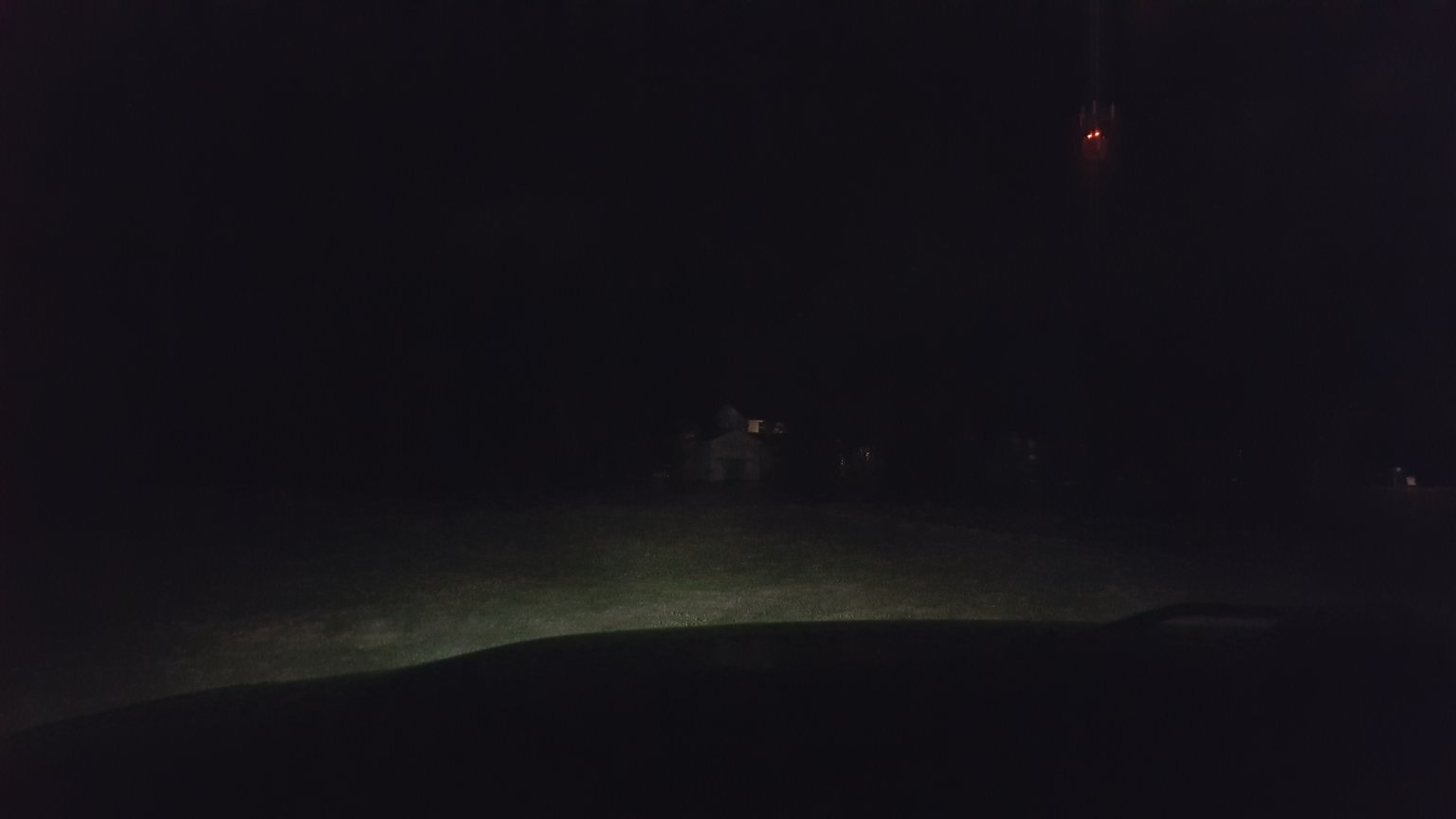

Below are some photos to give you some comparison
Note: The house is ~300ft away and the yukon was on a little hill to get the headlights to point up a little bit.
Parking Lights only:

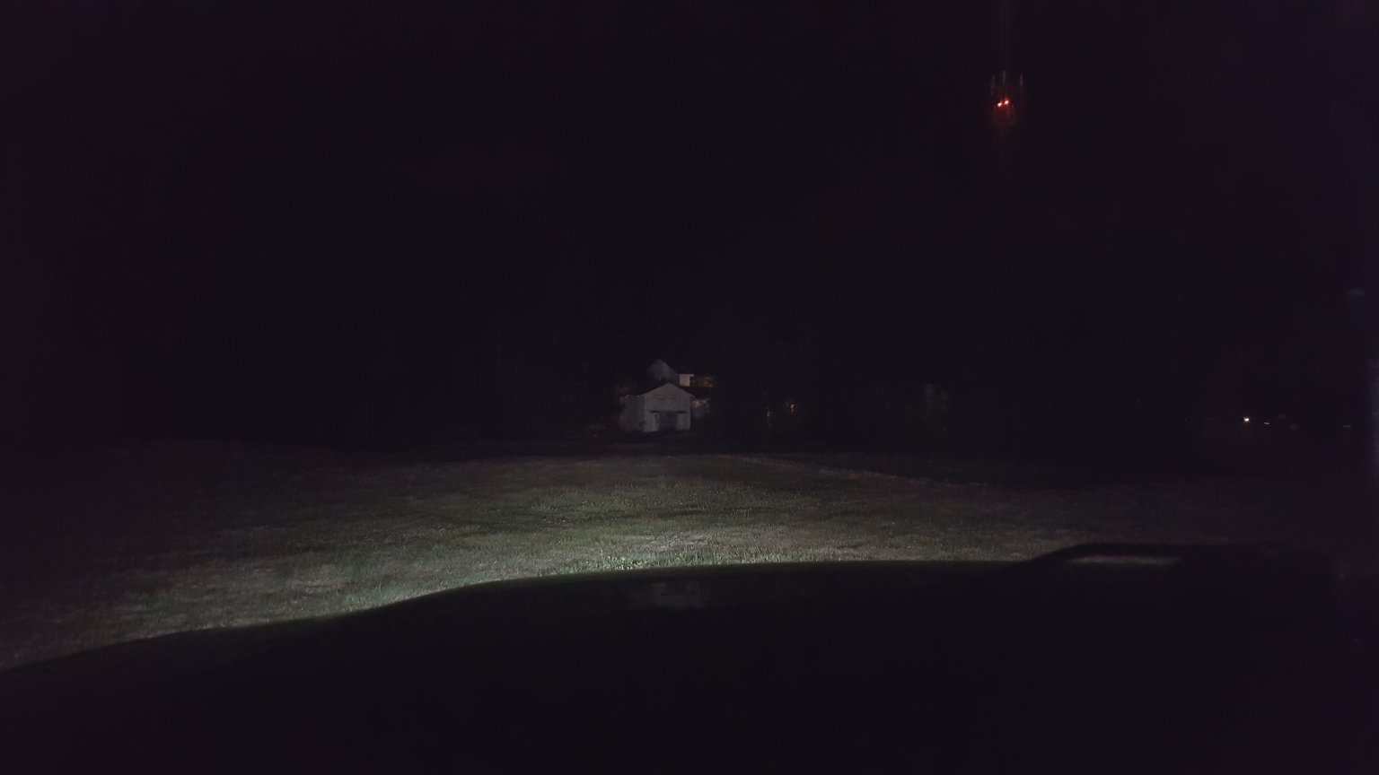

Fog Lights + Parking Lights:

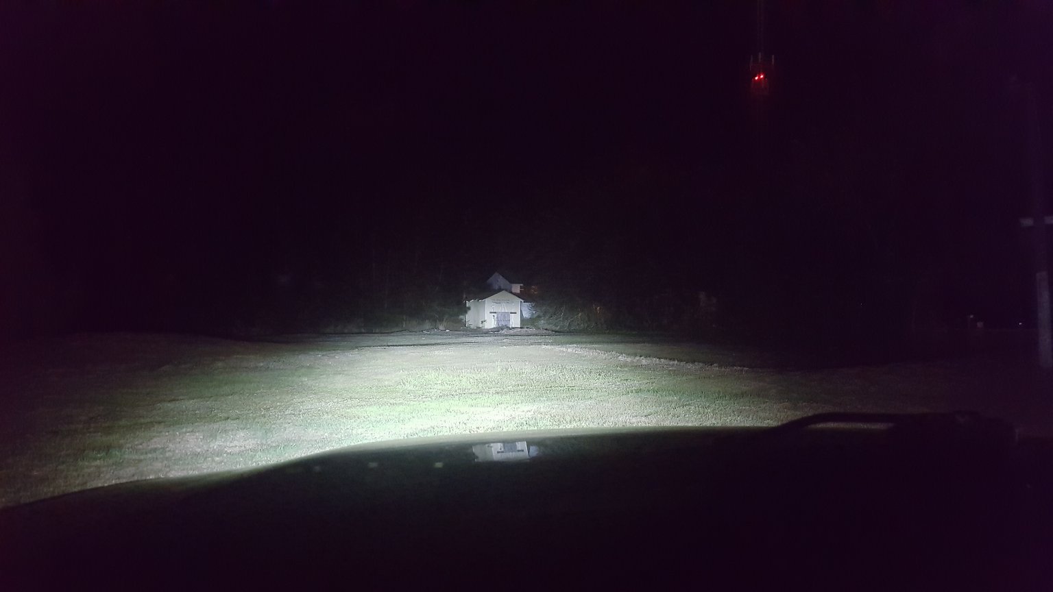

Headlights (Low Beams) + Parking + Fog Lights:

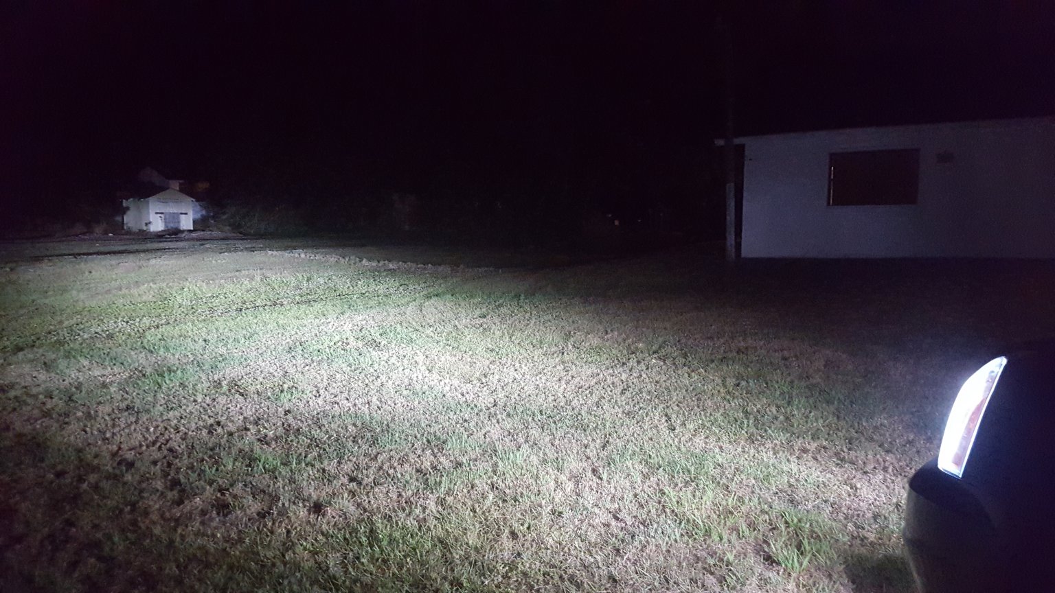

Outside with LOW beams
Headlights:
