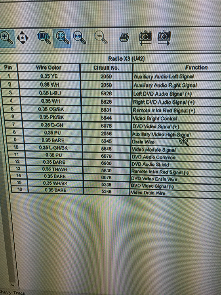

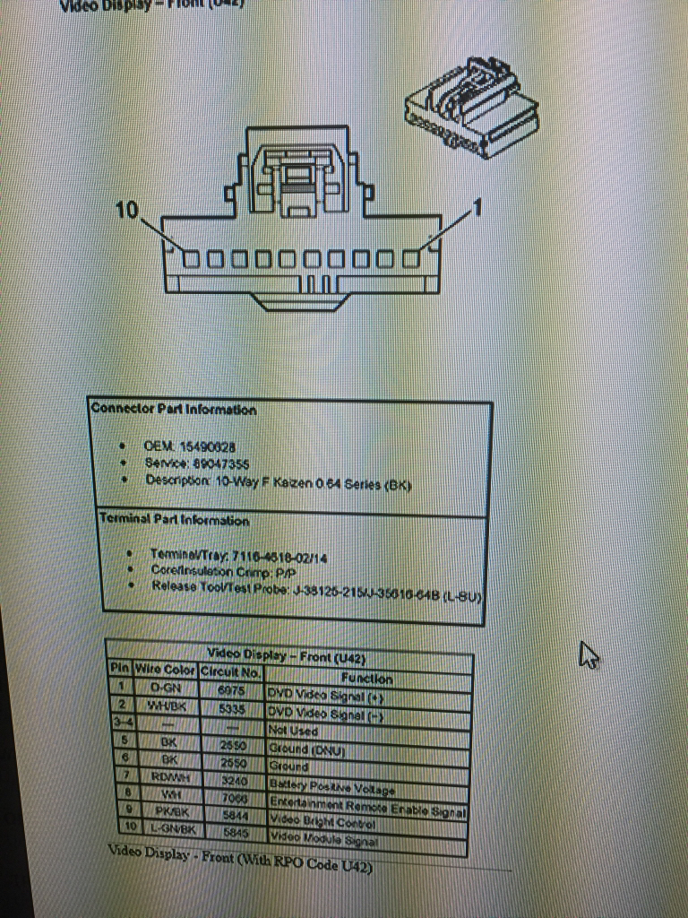

I have a 2008 Suburban LTZ with the rear seat entertainment package but have been thinking of installing a larger screen in place of the rather small flip down screen that comes from the factory.
I haven't had time to pull the factory screen down to check and see what the connector looks like but I am certain that someone here has probably done this already.
I have a 15" flip down that I would like to install and was curious if this connector might work.
Look at this on eBay http://www.ebay.com/itm/271942843274
I realize this is supposed to go behind an aftermarket head unit in the dash to retain the RSE but I thought perhaps they might use the same connectors up in the roof at the screen.
Any help is appreciated.
