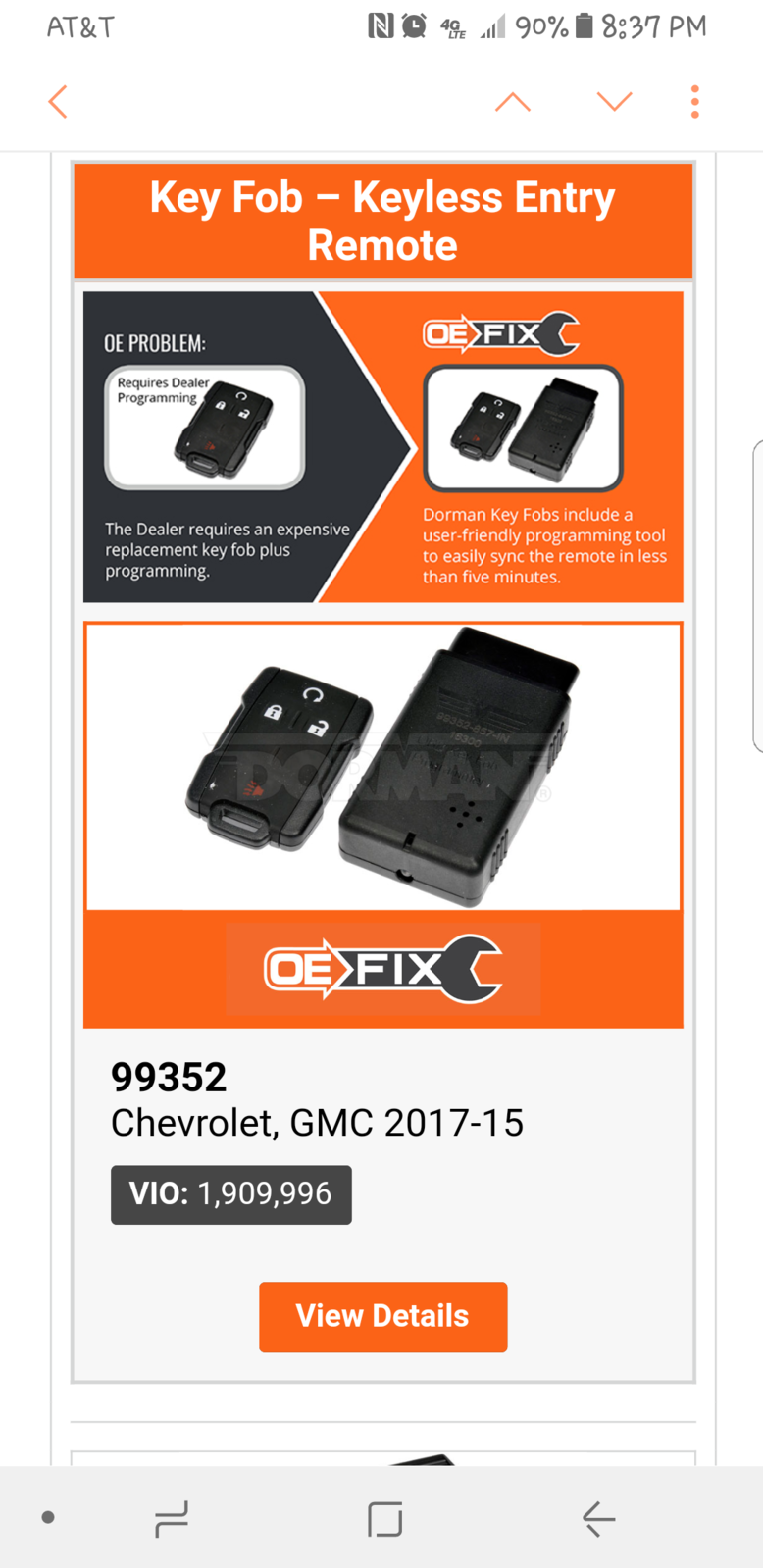

Key Fobs
dbbd1
May 12, 2017
924
354
Woo-hoo!
EDIT- not for my SLE (yet...)

Bought these a couple weeks ago, shipped to my door in three days.
Took all of two minutes to program both of them for my truck - simple as holding the lock button, cycling key from On to Off twice, releasing the lock button when the locks engage, pressing both the unlock and lock buttons on the remote to program it, repeat for each additional remote. Turn key back on to set, and check remotes to make sure they work.
Actually took me less time to program the remotes than it was for me to write the directions!
