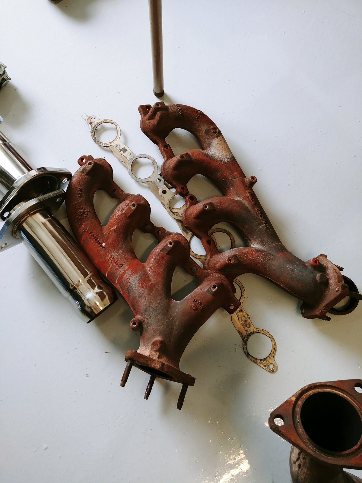

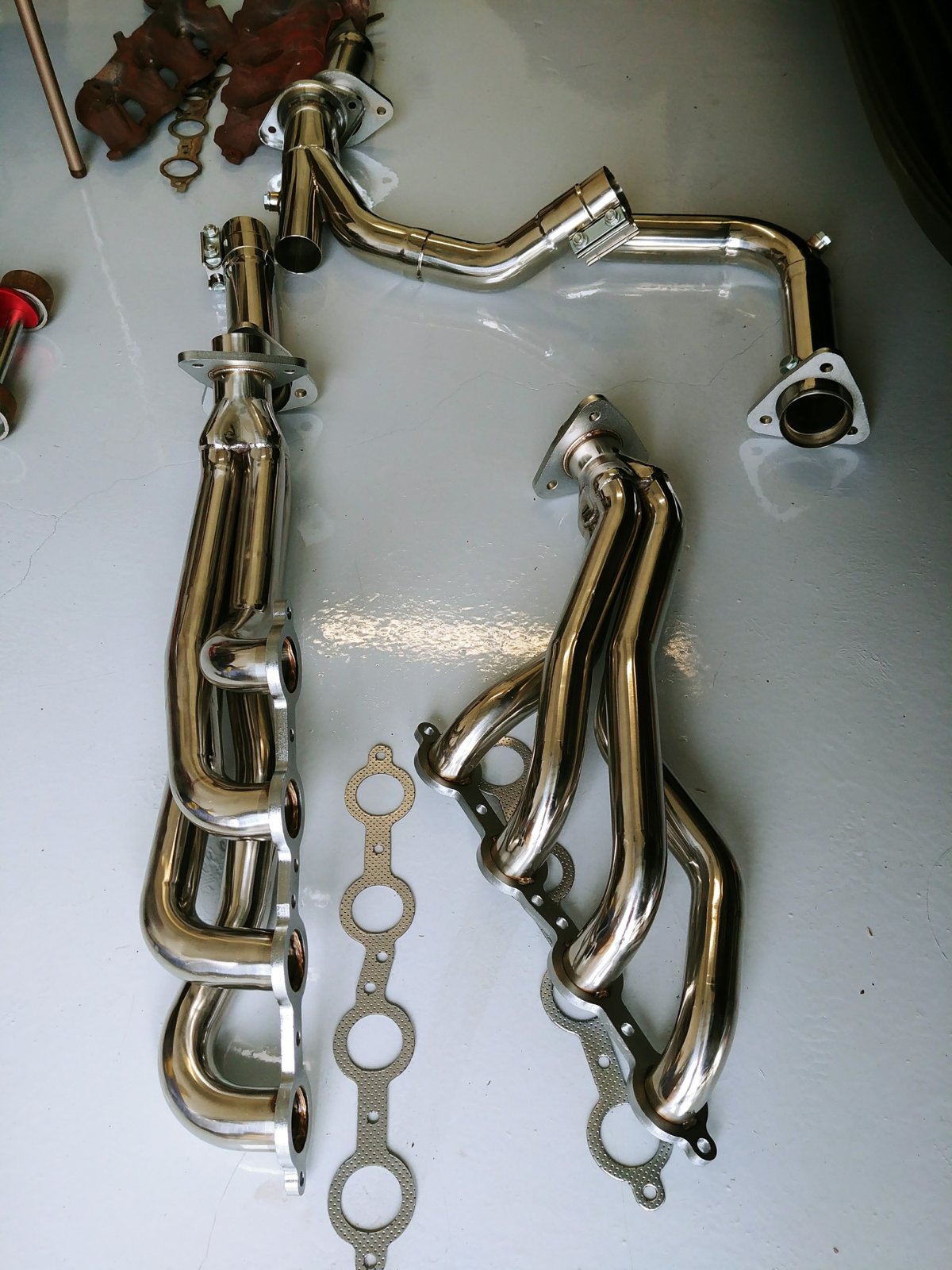

    So I tackled installing headers and a catless y-pipe this weekend. It was pretty straight forward but a little tricky by myself. I am happy with the fitment and quality. I am getting it tuned this Friday.
    I have not had a chance to drive it yet. Need to do some more heat wrapping.

    What year? What are you wrapping? Any cutting? Great looking system.

    My truck is a 2013. I am just wrapping the second pipe on the passengers side down my the frame. The pipe sits very close to the positive wire to the starter.
    No cutting needed because I removed the transmission support beam to remove the factory exhaust.

    What brand of headers and primary size?
    Did you have to support the transmission when you removed the cross member? I'm making a mental list of what I'll be facing when I do headers. New engine mounts are definitely on that list.

    They are DNA from Amazon. The inner diameter is 1.7" Spoke with a few different tuners. So overall consensus was not to spend the extra money for the brand name ones.
    I had to support the transmission with a floor jack while the support beam was out.

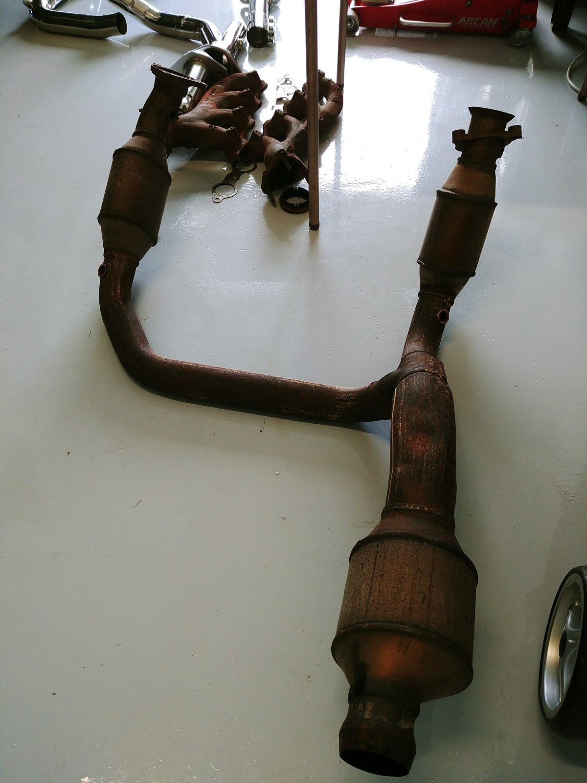

    Too bad I'm still fighting this flu, I would've come over and helped. Are you saving the old Y-Pipe? Looks great, do keep us posted.

    No worries dude. I have long arms. I plan to save the stock pipe incase I need to put it back to stock.
