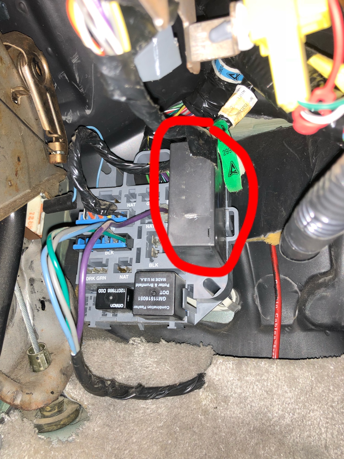

    Yours is functioning correctly, it will sound the chime whenever the driver door is open and the key is in the ignition or the headlights are on.
    If memory serves, pull this black box off and it will silence the chime. Pretty sure that the box is the speaker. This is by the parking brake and may have a protective cover over it.
    [​IMG]
