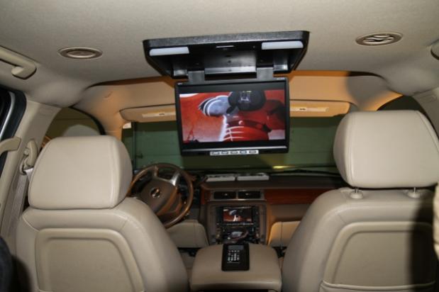

I attached a long bolt to a piece of long wood in order to create a platform where I could screw in my monitor securely. Use this link as reference http://www.youtube.com/watch?v=GUtRn1tJsKk
I have a 2008 Yukon so I use the same basic instructions, of course you are going to have to tweak some things.
I took power from one of the cigarette lighters in the middle console area.
This is a pic of the 17 inch monitor I installed.

That is a nice big screen you have. I guess if you are going to block the rear view mirror anyways, might as well go big.
