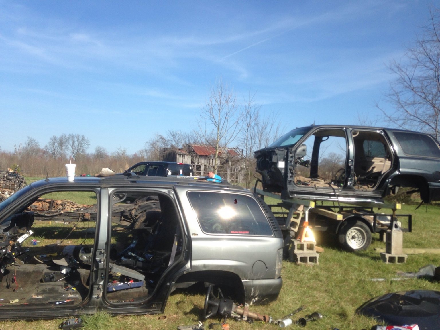

Did you get the ones up above the axle? Not sure if Tahoe has them but my Burb had 2 up front, 2 in the rear, 3 along each side, and 2 above the rear axle = 12
