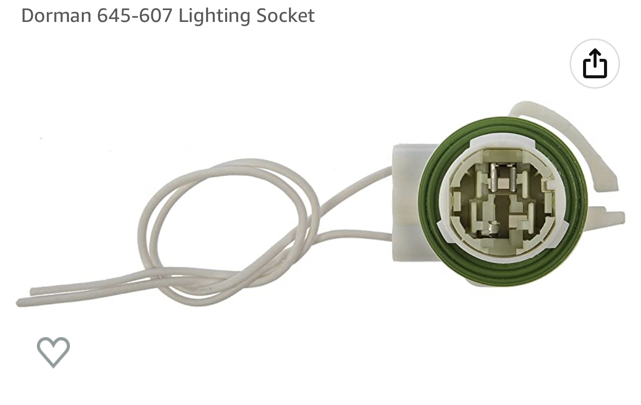

I used this Dorman and ended up replacing all on the front. I wrapped the crimp connectors in high-temp electrical tape to ensure waterproof. Don’t forget to align your headlights (up-down-left-right) with a long Torx T15 when you are at it. Shine your headlamps on the garage door from a car length away and get them leveled up.
