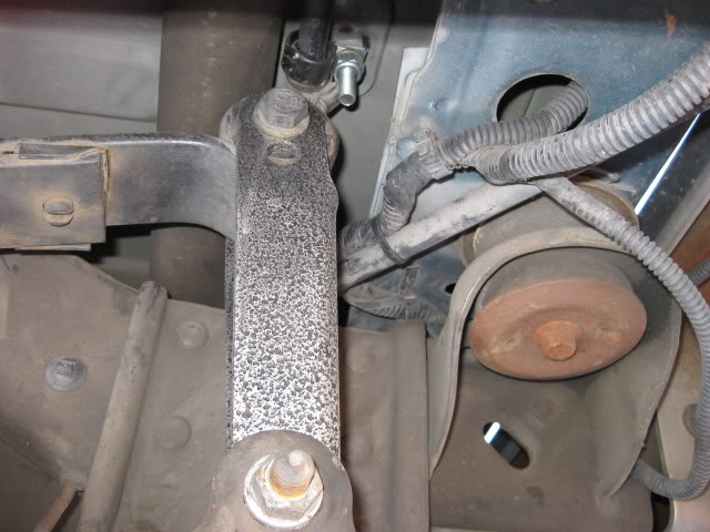

    I am using drop shackles on my 2 door tahoe. I've had them on since the beginning of the year and have had no issues.
    First, I unscrewed the stock bolt holding on the hook in the back cargo area and replaced it with a M10 x 65mm 1.5 pitch bolt. I then used one of these clamps
    http://www.fittingsandadapters.com/galsteelvind1.html
    and put it around the vent tube next to the filler hose. I tightened it up until it lifted the hose up enough to barely clear the shackle.
    Pics:
