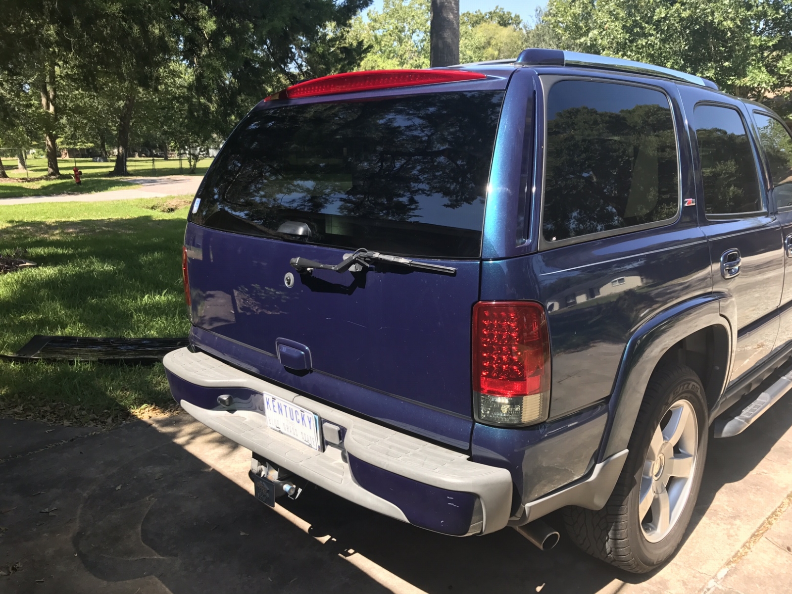

I pulled the trigger, bought a 2006 escalade back glass and third tail. I might have paid too much, but it was my exact color no painting required. $325 shipped to my door. So how is the swap? Is there anything to plug after removing the Tahoe third light?
Danzigman
Aug 2, 2011
744
34
Galveston, TX
Really, I didn't know they were that expensive. I have been loosely looking for one since I replaced the original Tahoe glass last year after the hinge delaminated from the glass. The aftermarket replacement, from an 06 rattles. This one has my Burmuda Blue paint so no trip to the paint shop. Hopefully the rattle will go away.
Will my stock lifts (shocks) be ok or does the third light add a bunch of weight?
adventurenali92
Feb 16, 2015
7,242
8,345
Big Bear Lake, ca
No your stock hatch supports will be fine. The esky base and light don't weigh much. The swap is really easy. Pull the c clips off the hinges and the whole glass comes right off and you can make the swap. Just have an extra set of arms available when you do the swap.
