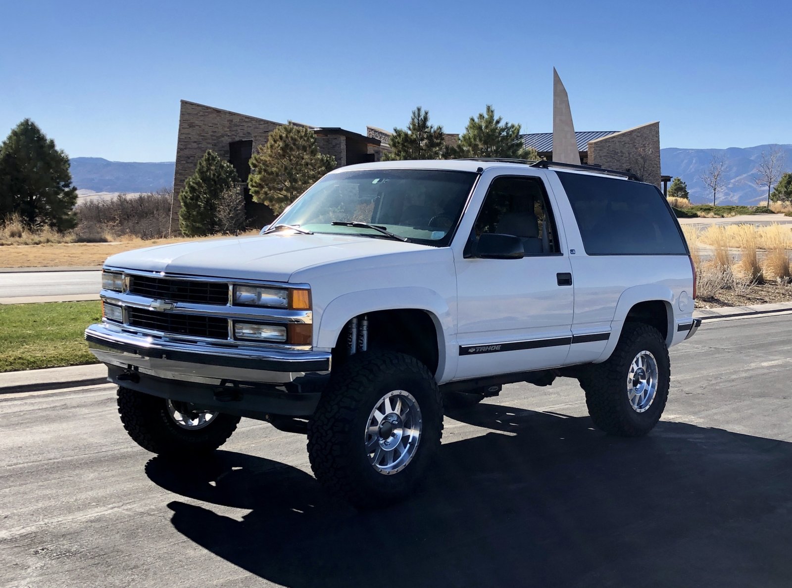

    Hey guys,
    I just finished lifting my 98 2 door with a BDS 6" lift. But because the 2 door Tahoe driveline is so short it's at a very steep angle. And it seems to cause vibration. What have you guys done to fix this?
    Thanks in advance!
    Mike

    i am just throwing this out as i had a minor vibration after doing u joints. another member told me to undo the shaft and spin it 180 degrees. Got it from another member here, but cant recall who. In short, that was all it took, no more vibration.
    Costs noting, so i would start there.

    As stated above, make sure everything is working is in good shape. Tapered blocks, shims...all things that my be needed to phase the U joints correctly. I now run a CV shaft from Tom Woods Custom. That and some 12* shims got me right on my 2 door
