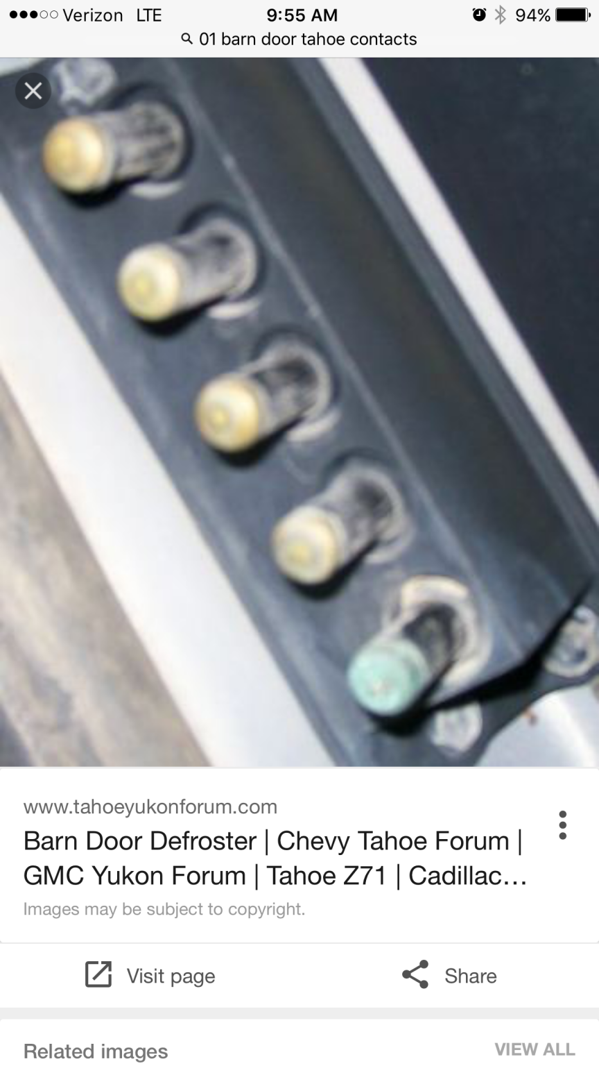

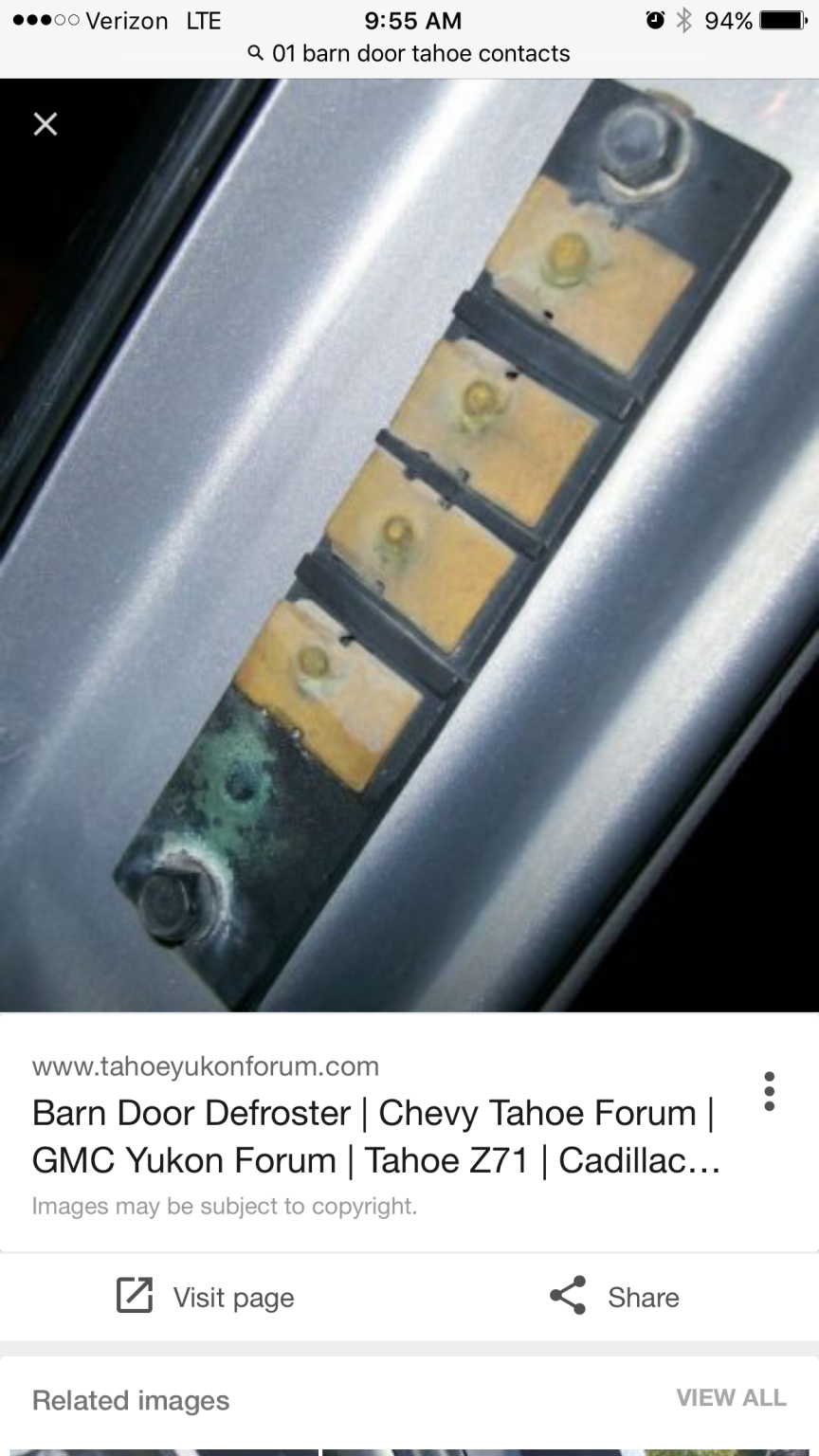

It's the rear maybe just some dirt on the connector?

ill check and clean but it does it alot and even when i shut the back hatch ill be driving and lights will come on and it will say rear access open...
I've heard others with this problem and it was the switch in the rear hatch. Probably needs to be replaced.

I just thought I'd suggest that because when I bought my 08 I swear the previous owners never opened the hatch...ever. There was so much dirt and road grime there you wouldn't believe it. LOL
