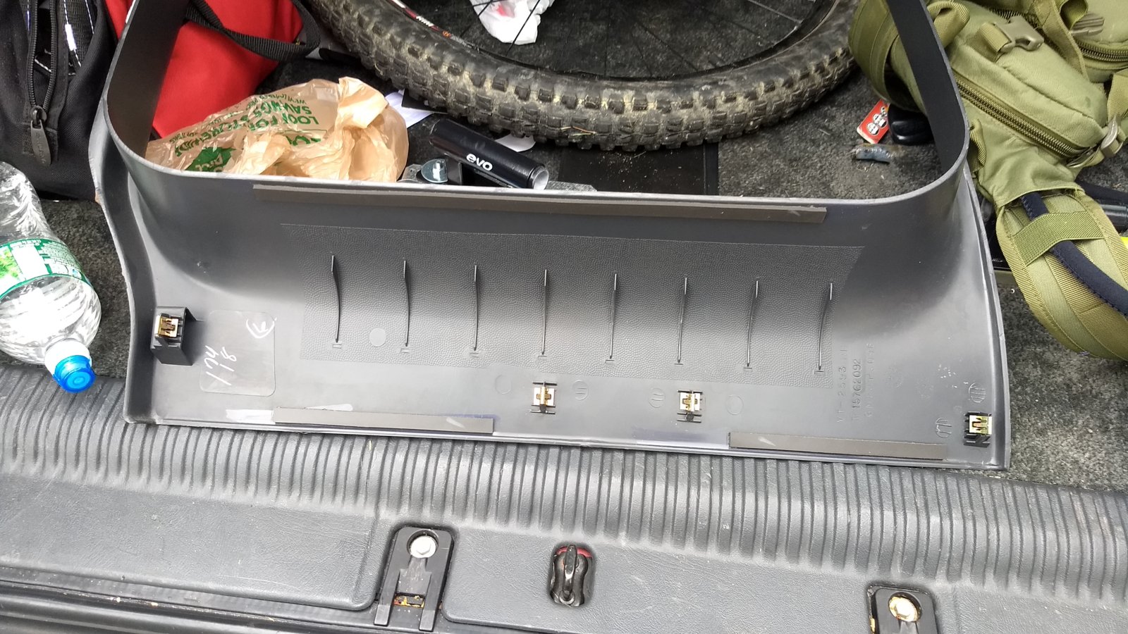

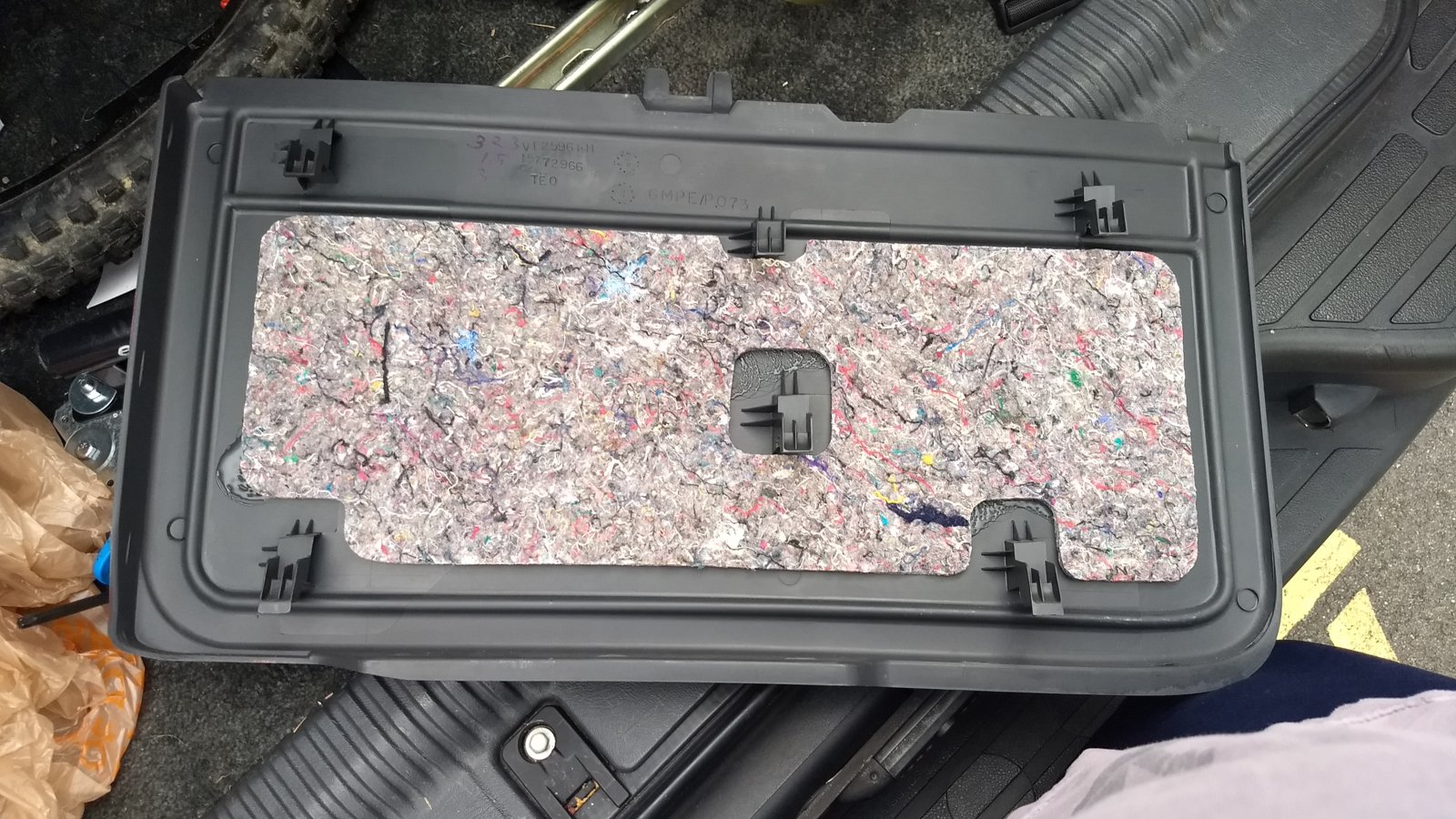

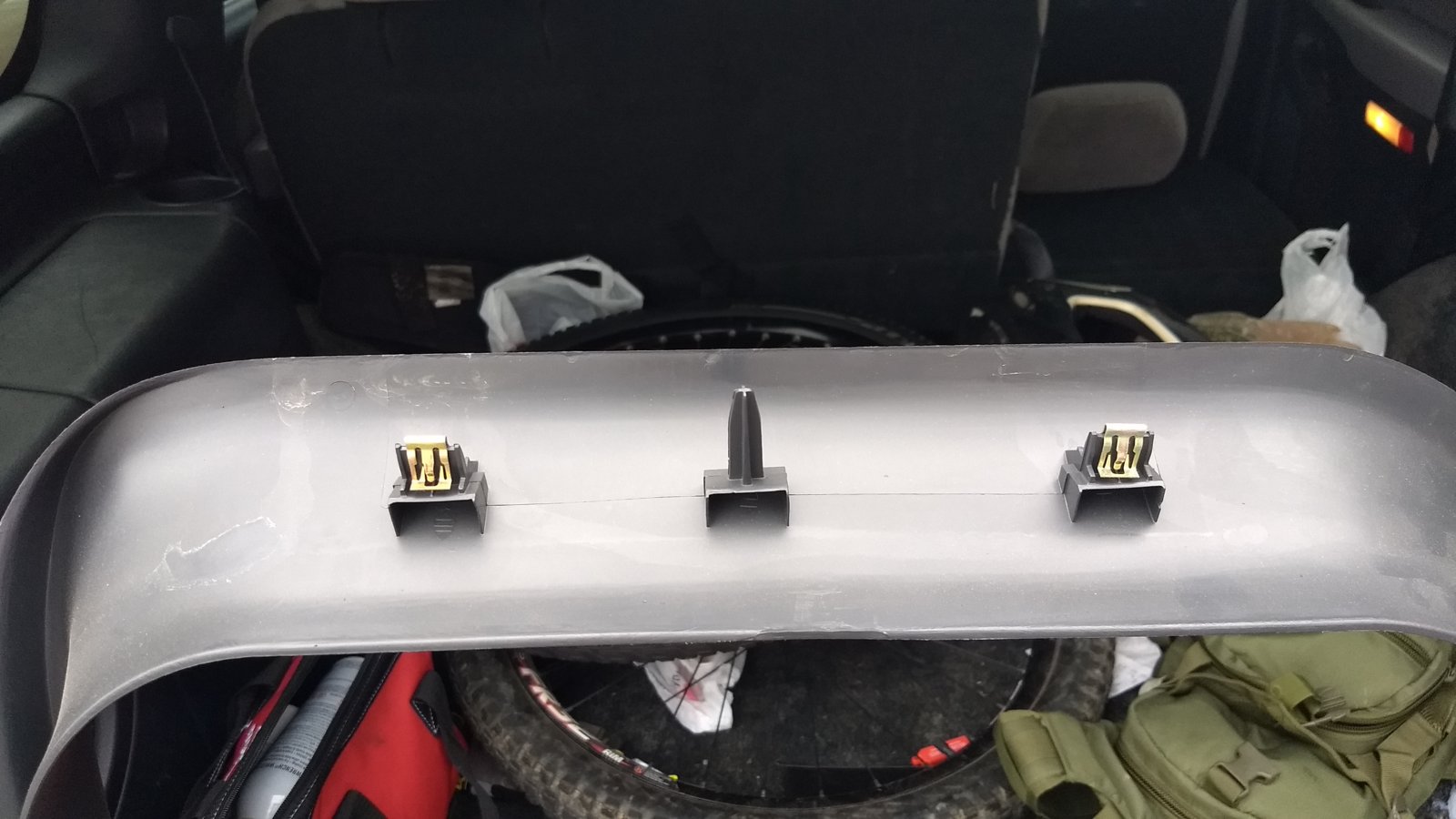

1 Taking the door panel off

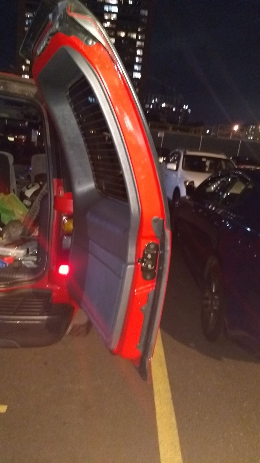

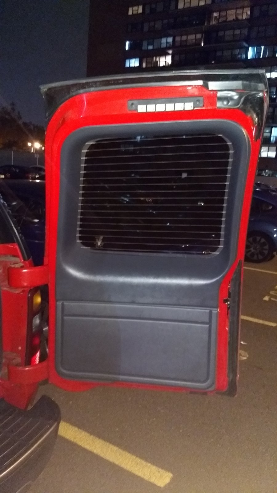

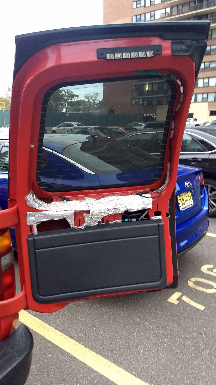

The door has two panels that need to be removed. You want to remove the top panel first working from the bottom of that panel (middle of the door) and working your way up. I posted some pics to give you a idea of how it clips in.
The bottom panal just simply lifts up.

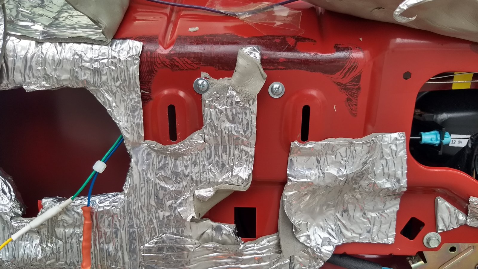

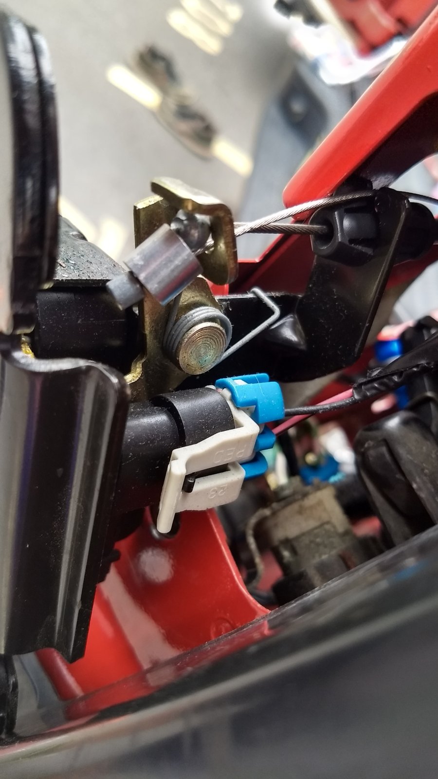

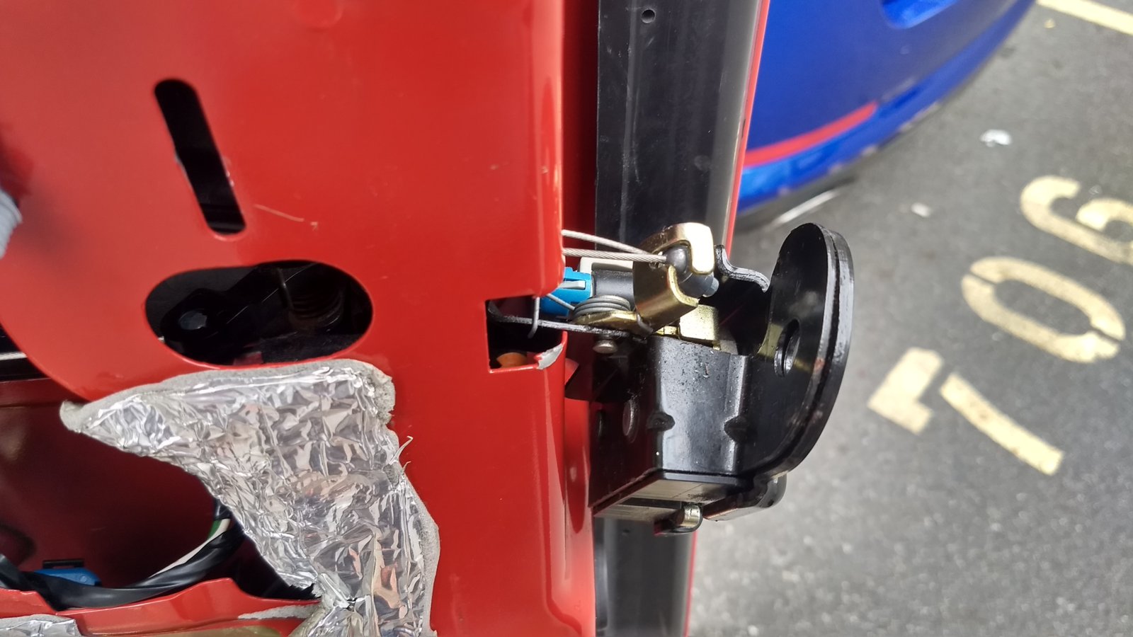

First you want to remove the two torq bolts off the locking mechanism on the Tahoe door.
Once you pull the locking mechanism from the door you will see a cable that connects to a lever. This is the lever that pops the door open. I ran the bike cable through the lever’s hole.

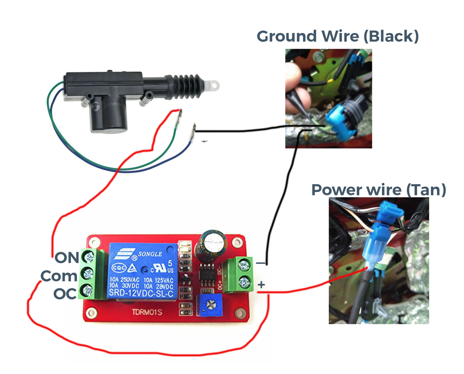

In order to have the door pop open after holding the unlock button for three seconds you need to install a timer relay. This is the one I used.
https://www.amazon.com/gp/product/B0126WT5QO/ref=oh_aui_detailpage_o00_s00?ie=UTF8&psc=1

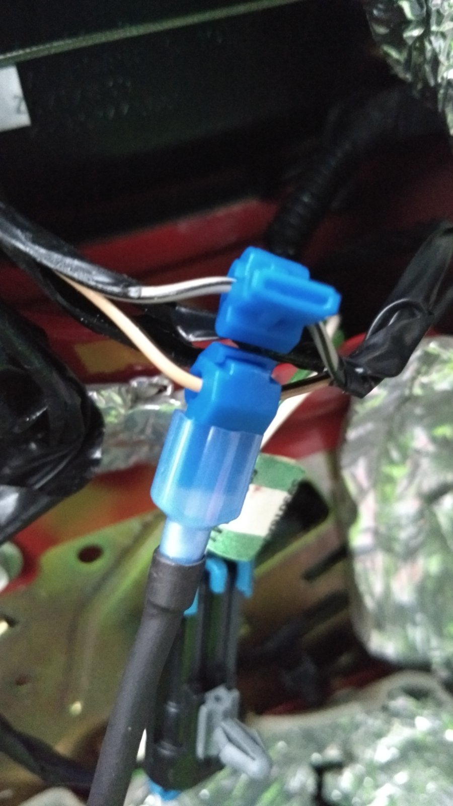

In order to power the relay and the door actuator I tapped the Tahoe unlock cable. Which is a tan wire.

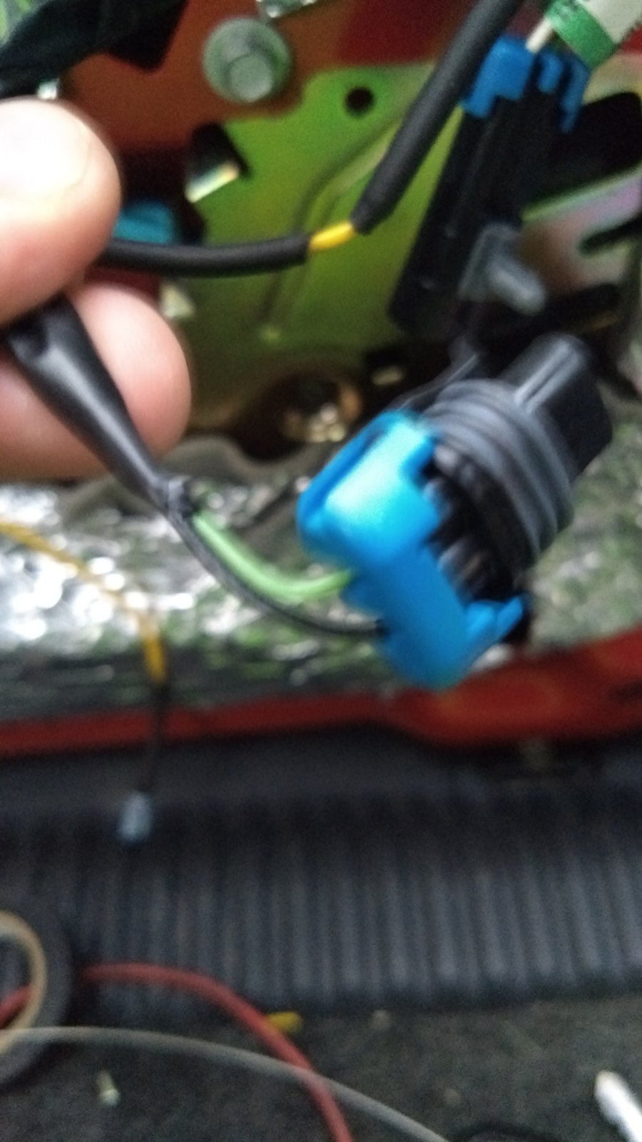

Next you have to ground the relay as well as the door actuator. Tap into the dome light cable for your ground. Normally I would connect the ground to a bolt, but I noticed all the bolts on the doors did not create a good enough ground. You will find a plug that has a black cable and a green cable. You want to tap into the black wire for your ground.
Finally here is the wire schematic in how I wired the relay. I also installed a 10amp fuse between the relay and door lock power wire.
After everything is wired up adjust the dial on the relay to how long you want to hold the unlock button for in order to trigger the relay. Thats it Hopefully this helps someone out or sparks another idea. Also the green wire is a constant 12 volt so if you just want to simply hook up a push button the the door and avoid the relay thing timer that should work as well.
