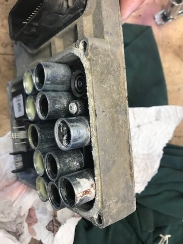

When I got the old ABS Control module off it had obvious water damage on the solenoid assemblies on the inside. The seal at the top had been leaking for a very long time and destroyed (shorted) the solenoids. I guess the DTC codes are pretty darn accurate LOL.

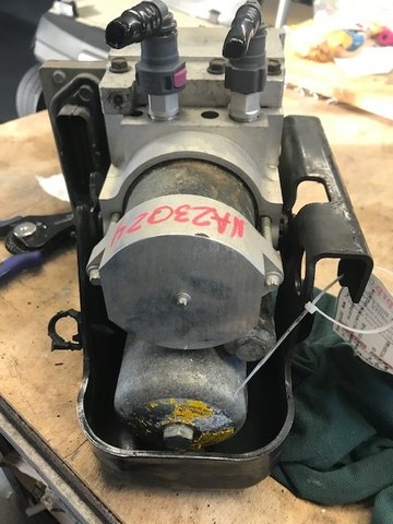

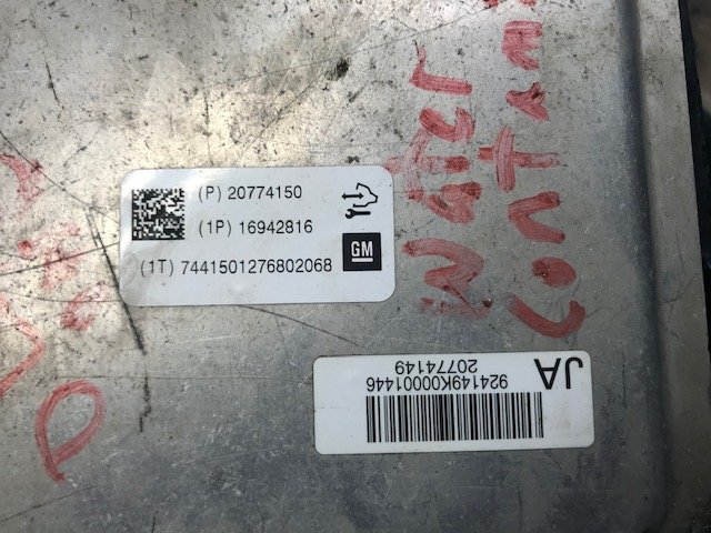

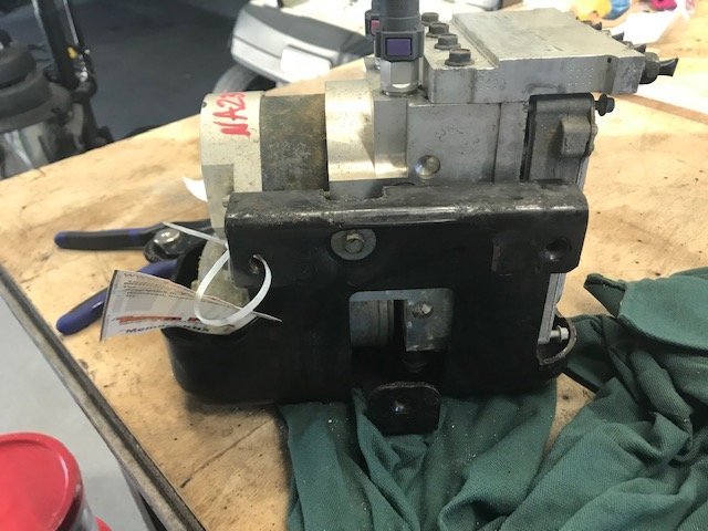

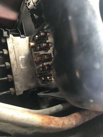

Got some pics here...........if you want more pics let me know and I will send them to you. I am going to keep the junkyard assembly for a while until I make sure everything is 100%.
Junkyard part tag interesting that is has the donor VIN on tag
Valve body on my Tahoe had to clean the top seal surface
Small hands can reach the bolts easily
Water Contaminated Old Part pulled off today 2-17-2020
Junkyard assy off a 2009 Tahoe Hybrid J92 RPO code part
Another view of the junkyard assy
Part numbers for the water contaminated pc that came off my 2009 Tahoe Hybrid
