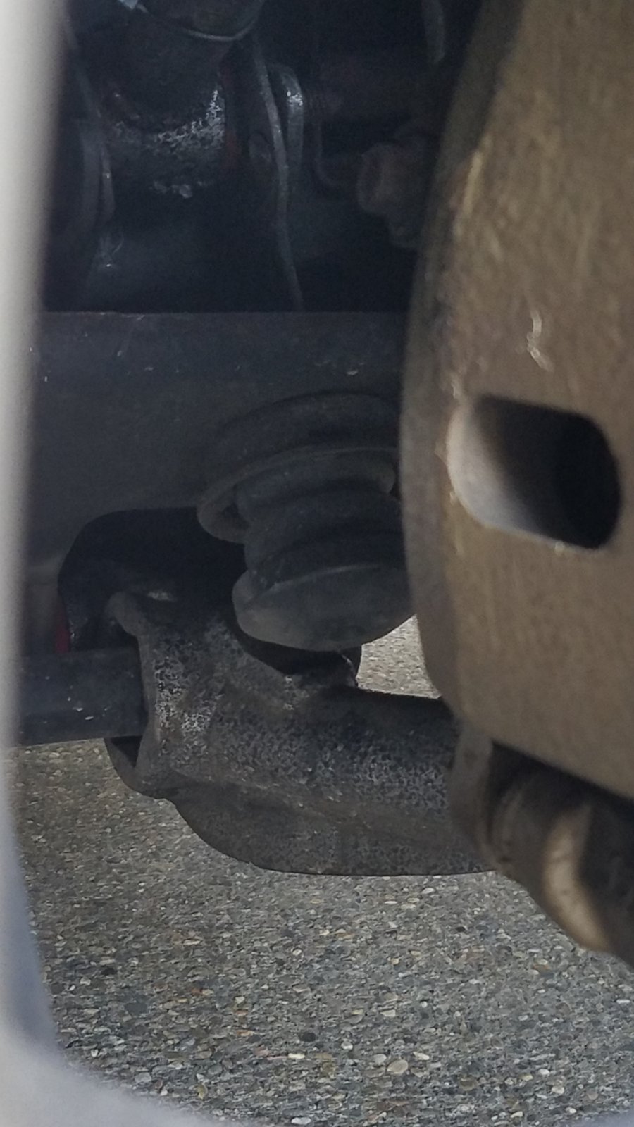

I just lowered my 05 Tahoe with Djm 3" lower control arms.Question is ,what jounce stops can I use?Any help would be great,I've searched but can't find my answer.
I remember thinking the same thing, that it wouldn't ride right without jounce stops because from everything that I know, they're an important part of the front suspension. I would contact DJM and talk to them. Maybe there's a way to retrofit jounce stops or they might have an explanation as to how the arms work without them. The answer of " just leave them out" wouldn't work for me. I'm interested to see what the resolution is; keep us posted.I asked him and he said don't run them.I thought these truck were designed to be ran with the jounce stoppers??After the install it drives weird,road walks..
No,he said do not use them.But I was asking if the design and how they use the jounce stops as an essential part is necessary with the djm lowersSo he said it needs jounce stops but there's no place for them?
@blurred is having alignment issues with his as we speak. http://www.tahoeyukonforum.com/threads/djm-lca-uca-alignment-issues.96507/#post-1152828Do these arms require special alignment settings? It seems to me they'd alter the suspension geometries enough to do so. Maybe more positive caster?
