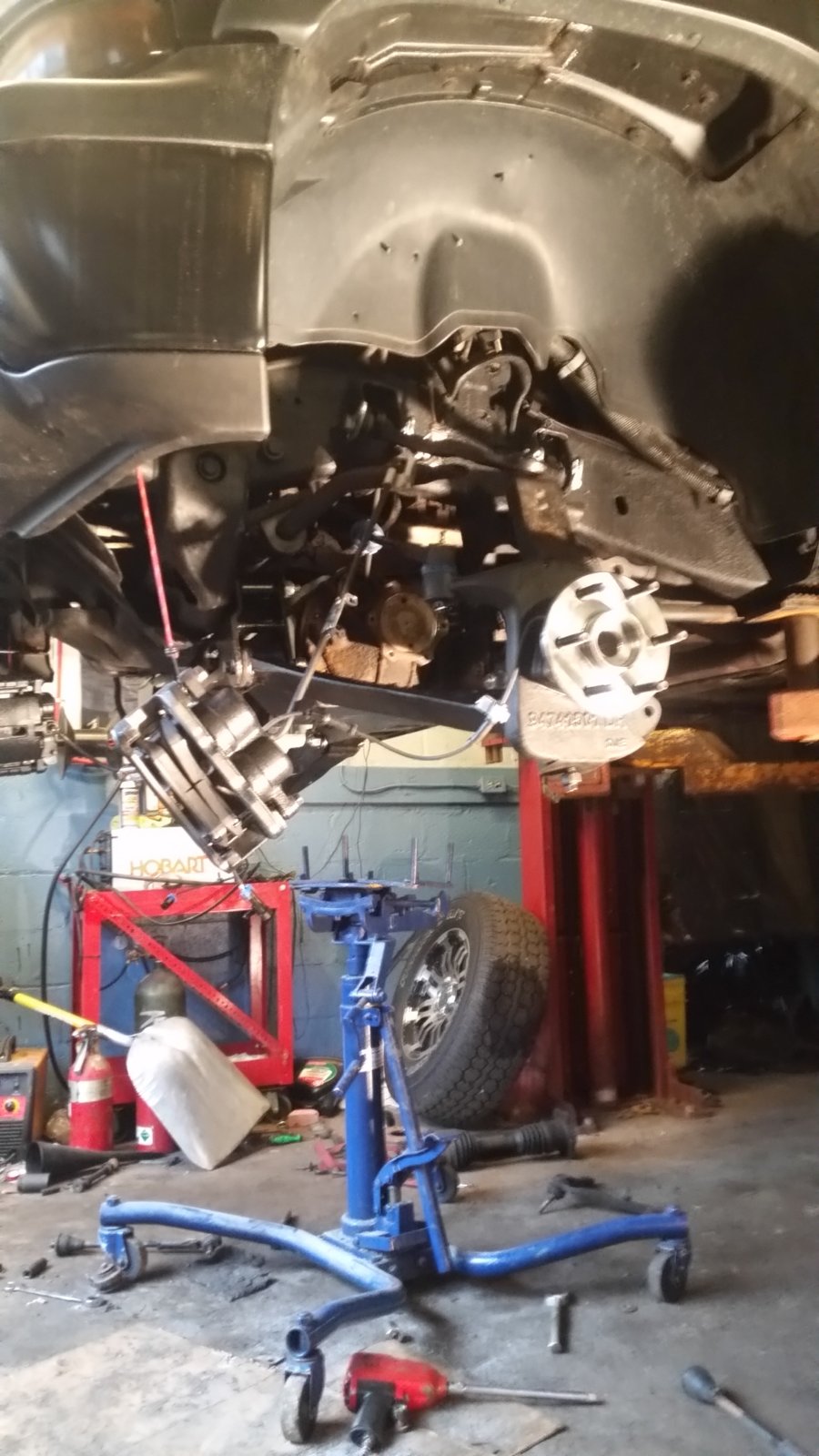

They do space out the axles as the name implies but they are not the cause for increased wheel track width. The front differential is lowered in a 6" lift; the upper control arm remains in the factory location and the lower control arm is dropped a few inches down. The difference in height from the upper and lower control arm is made up using a taller steering knuckle.
The above picture forces the steering knuckle out; increasing wheel track width. This in turn requires longer axles (which is done using these dinky plastic spacers that will leave you very skeptical lol)
