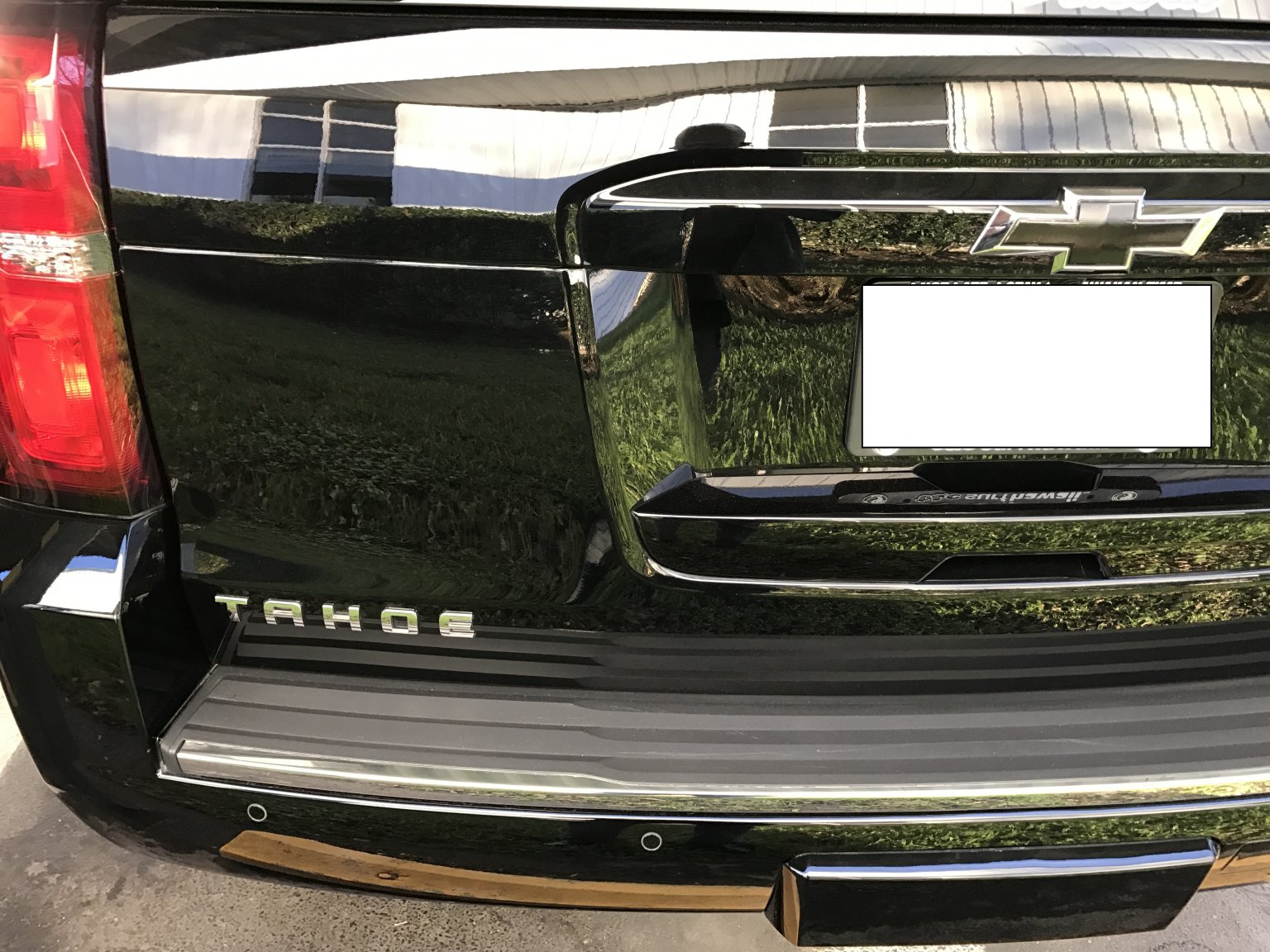

Nice job! Was it difficult debadging the LT? I'm thinking about debadging the LTZ and TAHOE (sides and rear), but am afraid of damaging the paint. I've seen videos on how it's done with a heat gun. I'm so tempted to do it.

its easy. did mine in about an hour and looks perfect. expect sore hands though. get fishing line, like 10b test, slide behind the badges lightly sawing back and forth until they come off. then rub with your fingers as much of the glue left behind off. then get goo-gone and a towel and rub some on. let stand a few minutes and just keep rubbing and will come off.

I used dental floss and wifey's hairdryer. Put some on it but move it around. Don't stay on one spot.

Yeah the debadging is simple. I used a hair dryer to heat up the letters then used fishing line to pry them off. Once you're done use the goo gone to remove the residue.

Yep, debading is super easy. I used my wife's hairdryer and went over the letters in a sweeping motion making sure not to keep in one spot too long to damage the paint. Then used dental floss to pry them off and finished up with some isopropyl rubbing alcohol to remove the remaining residue. If you don't plan on putting anything in it's spot (I actually replaced my chrome lettering with black lettering) you'll want to then make sure to clay bar the area and put a nice coat of wax back on there. Will look good as new and like it came straight from the factory. :)
