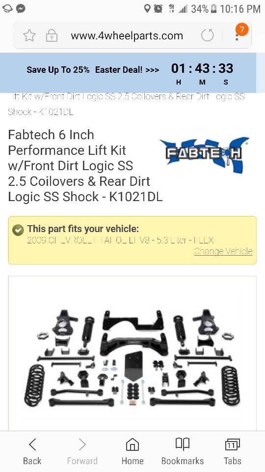

    Been eyeing this and want to know if anyone has it on their rig and what the thoughts on it are. [​IMG]

    Comfort and smooth ride like you are describing are not really what you'll get with stock spec coilovers of any brand. King, FOX, Icon, etc can all be adjusted to get you a softer ride. I have OEM Kings and the ride is better than stock to me but it is also firmer and more controlled. Contact a good off-road shop and they'll get you what you need (filthymotorsports).

    Not much for big lifts on here but yes coilover are the best. I got a 7” on mine. That kit is good but I prefer the bulletproof 6-8” with king coilover and pro comp rear drop brackets for a big lift. Also bds has a good kit with Fox coilover
