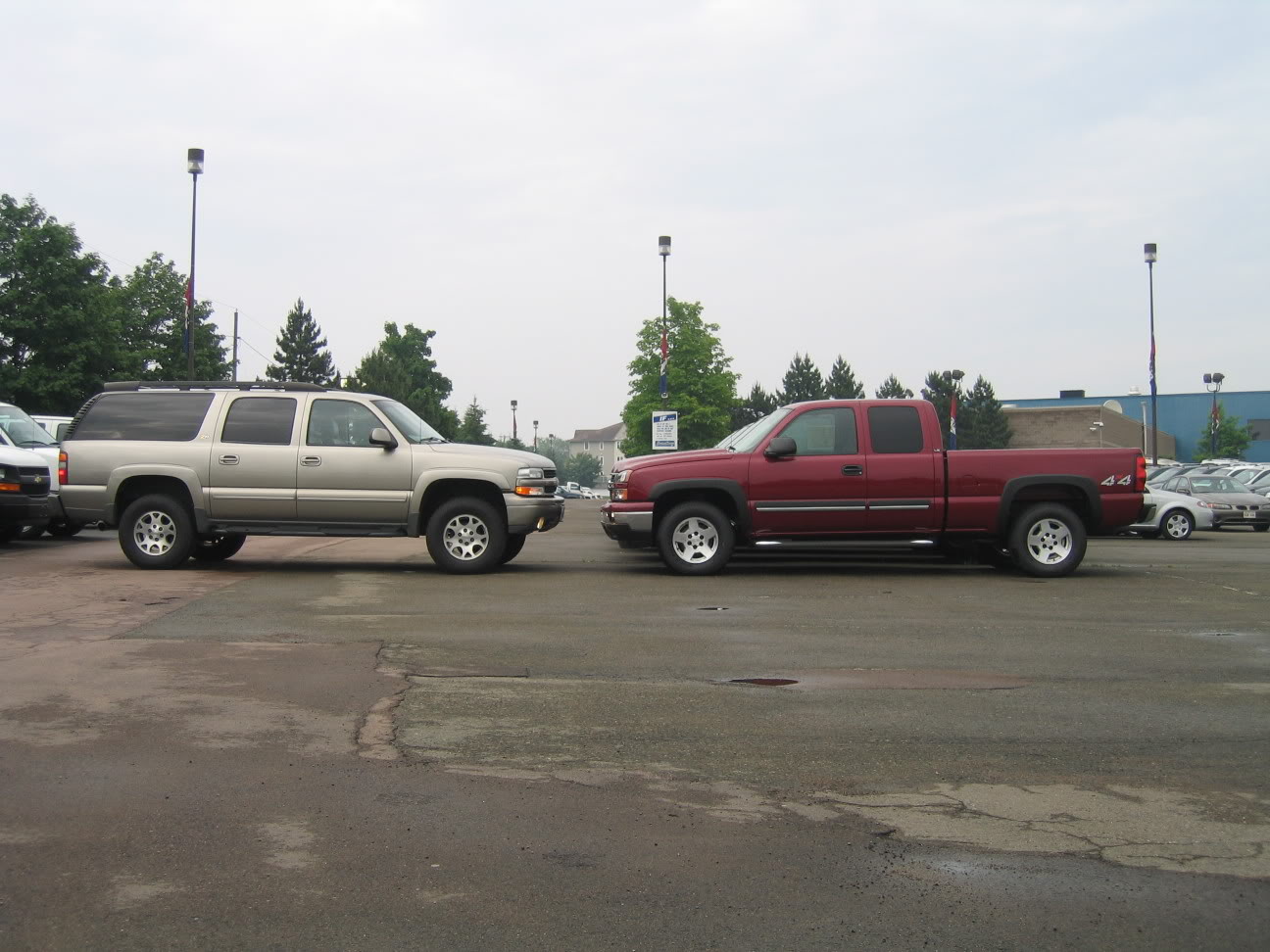

This is how tall I sit with the lift and tires (I am however a Z71, but shouldn't be much of a difference)
Me vs Stock LS 4wd Tahoe

Here's a pic of a Suburban with Keys and Spacers vs a stock Z71 Silverado
