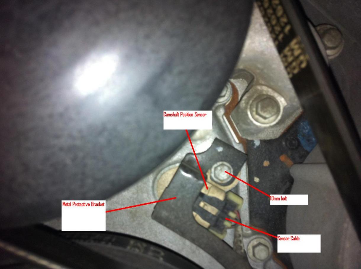

What up mod, you know i was looking in youtube http://www.youtube.com/watch?v=AKYjpa84m6Y, here is another one http://www.youtube.com/watch?v=m_uAnQFjTI4&feature=related and I found a bunch of videos on it. In one of the videos it actually says that there is no relearning, it's just disconnect and reconnect with the new one. All it is, it's just a sensor, here, this is what it looks like
