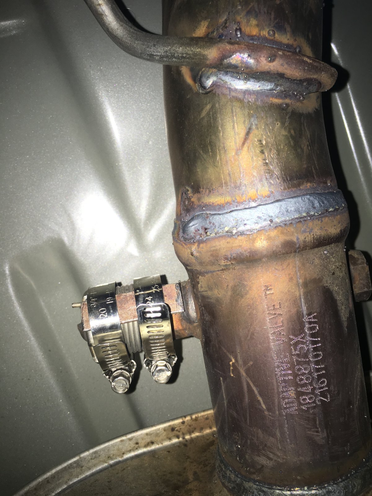

Twist the valve clock-wise and then clamp it. That makes sure the flapper is in line with the exhaust flow, rather than blocking it.
Clock-wise twist:
Counter clock-wise twist:

Thanks for posting pics. Does it sound better? I thought it was always open when the engine is running.
