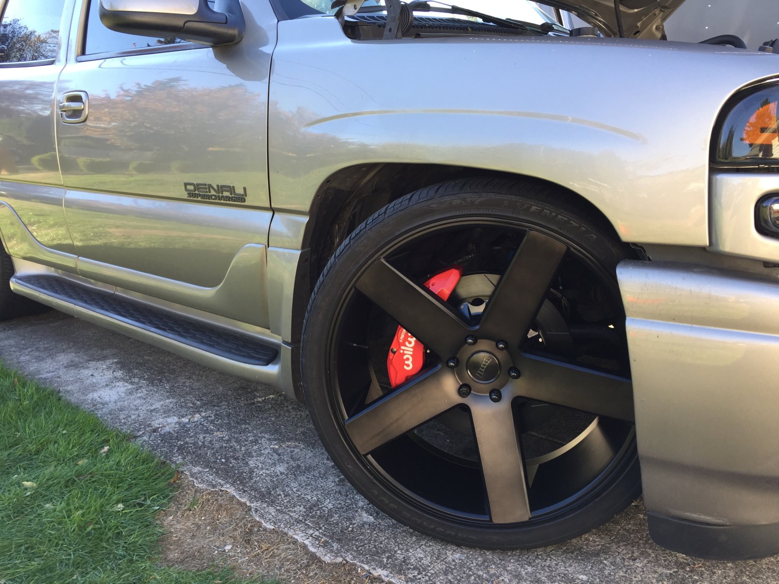

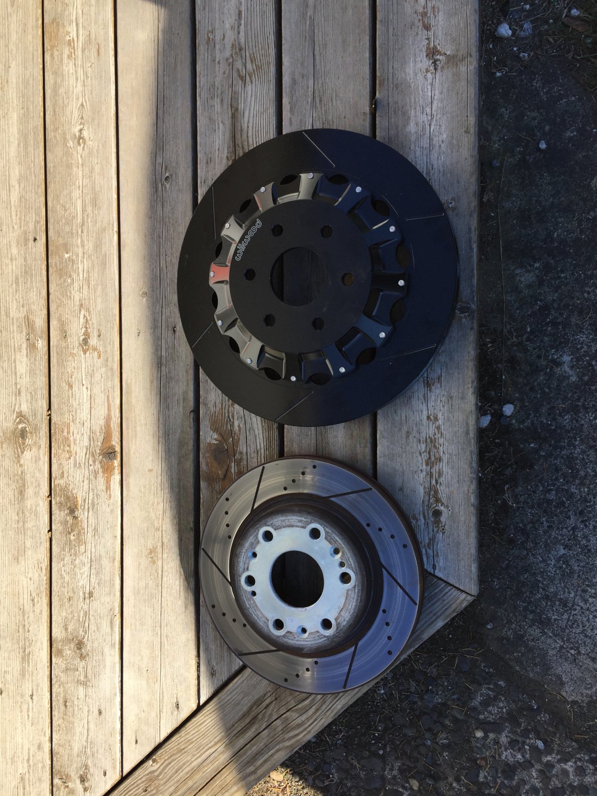

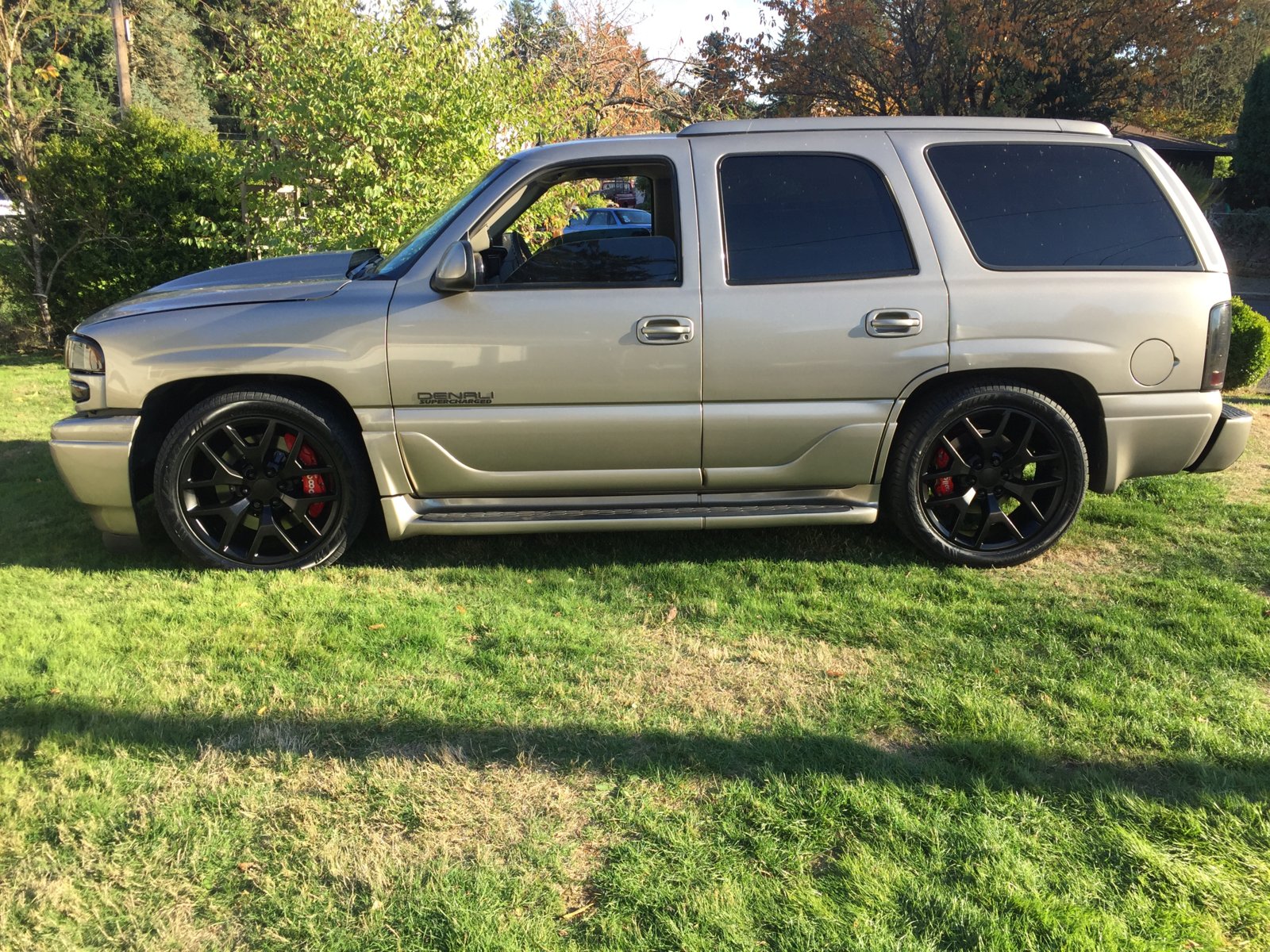

It all depends on what you consider to be "worth it". I recently installed Wilwoods 16" 6-piston fronts and 14" 4-piston rears. They stop my big old tank amazingly fast and there's no chatter or dust. Period. Absolutely the best brakes I've ever had. I've been on winding mountain roads in the summer and experienced bad fading with my OEM brakes. I've towed a trailer and felt like I couldn't stop fast enough. Our trucks are way too heavy for the brakes they come with, IMO. I figure if they give me peace of mind or prevent me from rear-ending someone they're worth it to me. But they're not for the faint of heart money-wise, at around $4000 for mine. Replacement pads will run me $600 IIRC but with the size of them, I don't expect to replace them for a long long time. Probably last 4 times as long as normal pads. So to me, yes they're worth it although it was hard to pony up that much cash. Plus they look damn good. One other thing to keep in mind is you need 20" minimum wheels, and you need to measure to be sure they'll fit around the calipers, the things are massive. IMG_7244.JPG IMG_7275.JPG IMG_7290.JPG

Thank you Mark. I realized the "worth it" comment was kind of subjective after making the post. However, I do appreciate all of the feedback from everyone. The price is definitely not for the faint of heart, you're correct. I also agree that anything that can potentially make our vehicles safer is usually a good modification to do. The hard part is the fact that I would lose my winter tire setup that I run for this time of year as they are a 17" set of steelies with Blizzaks on them. I guess I have some number crunching to do...
