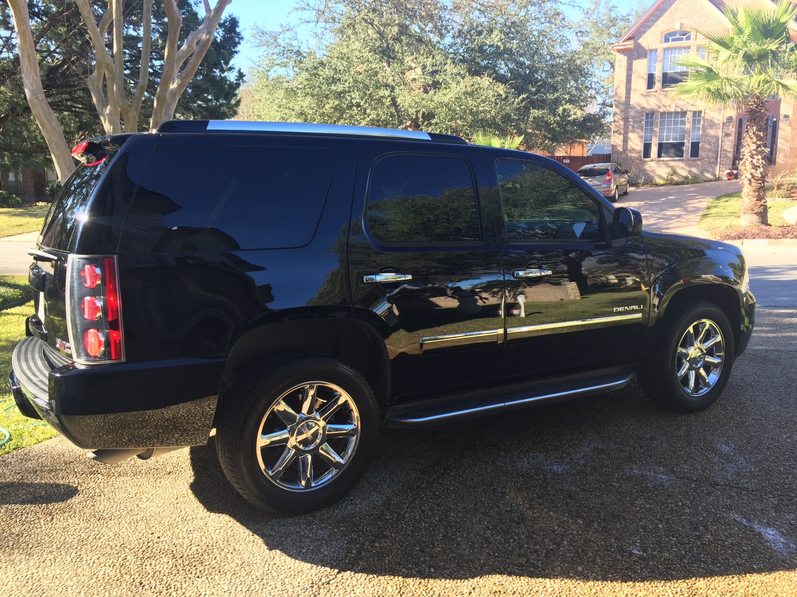

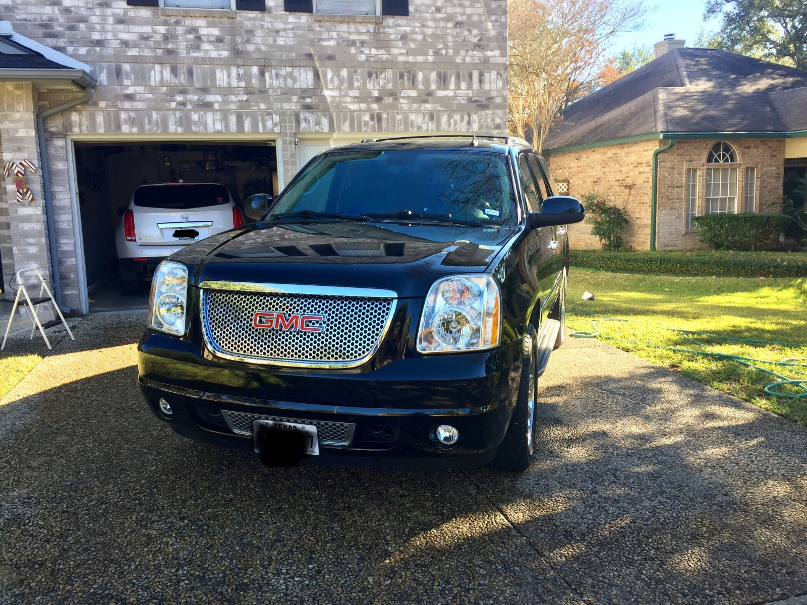

I've had my 2013 2wd yukon denali for just over a year now and i'm starting to want to do something to get a better ride from it. I don't want to lower it, just feel like everything's a little looser now and has a little more body roll than i remember when i first got it :) Any suggestions are appreciated. Thanks!!!

P.S. Is that a giant Crape Myrtle in your front yard? If so, incredible! Are you from DFW?

That is a 26 year old crape myrtle, it's huge and makes your vehicle look like it's a float in a parade if you leave it parked under it during the right time of the year. I'm in the San Antonio area. Just got back from visiting a friend in Dallas yesterday actually. Love that toll road!!!

is everything else stock on your vehicle, or is there other additions as well? Nice looking ride btw!
