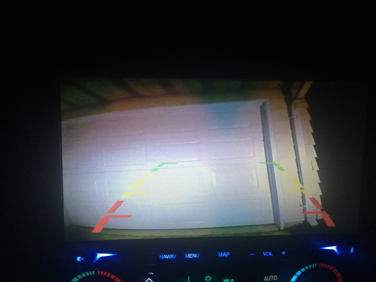

So I wanted to brag a little and show everyone that it could be done. I had my camera mounted below the lift gate on the back side of the plastic on top of the bumper. Though the camera was pretty well hidden I hated it, made it look like a widescreen movie when I put it in reverse. So, over the weekend I went to my local junkyard and picked up an extra window release button and was able to mount the camera inside of that button and still retain the functionality of it. It took a lot of patience and dremeling but I couldn't be more happy with it. Here are the pics of it completed. I wish I would have done a build on it but I can try to explain it the best that I can if anyone else is interested in tackling it themselves.

I went with the Esky EC170-06. It had really good reviews and a wide viewing range. I have been pretty happy with it and would recommend it to anyone. It even has the green, yellow and red lines for a distance indicator when backing.

And no that's the nice thing about it is if you dremel the housing enough it will fit right in there without removing the housing of the camera or anything

I have that same camera in my barn doors. Removed the lock cylinder and put the camera in. Great camera, on my 2nd one though. Had the first wired to acc power so I could switch to it anytime, it burned up in about 6 months. 2nd one on reverse only and it's been good for a year or so. Also put the same camera on my Acura, reverse only and been good for a year too.
Might want to try to angle the camera down a little, straight out I couldn't see my tow hitch, angled just a smidge and I can.
