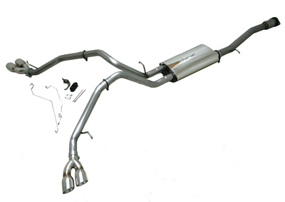

#2. Muffler: The easiest mod on the exhaust side is to replace your restrictive (un sexy sounding) stock muffler. Mufflers are relatively inexpensive and a shop can put one on for you in an hour or so. Depending on your selection, you will notice a dramatic sound in tone of your exhaust. This tone may be pleasing or obnoxious. I recommend spending some time on YouTube listening to different mufflers and listening to other trucks. Remember that the same muffler on a big block V8 will not sound the same as it does on a 4 cylinder Honda, so take the source into consideration, as well.
A twist on #2 is a “Cat Back” exhaust system. Here, instead of just doing the muffler, we are also swapping out the restrictive piping from the catalytic converter(s) to the exhaust tip. If you look at stock piping where it bends, it’s usually pinching at the turns. These pinches restrict air flow. If you have heard of the term, “mandrel bends”, this means that when the pipe turns, it does so gradually, without pinching, or changing the diameter of the tube. This maximizes air flow.
