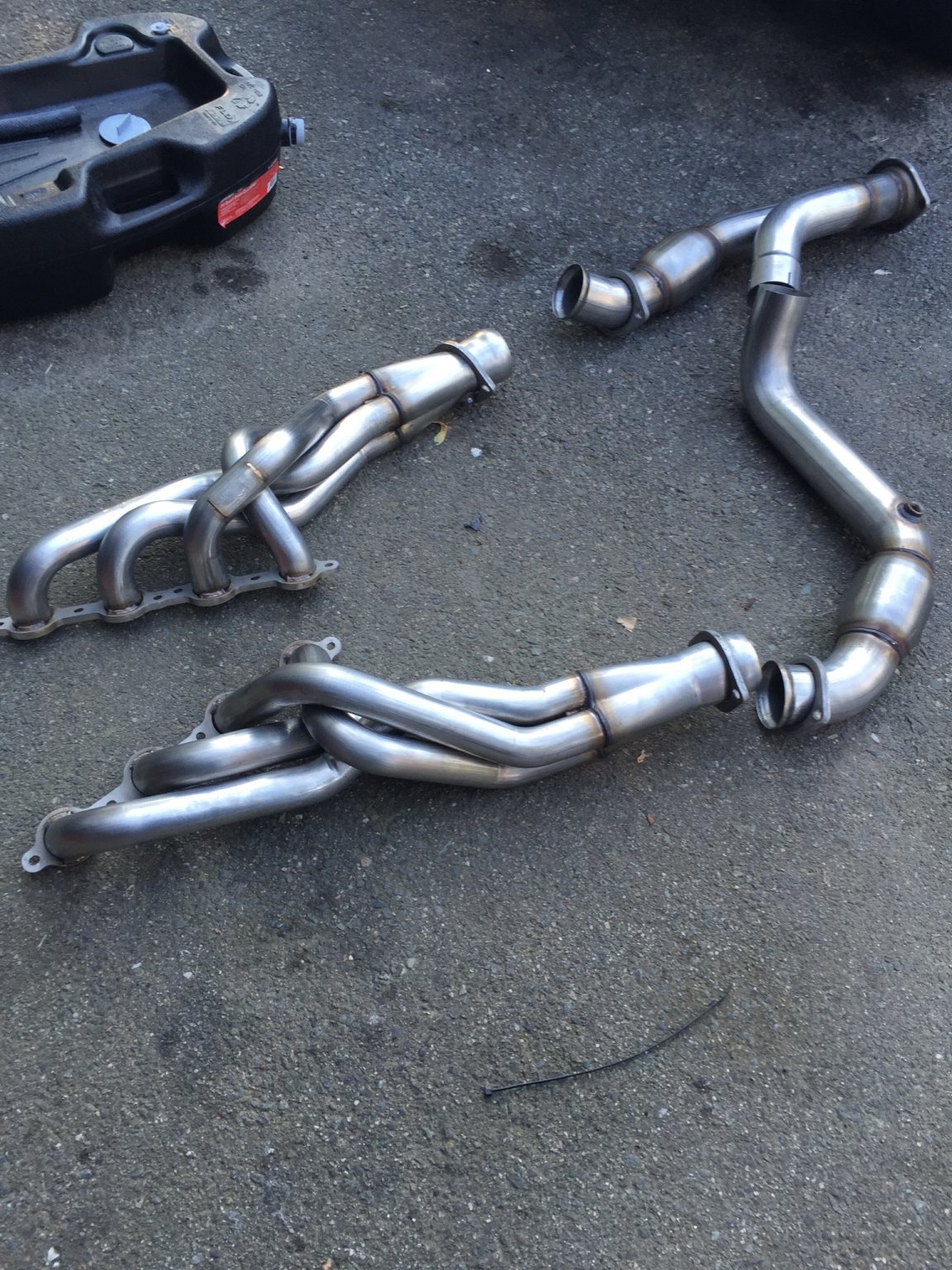

    just did this on my 16. I put on headers and catless y pipe for more flow. Ordered a blower today... you are gonna want one!

    Long tube headers are a must, especially if you're cammed. The ones from Speed Engineering are nice and are available with a Y-pipe, but they may need minor tweaking to bolt up to the rest of the factory exhaust. It's a hit-or-miss thing. Any decent shop should be able to adjust for any fitment issues. Their $350 price leaves plenty of room in the budget to account for the potential fitment labor. If you don't need cat converters in your area, these would be ideal since you're getting a custom tune and they can tune out the downstream O2 sensors. Long tubes on an LS engine are commonly reported to be a 20-40 HP upgrade. This will vary depending on other mods and tuning, both of which you will have addressed.
    https://www.speed-engineering.com/s...-1-3-4-longtube-headers-y-pipe-2007-2013.html

    Be prepared. You're probably gonna up the boost like I did. I got a 3.0 pulley I want to install but I'm going to replace my trans 1st.
    If you're going to do headers, I highly recommend American Racing headers. They are a beaut and made a big difference in my truck
