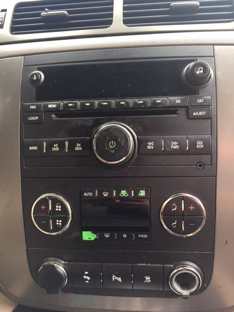

So if I do not have OnStar, Nav, Bluetooth, steering wheel controls, rear controls and not sure on amplified system or not, but pretty sure i dont have it, then i can get this wiring kit http://metraonline.com/part/LC-GMRC-LAN-01 along with the antenna adapter? Or is there another wiring kit i will need along with anything else to install an after market stereo?

Really wish someone would give some insight on the hybrid versions. I'm sure there's one insane person out there that upgraded their Hybrid..come out wherever whoever u are

I don't know and I can't find ANY info on differences, losses, and/or how tos on upgrading hybrid nav systems. Just a couple of don't do it because I heard someone say don't it.
