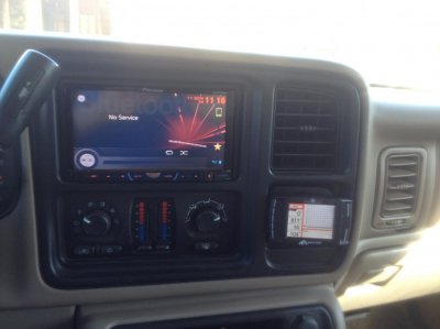

    My Tahoe is the base model and wanted the trans temp gauge too. I got a great deal on a BullyDog Gauge Tuner and use it to monitor the trans temp, among others.
